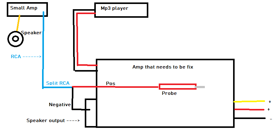

I should have explained myself better, my bad.
I got no audio on any op-amps using a Oscilloscope with input audio playing and amp powered.
I was using the probe in picture to trace audio from RCA with input audio playing and amp powered when i got audio from pin 4 and 8.
Using this cable I can trace audio path.
Please forgive my drawing.
My problem was the 0v measured across the two PS pins of the op-amp. Why don't you have that voltage if the power supply is producing rail voltage?
The regulators appear to start with the two large gray resistors on the RCA end of the amp. Read #23 on the Audio Troubleshooting page.
