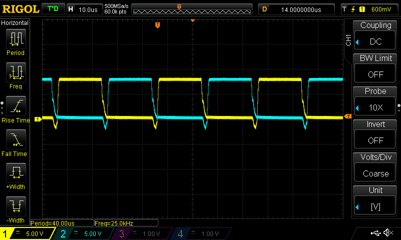

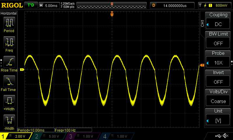

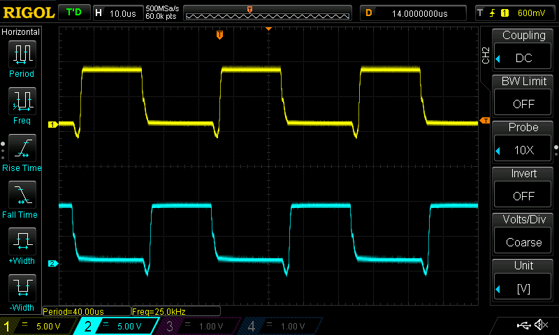

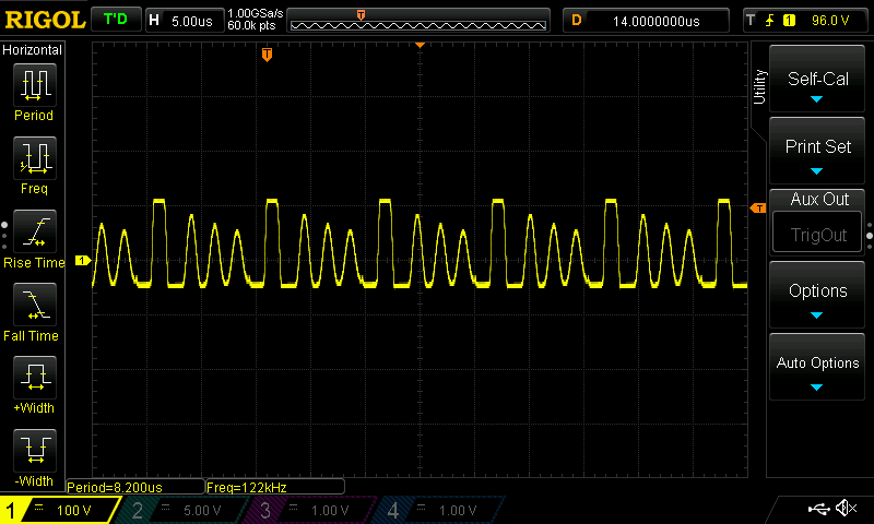

So, I have done some more testing this morning. I powered up the amp and took a look at the gate drive for the PS. Pictures are attached below. The first SS looks like there is nothing much unusual about the drive signal. So, I check the rails again and they are perfect, +/-60Vdc. I did not see anything out of the ordinary, so I started to think I may have misplaced my ground during testing. I began reassembling the amp and checked the PS after each set of transistors was clamped. No issues, rails were still symmetrical. Once I had it in the sink, I powered it up and was going to test under low power with a 6 ohm load.
I hooked up the driver and then thought to check the rails again. Well, the went asymmetrical again, positive up near 100Vdc, negative at -55Vdc. I checked the gate drive again while there was a load (2nd two pics below), the gate drive looks perfect even while this is happening. I double checked that my reference was common to the secondary ground, it is. I checked the AC output of both transformers at the outer terminals of each rectifier and they are all 56Vac, I'm having trouble wrapping my head around this. With the load removed the rails go back to normal over a few seconds time, again, PS gate drive pulse width does not change.
The last SS below shows the output of the amp. I was driving it with a function generator, .2Vp-p amplitude sine wave at 100Hz. I do not believe it should be offset so far, it's almost as if the high side is not the same amplitude, not merely just shifted downward. Also, with no speaker load hooked up the output of the amp looks like a sawtooth wave, I am guessing that is the result of the output filter not having the correct impedance present?
Thanks for taking the time to look it over.
Jason

I feel like an idiot, I thought you were saying that the power supply drive was irregular. You are talking about the output drive. That does make sense, I'll check the drive signal on the outputs today. Will I need to pull the rectifiers and use a 9v for high side as recommended earlier, or can I check it as is since it is powering up with no protect or abnormal current draw?
Sorry for being so dense on this one, I think I was looking at things the wrong way.
Thanks,
Jason

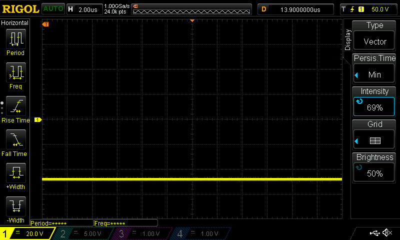

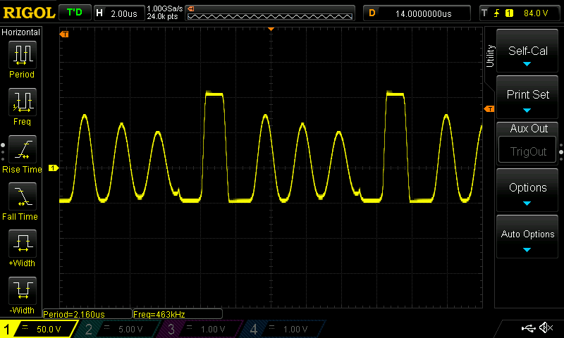

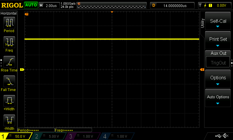

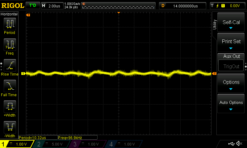

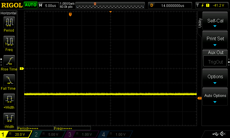

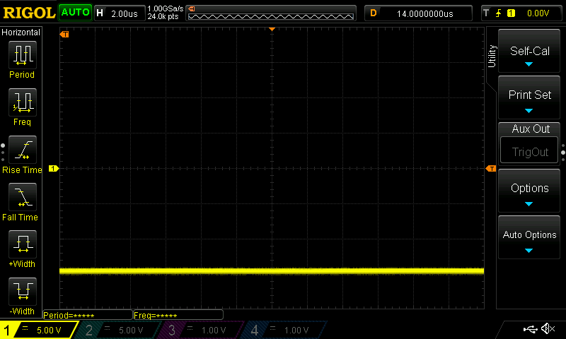

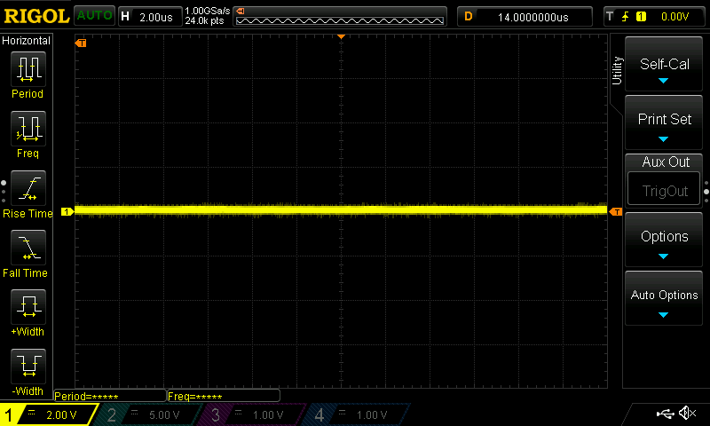

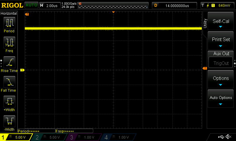

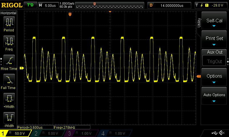

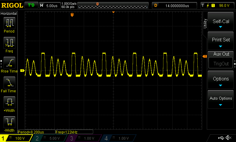

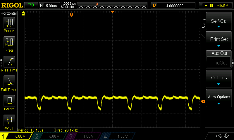

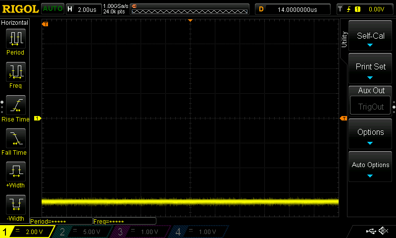

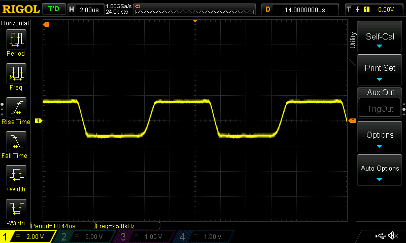

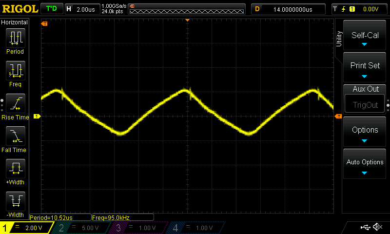

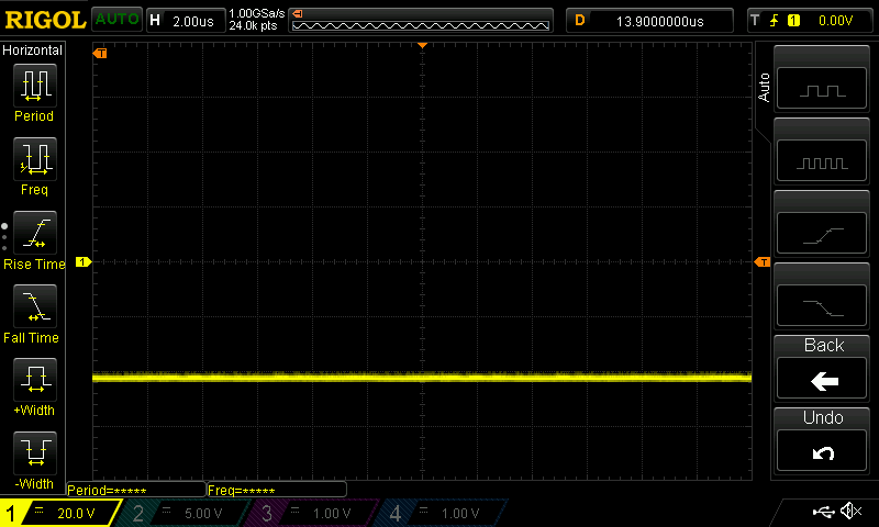

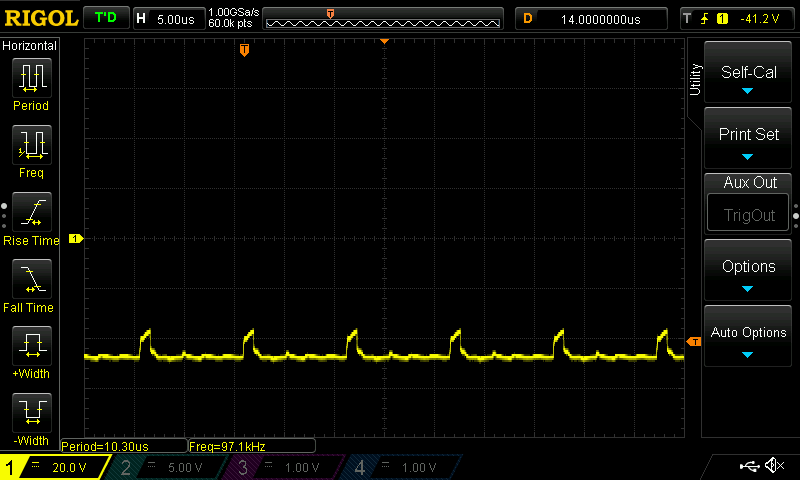

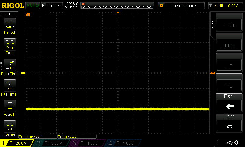

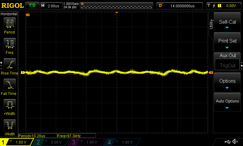

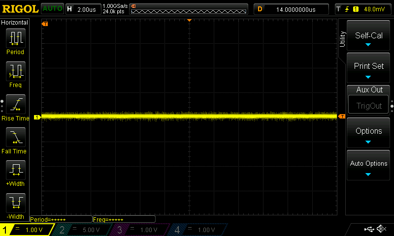

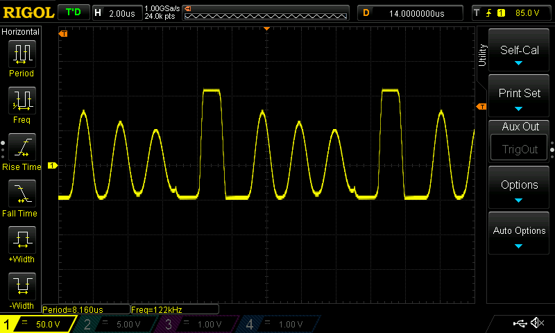

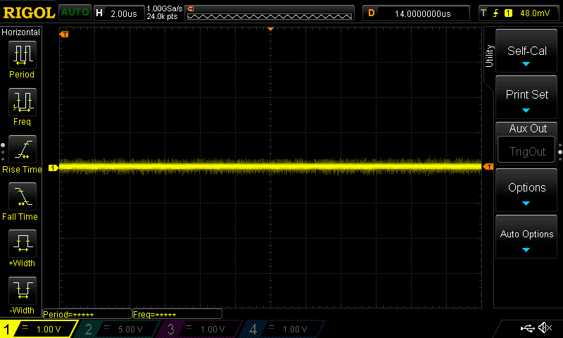

Ok, this is going to probably take a few posts due to the picture limit. The pictures are all named for where the waveforms were captured. For reference, I am calling the half bridge driver U1, the top TL072 U2 and the last TL072 U3.
Unfortunately the silkscreen designation is under the parts.
I tried to match the driver board waveforms to one of the larger ones I found in the tutorial, but things are not remotely similar, so either I have big problems, or this board is a fair bit different than it's larger brothers. I'm leaning toward it being "big problems"...
All waveforms were captured with the scope referenced to secondary ground. No input to the amp. All captures were with a 6ohm load connected. I got no drive pulse at all with no load on the amp.
Here are the output Fets first:

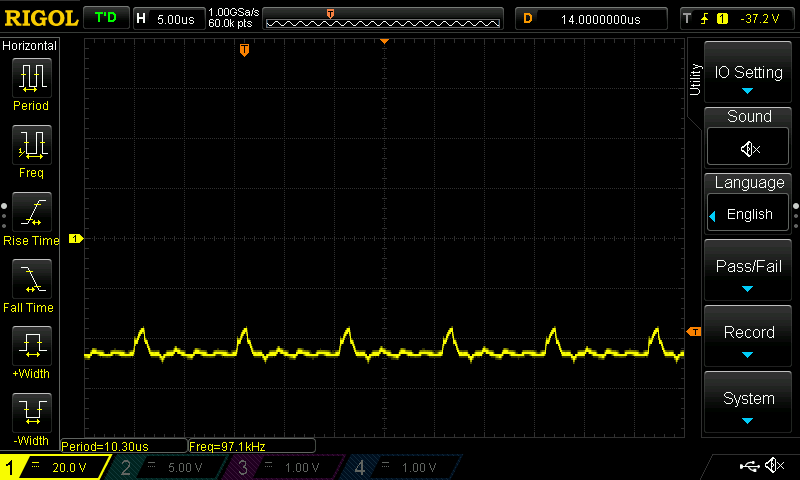

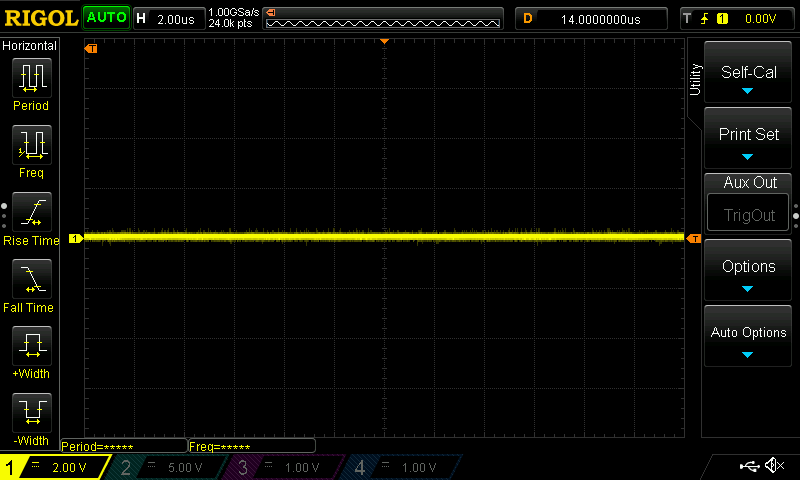

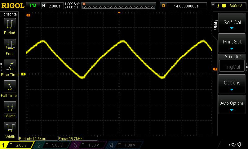

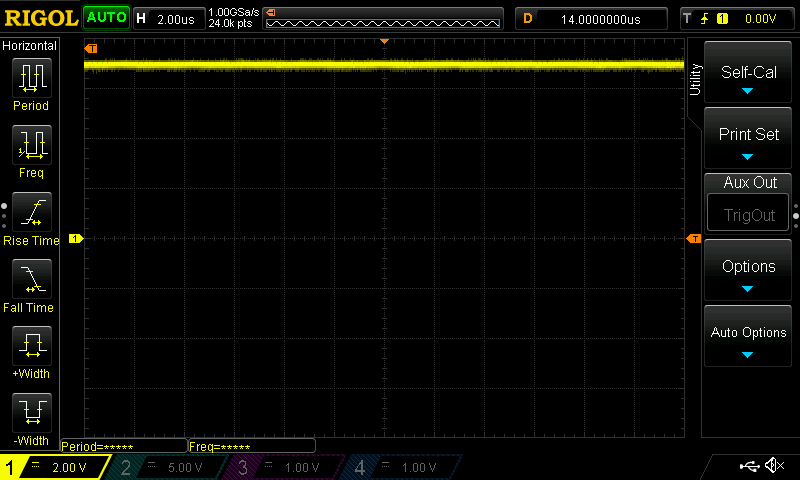

U2 (Top TL072):
It looks like this op-amp is only seeing +/-7Vdc rails, that can't be correct, can it?

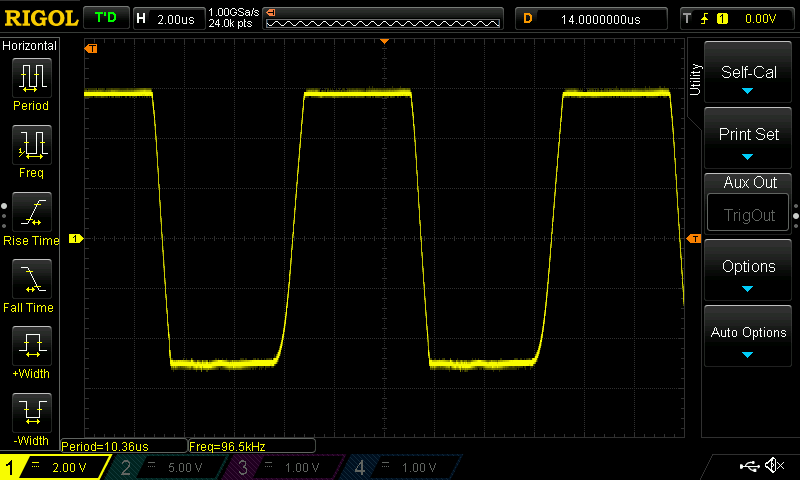

Quick update, I think it is fixed for real this time. Perry, when you said those driver ICs were sensitive, you meant it. This morning I removed all the ICs I replaced just to make sure the solder paste did not bridge anything under any of the chips. I was really grasping at straws. I cleaned the board again, reinstalled them and put it back in the amp. All the wave forms were the same except all of the sudden I lost all of the gate drive I had.
I checked the IC again per the previous instructions, and it was shorted. I removed it and put in the 3rd IC and voila! We have perfect square waves on the gates, with and without a load attached. I tested with the function generator and the distortion is gone. I will have to do burn in tomorrow, my back has had about all it can take for the day.
Thanks for the patience and for the assistance.
Jason

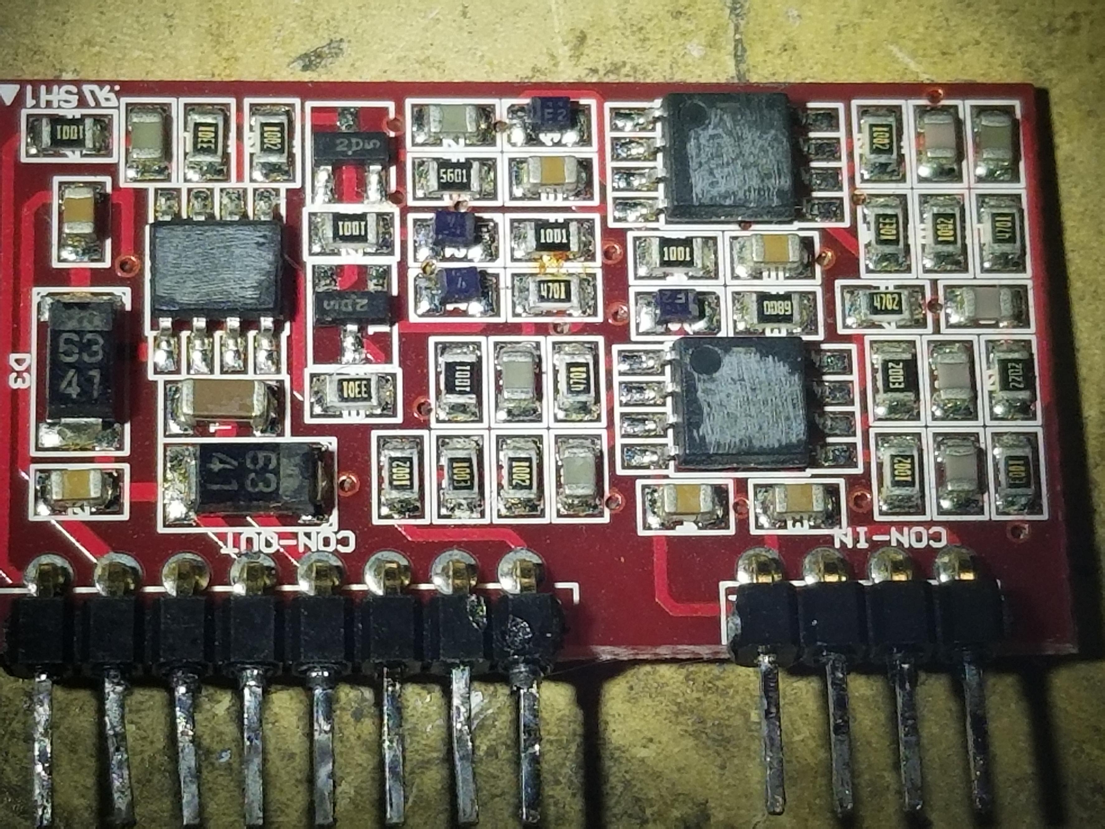

There is also a SMD diode missing from the driver board. The other one in the same package on the board is 639A, I searched high and low for that, and it looks like it might be a 18V zener transient surge suppressor. I would like confirmation if anyone has the info.
Thanks,
Jason
Just wanted to add a photo of the complete audio driver board for reference as I'm working on the same amp currently and the amp. The wierd thing about mine is it also had a shorted zenner going Into the driver board but when I sucked the solder out of the vias I found it was like they cut the leads and soldered into place or they just broke off inside the via which is a first for me.
