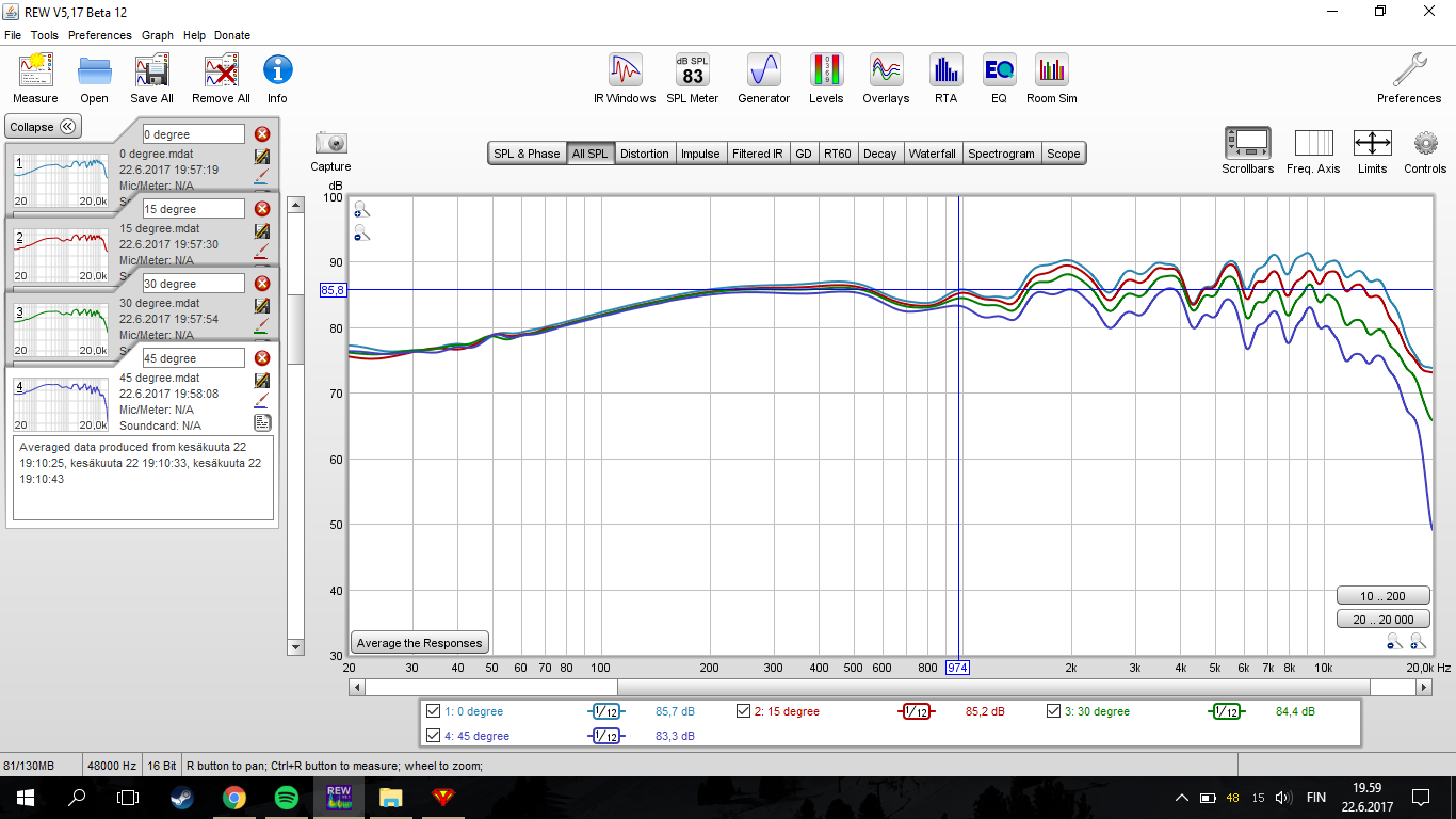

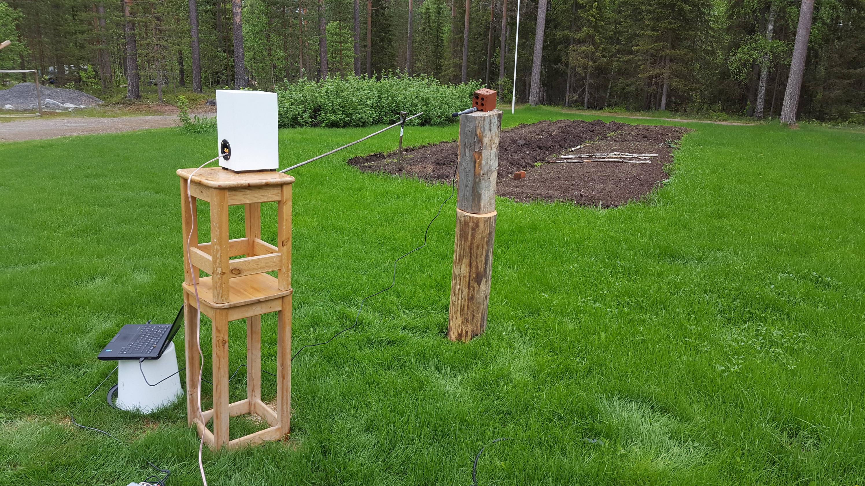

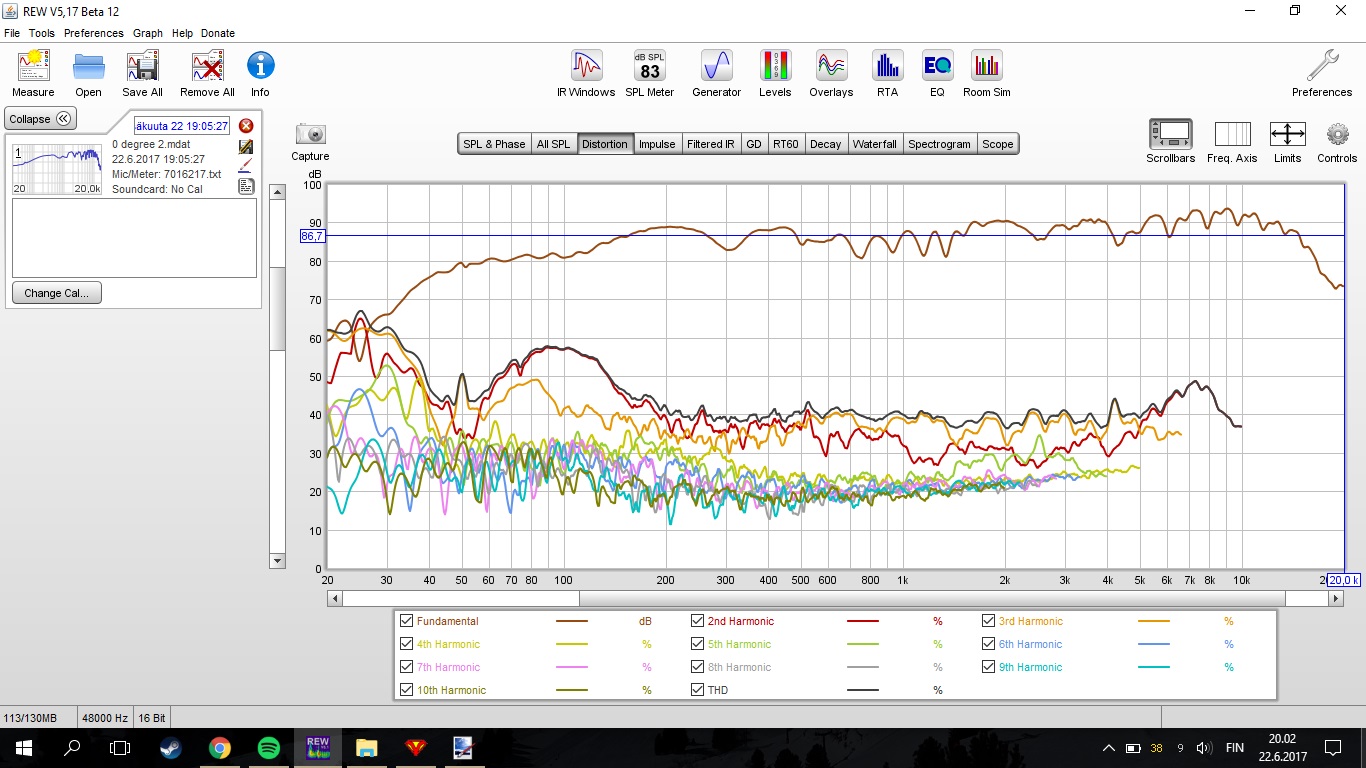

Finally back near my speakers again. Measured them outdoors in quite chilly conditions, +5 degrees. There was slight wind and birds singing in the background. My measurement rig is obviously very high-end as you can see from the pictures. Measurement point was between the drivers, 120cm from the ground at a distance of 1m. Measurements were gated at 4,4ms to eliminate ground bounce. Each measurement shown is an average of 3 measurements with 1/12 octave smoothing. The distortion is from the 0 degree measurements (straight ahead). Measured with REW and Umik-1.
Here are the measurements themselves (Onedrive link). I don't really know what's worth what in them. https://1drv.ms/u/s!AoJmX0yPPNWyrAwEUbXTghiI39-s
