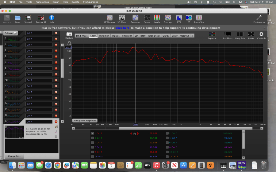

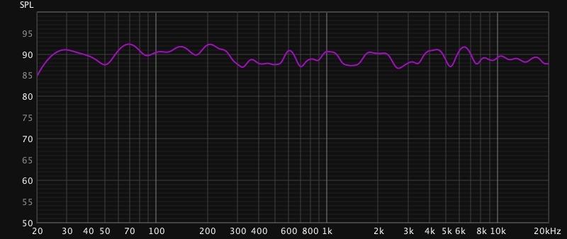

Coming back to this, I'm now using it to multi-amp the LaScala clones in my profile pic, with a pair of Alesis RA-150 bridged mono blocks driving JBL 2225H woofers, a 15WPC Glow Audio Amp Two on the mid horns, a pair of PRV Audio WG45-50 w/ PRV D2200PH drivers and a couple Schiit Audio Rekkr mono blocks on the tweeters, Machined Audio Horn Lens L-MAHL & B&C DE10 drivers with a combined sensitivity around 105dB. I'm quite happy with the functionality of the DSP-408, particularly the PEQ and time alignment, which have really allowed me to dial in the response of the speakers, from:
to +/- 3dB from 23Hz to 20kHz:

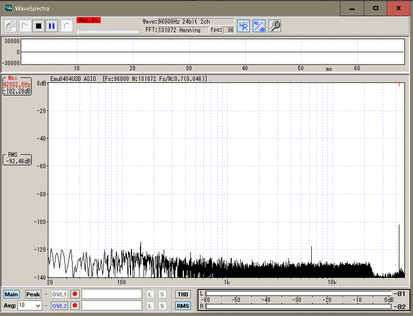

I guess the hum-noise might not coming from the mains. I also have DSP-408, here is the remaining noise spectrum.
This is the same measurement but the Wired Remote is connected
The frequency of hum-like-noise is different from the mains supply (my place is 50Hz)
This 158.9Hz-based noise was gone if I disconnected the remote unit.
You'd better disconnect the Remote Control Unit if you are using it.
