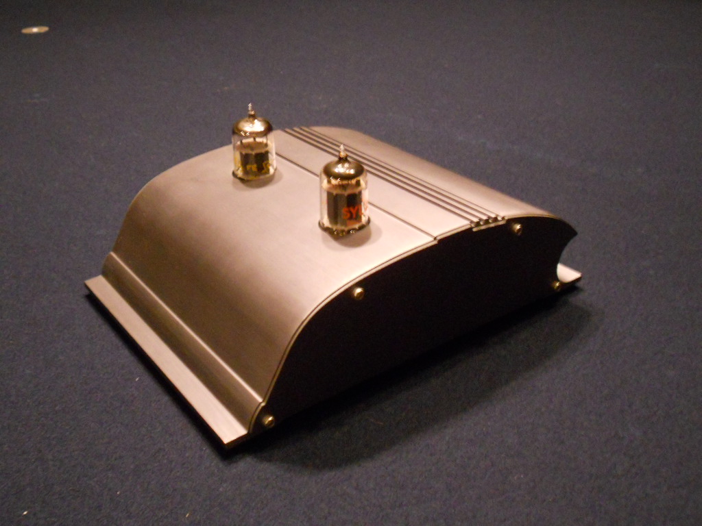

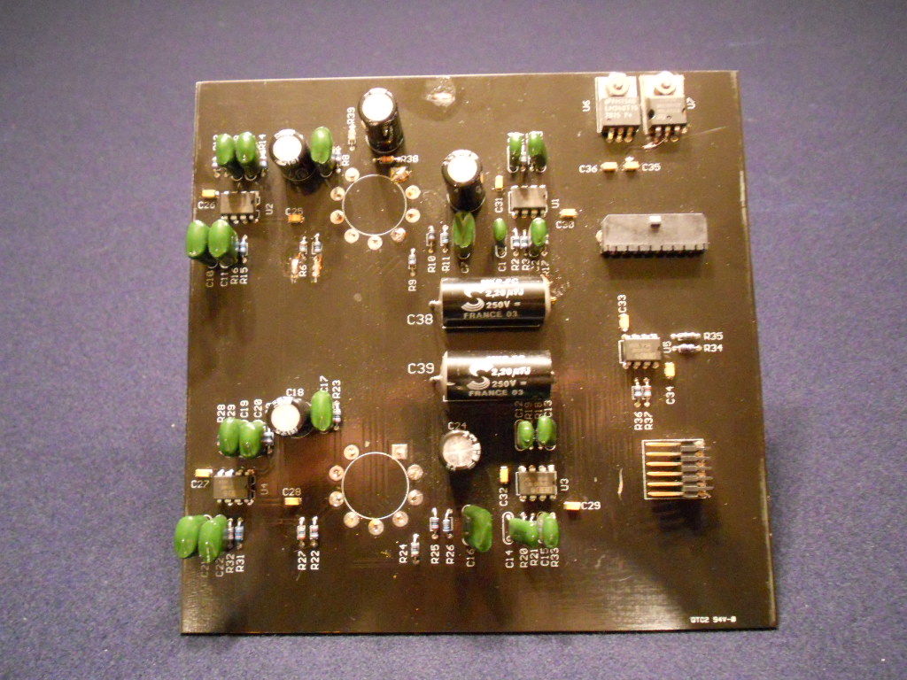

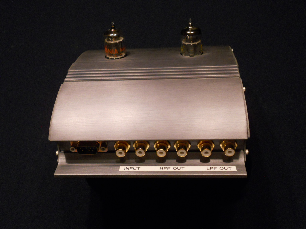

Like everyone else it seems, I decided to go hybrid and bi-amp with my own line level electronic crossover at 300 Hz. Did the filters with Burr Brown OP2604's; 4 pole Bessel response (0% overshoot, constant group delay). There is a slight dip at Fc (<2dB), but no ringing on transients. I needed a little more gain for the tube amp that runs the panels, so the HPF has a 12AU7 SRPP output stage, the LPF uses another BB2604. I put the amp section in a housing I used for a GPS device in a former business and put the power supply in its own extrusion.
  • BAMPFLT.pdf
  • Power Supply.pdf

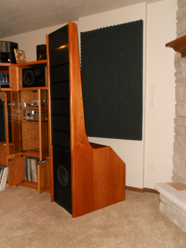

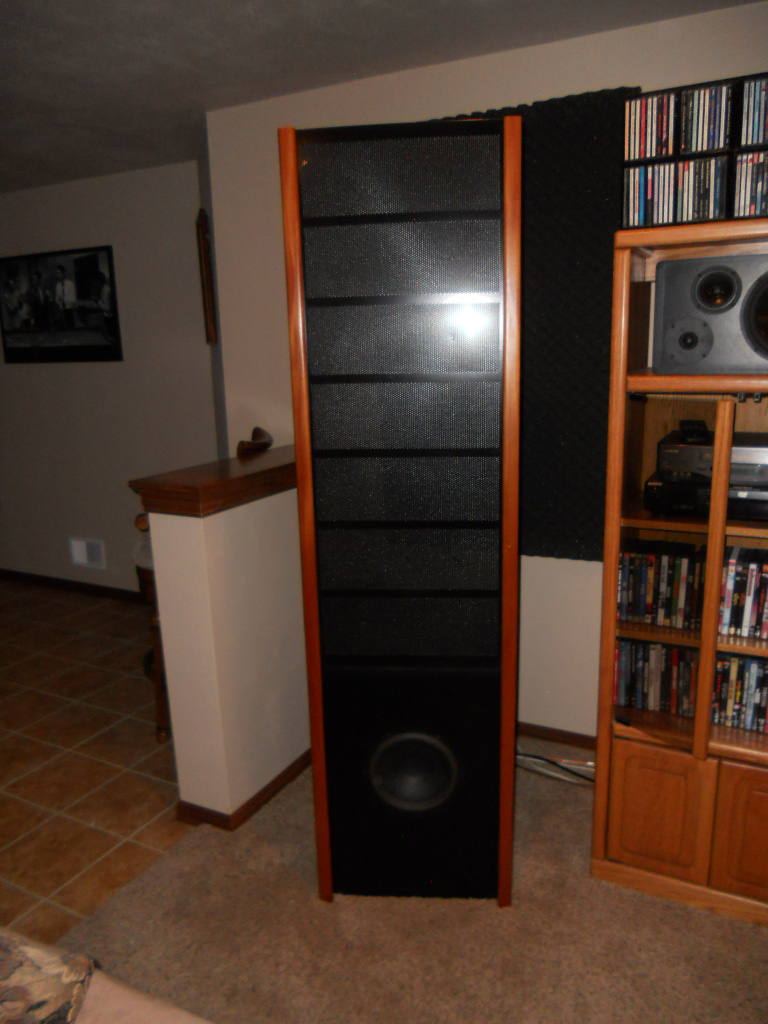

To share some info about my build experience:
I had the perf panels custom made by Diamond Perforated Metal Products in Visalia CA, and I believe they have facilities in Chicago, Seattle, Denver, LA and Houston as well. I had them perf the metal sheet (18" x 48") with seven 6" x 16" windows. That left a nice un-perferated frame around the windows and the perimeter of the sheet to attach the 3M VHB tape. They have a minimum order size, so people may have to combine their requirements to get to that minimum, otherwise you end up with a lot of excess metal (I had ~50 sheets made for $1K). They shipped on a skid by truck and were VERY flat. Metal was 18 gauge steel, 0.127" holes on 0.188" centers which yielded 41.38% open area.
I had the panels powder coated and attached the electical connectors AFTERWARD by scaping off a 1" square area and used 2-part silver epoxy to attach the flat flex circuits to the metal work. I created my own flex circuits by sandwiching a strip of 0.003" stainless sheet (available from Small Parts FL) between 2 pcs of kapton tape with each of the pcs cut shorter on the ends to expose the SS strip at each end. This makes a nice flat 3/4" wide flexible conductor that is insulated to >5KV. The third conductor (to the diaphram) was similiarly epoxied to a 16" x 3/4" SS strip and contacted the conductive surface of the diapharm between the 3M tape, similar to your copper ring, but only along the bottom edge. I coated one side of the diaphram with graphite after tensioning, but before attachment to the stator. I found that a lot of mechanical tensioning was needed and as a final step (and to remove all wrinkles) using the heat gun treatment. If I tried to tension them using only heat, I found the panels would "relax" over time and sag, causing arcing.
The bass drivers are Scanspeak 25W/8565 10" woofers mounted in a 6½ cuft (17" x 27" x 26") MDF box with 4" x 9.33" vent. The sides and supporting frames for the panels are 3/4" mahogany.

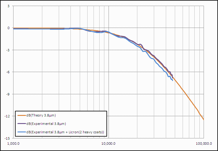

I measured the impact of adding two thick coats of Lycron on a 3.8µm diaphragm.
The added mass was equivalent to adding about 0.4µm to the thickness of the Mylar diaphragm.
Insignificant.
If interested, I had posted results for other diaphragm thicknesses here:
http://www.diyaudio.com/forums/plan...tatic-speakers-microphones-5.html#post3427260
