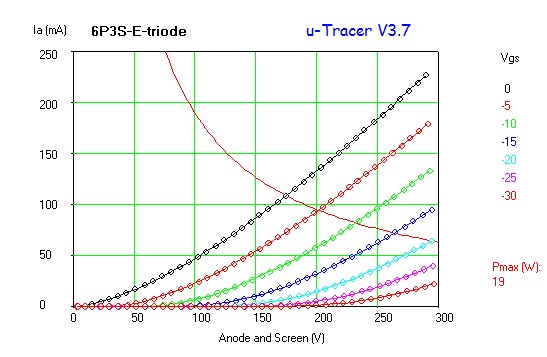

Because I can't read the datasheet, does anyone have the corresponding Vademecum sheet with a proper triode-connected curve?
I am running the 6P3S in triode mode push pull at 340 volt Vb and a cathode bias (resistor of 470 ohm) at 30 volt.
Wa = 20 watt. Filament is 6.3v ac. From decrypting the datasheet shown earlier in the topic, there is only mention of 250 V.
I had the amplifier running at a lower Vb of 320 volt for a few years; the tubes really kept well all that time. So above 250 v is possible on the long run. :confused:
Because I can't read the datasheet, does anyone have the corresponding Vademecum sheet with a proper curve?
Thanks rotaspec.
So I am maybe underrating the tube in mA (35 mA) and overrating it in voltage. I recalculated the Wa, it is 10 watt. So nothing to worry about in my opinion.
In class AB it can be higher.
The second grid sees more than in the specsheet for pentode use, but there is no triode data in this sheet.
For other pentodes, like 5881, triode operating data is given. The 5881 allows the screen of the triode strapped tube to be operated above the normal operating voltage of the anode (400V). Looking at the triode 5881 sheet, the triode operating point in class AB1, push-pull, like I have of 310Va, -30Vg, 33 mA, is exactly found here. I can surely go a little bit higher I guess.

Initial testing was done with 6P3S tubes instead, as I didn't want to risk my NOS Mullard EL34s. Bias was set to give 40mA cathode current, and the B+ settled at 430v, giving 420v across the tubes, and similar on the G2.
Close to 18W dissipation and they were quite happy, so your figures are conservative by comparison.
I ran the amp like that for several hours with no adverse effect on the tubes (no red plates even in the dark).
My experience with Russian 6P3S tubes so far indicates that the later production ones, and also the 6P3S-E will operate above their data sheet ratings with ease. The earlier ST-shaped bottle ones (and the Chinese clones) are not so forgiving.
Here's a triode trace I did:
Gary
