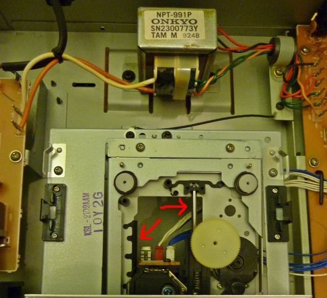

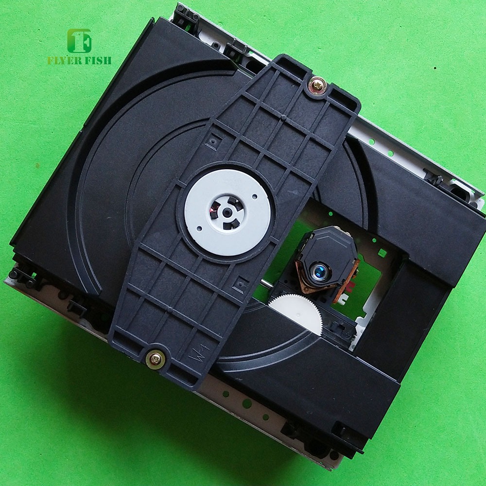

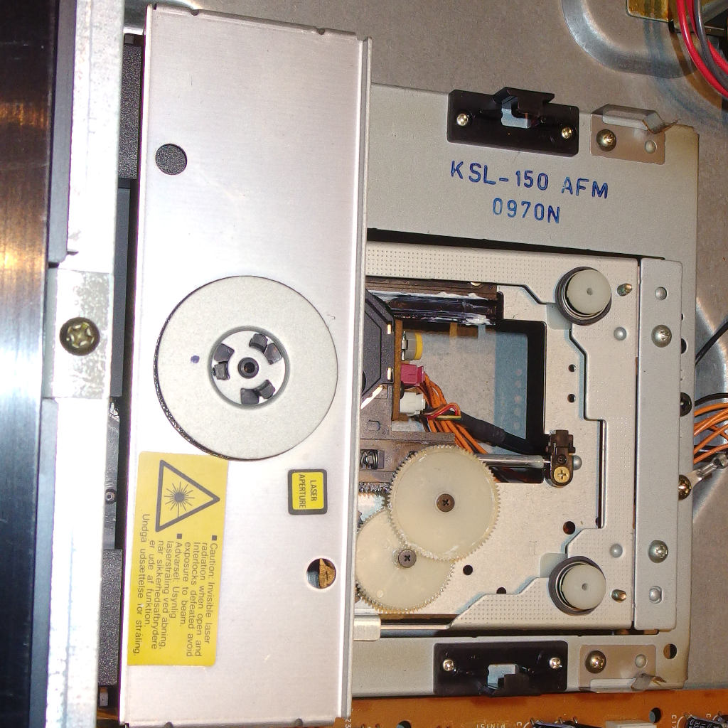

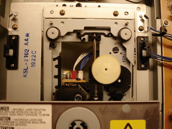

Maybe the reason for not finding datasheets like that one under
https://www.farnell.com/datasheets/1944121.pdf
for KSS-213C = KSM-213CCM/213CDM
is the fact, that not SONY is the manufacturer - at least according the datasheet
The manufacturer is
Smartech Electronics and Machinery Manufacturing Co.,LTD
Maybe the manufacturer of the other loaders are also other companies.
KSS-150A = KSL-150AFM
KSS-210A = KSL-2102AAM/KSL-2101ABM
KSS-210B = ?
KSS-212A = ?
