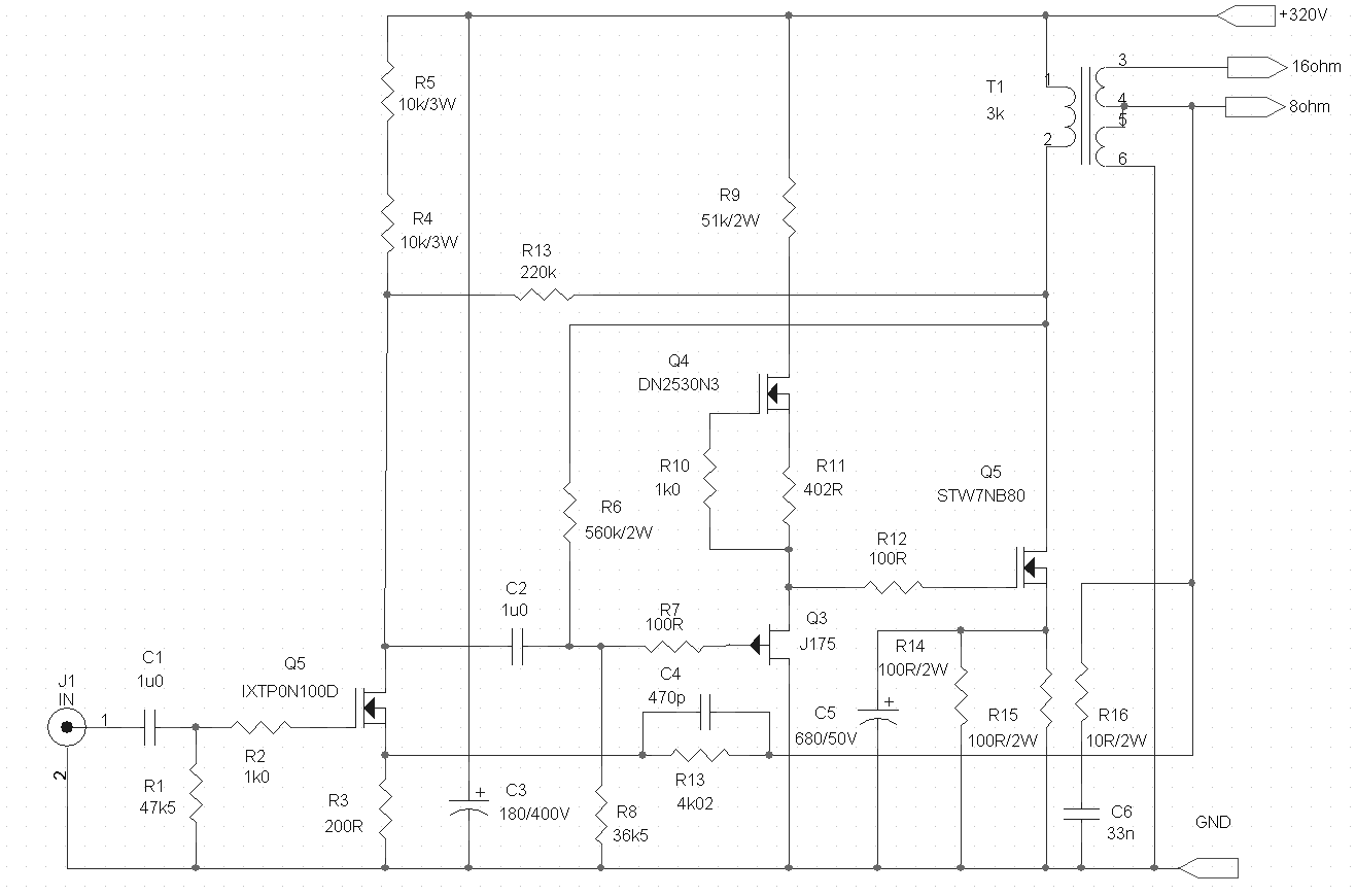

I'll look tonight if I remember for the value of the feedback resistor omitted in the original schematic. A hint - it was considerably in excess of 10k - more like in the region of 330k.

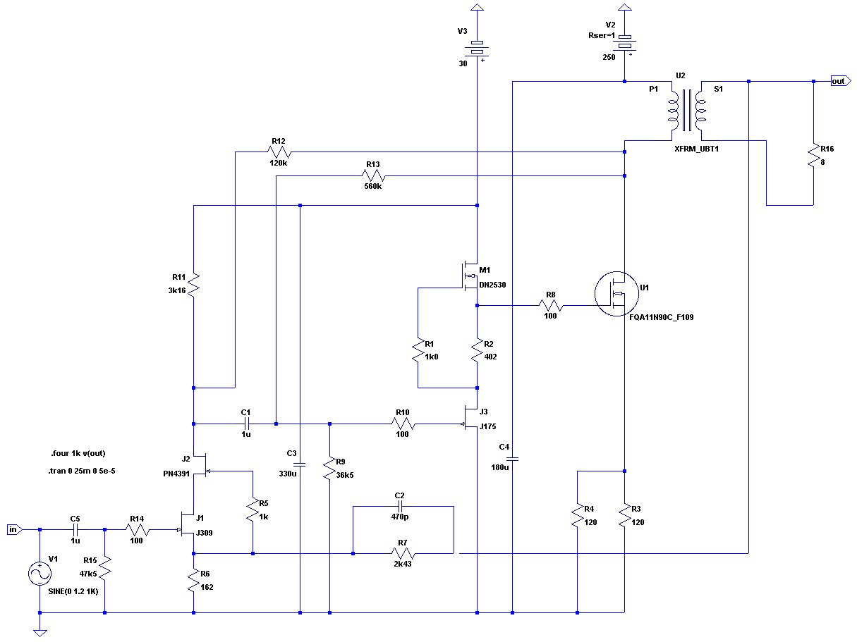

What is the impedance of the transformer you used in your simulation? I used the One Electron UBT-1 in the actual amplifier, which has a 1.6k primary impedance (14.1:1 turns ratio). A higher impedance transformer will have a larger step-down ratio, lowering the loop gain and increasing THD, also reducing the available output power.

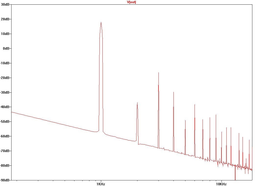

With a proper SPICE model for the UBT-1, a good value for R13 seems to be 120k. Output power is now 7.5W into 8 ohm at 1kHz with 1.7% THD. Efficiency seems to be less than 10%, but such is the nature of these beasts.

Edit - On another note, it's interesting that you cite 120k as a good value for the partial feedback resistor. I would have used a higher value so as to leave some gain for the global feedback loop. That extra gain also helps to straighten out the output transformer - this shows up in the square wave response. For an example, check out the "SiC Puppy" thread where I show the square wave response of that amplifier (also using UBT-1 transformers) before and after closing the global loop.
