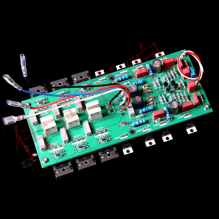

Tks Danny. Great input and ideas and info.
1) yes the thermal pad will go, will replace with the silicone pads I have on order.
2) On the predrivers, Can I lift them from the pcb and install on the main heatsink with ptp wiring? Would invalidate the clone warranty :)
After placement on the main pcb, I do plan on reverting to the 36 ohm resistors. If that works, then I might line up and install an aluminum buss across all the TO220's. Better conduction/ heatsink contact, as well as the bus itself acting as a heatsink.
Will play with r9/10 as well.
3) Question. How do I adjust output stage bias?
You can try to install the predrivers also in the heatsink, see if you can reconnect the predriver not at the original holes but closer to the heatsink to keep minimal wire length. Maybe also move some resistors.
Output stage bias is done with the base stoppers R23/R24: 27ohm=180ma, 22ohm=200ma, lower=more current.
Also by changing the drivers current, R19/R20, but those drivers are already highly biassed.
Another tweak, the input stage uses a single 15v zener, better to use a string of 4.7v+4.7v+5.1v zeners.
Zeners above 6v can be much more noisier.
Changing R9/R10 from 360 to 470 gives the driver stage 6db lower distortion, according to Ltspice :)
Tks Gaborbela, sounds logical, but how should I trim it? I'd rather it do 5 watts class A instead of 20 given that this version I am building is in a smallish enclosure. I'd rather not have to install fans
Now I understand what you mean, I was not aware there is no trimmer pot to set up the bias.:confused:
Only option you have you must change some resistor values like the 100K (R3,R4) or the 3.3K (R5,R6). To do any change you must run some sim. The other option you got to lower the rail voltage, that automatically lower the total bias. Danny has a lot of experience with these amp, I do not even own one so I can give only some limited advise based on the circuit.

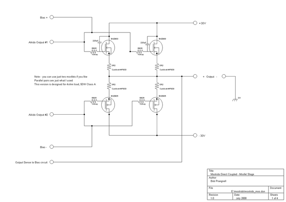

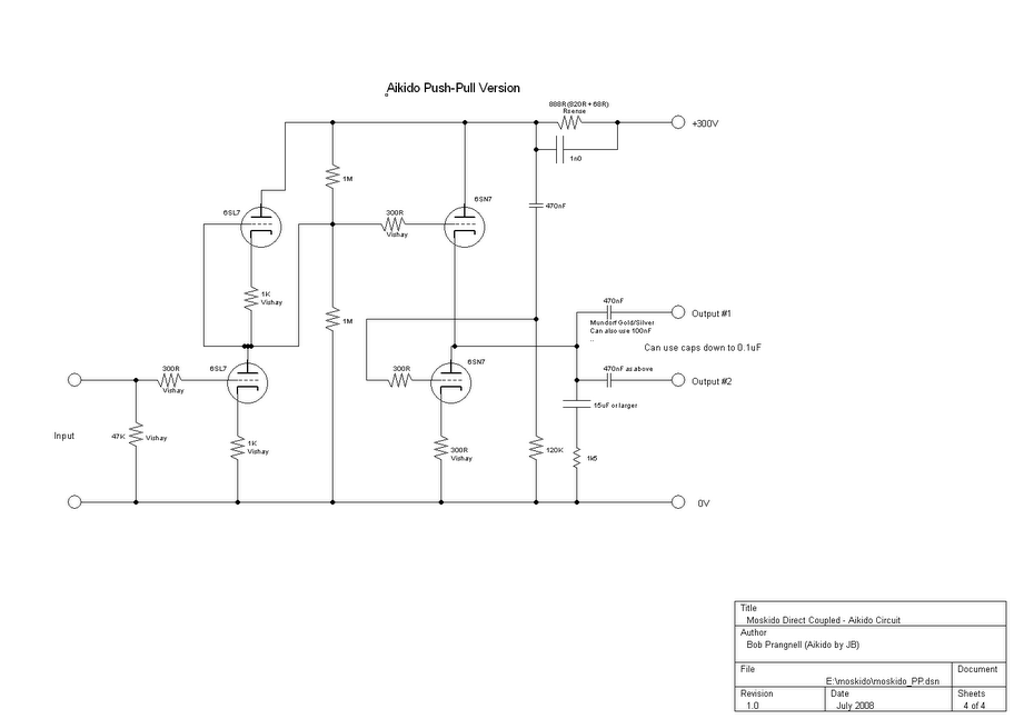

Just a thought: perhaps the reason DartZeel sounds as good as people say is because: a) No global feedback, but: b) internal loop feedback across the two amplifying BJTs, and c) emitter follower driver across all three stages. Using the emitter followers will of course help make the amp fast.
So here are some ideas on how to take these insights and play:
1) Replace output with MOSFET to simplify signal path. The VAS section should be modified with a BIAS pot. And of using 2sk1058/2SJ162 we would need two of each.
2) Use the DartZeel idea of local loop feedback to drive MOSFETs with say 6SN7s coupled as a plate follower.
Thoughts?
D.
Thoughts?
D.
I agree with you
Great idea, I would use some high power laterals from Exicon one or two pair per channel to get out some power or capability to drive any speakers.
I would keep the driver stage as it is with the bipolars and the mentioned tube input stage. Something like the Moskido amp was only with with a single tube.:)

I recently finished one of these amplifies using the claimed "1:1" copy pcb boards. They are fairly easy to build, probably one of the easiest amplifiers I attempted to put together. These sound fantastic, probably one of the best chinese copy cat offerings. I dont know how the other versions sound but this one is definitely worth building.
image hosting 5mb
Hi Apoopoo999, I have the same inrush limiter circuit as you have in the photo. I am struggling with the implementation...
The on-off connector is separate from the main on-off that the circuit needs to power up, so by default u need 2 power switches.
You cannot pre-short the on/off connector so as just to use the main power switch to turn the amp on/ off... you physically have to manually first turn main power on, then after 1-2 seconds short the on/off jumper, this is a 2 step manual process just to switch the amplifier on.
Lastly, removing the short from the on/off jumper does not turn the amplifier off... it stays on, so you then need to use the mains switch to turn the amplifier off.
It seems the on/off jumper "only" turns the amp on, removing the short does not turn the amplifier off... this is weird. To turn the amplifier off (without using mains switch) you need to short the 75c jumpers, But that too is not feasible since to turn power back on, you need to recycle the mains switch again... this is a pain. Why did they design it this way... unless I have a defective board...
