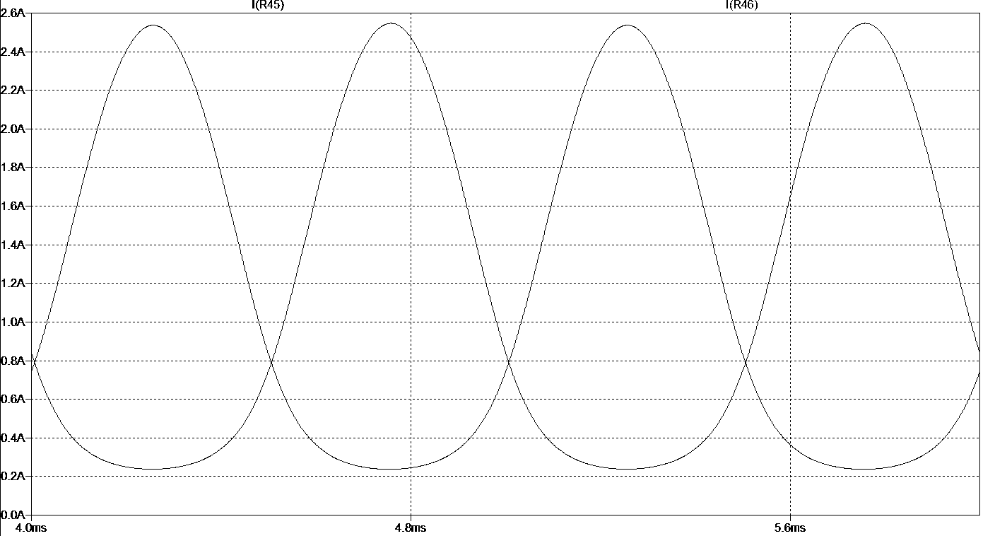

Is thermal stability of the biasing current of the outuput transitors (related to 2 Vbe of driver transistors in CFP vs 4 Vbe of Darlington pairs) a reason for more stability with Sziklai configurations?
I've done a simulation comparison without heating effects. It looks like Darlington configuration behaves better. Am I right? Does a comparison like that have any meaning?

Your simulation isn't fine-grained enough, you'll get much better distortion figures if you fix that. If the simulation takes less than 10s to run, its likely not accurate enough.
You lack driver biasing resistors in both configurations. Your EF output stage lacks a speed-up cap. Have you optimized the bias current for each topology (normally 100mA for EF, 10mA for CFP is a good starting point).
CFP will be somewhat more linear, its got lots of internal negative feedback. This will be especially true driving low impedance loads like 4 ohms
CFP doesn't admit a speed-up cap so switching distortion is usually an issue at HF, especially with slow output devices like the 2N3055.
CFP can be harder to make stable due to the internal feedback, there are various tricks like adding small-value base resistors to output and/or driver transistors that can help.
Its not really a darlington strictly when the driver bias resistor and speed-up cap is in-place, its emitter-followers chained together. If you use darlington devices you cannot add the speed-up cap which is a strong reason to avoid them. The speed-up cap will reduce switching distortion a lot for the EF output stage, its major advantage (along with good stability).
CFP stage has somewhat less voltage overhead which is a major boon for 12V amplifier circuits, which are usually dual CFP amps in a bridged configuration to get the most from the 12V (and predrivers will be bootstrapped for the same reason).
[ And here's my hacked version with various improvements (hopefully) and 4 ohm loads ]
