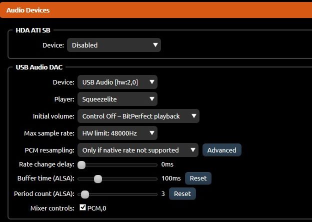

Hello everybody!
I hope this is right place to submit my problem.
I used Fujitsu Futro s450 (http://globalsp.ts.fujitsu.com/dmsp/Publications/public/ds-FUTRO-S450-2.pdf) with newest BIOS available, 1GB RAM, 2GB CF. Daphile was instaled on CF. Booting correct, detecting internal sound card correct, playing through it also correct.
I try to connect external DAC (Amazon.com: MUSE USB DAC PCM2704 Sound Card Optical Coaxial Decoder USB to S/PDIF Converter: Electronics) with PCM2704 inside.
The Dephile detects it correctly. In setup I see both sound cards - internal and external DAC.
After cold restart (unpluged power plug) and reboot, DAC plays track selected before. When I change track while playing, DAC dying and stops play. After warm restart (software) DAC doesnt alive. Only cold restart helps. Different changes in BIOS setup didnt help (ie. deactive internal sound card). I also try different versiond of Daphile with no effect.
In other hand Daphile and this DAC running on "big" stationary PC do not have this problems.
USB in Fujitsu are smooth and handle both pendrives (up to 32GB) and external HDDs 2,5".
I tryed almost anything in setup but with no success. Could anybody help me or sugest where I should search? Thanks.
Regards from Poland
Tom
PS. Anyway, thanks for such good soft.
This is what Daphile see:

Card #2: USB Audio DAC
Driver: snd-usb-audio
USB BUS: 006/002
USB driver: ohci-pci
Device ID: 08bb:2704
IRQ: 18
310 (PRY:80)
Mixer controls:
Config:
PCM,0,on
Contents:
Simple mixer control 'PCM',0
Capabilities: pvolume pswitch pswitch-joined
Playback channels: Front Left - Front Right
Limits: Playback 0 - 128
Mono:
Front Left: Playback 128 [100%] [0.00dB] [on]
Front Right: Playback 128 [100%] [0.00dB] [on]
Device #0 (enabled): USB Audio
Player process: squeezelite (PID:2379)
Max sample rate: 48000
Format: S16_LE

aplay info:
**** List of PLAYBACK Hardware Devices ****
card 0: Dummy [Dummy], device 0: Dummy PCM [Dummy PCM]
Subdevices: 8/8
Subdevice #0: subdevice #0
Subdevice #1: subdevice #1
Subdevice #2: subdevice #2
Subdevice #3: subdevice #3
Subdevice #4: subdevice #4
Subdevice #5: subdevice #5
Subdevice #6: subdevice #6
Subdevice #7: subdevice #7
card 1: SB [HDA ATI SB], device 0: ALC262 Analog [ALC262 Analog]
Subdevices: 0/1
card 2: DAC [USB Audio DAC], device 0: USB Audio [USB Audio]
Subdevices: 0/1
Regards from Poland
Tom
Code:Device #0 (enabled): USB Audio Player process: squeezelite (PID:2379) Max sample rate: 48000 Format: S16_LE
IIUC the daphile-formatted info your playback device is the USB card.
Cypis
1 disabile card 1
2 try to enable mixer 1 AND 2
All output in both sound cards were set "on" (checkbox was marked).
Yes. I have two sound sources. Integral sound card and external DAC which Daphile sees as "USB sound card"
Regards from Poland
Tom
