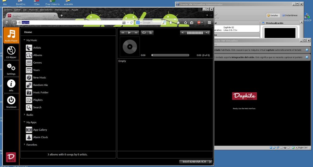

Anyone tried Daphile in a virtual machine using the host as the controller...? Would that even work...?
Any guidance would be most welcome..
Yep... I'm trying it using that way, and it works fine...
attachment.php
Except that would be a wireless solution would it not...? ;)
Looking for a local solution that involves 1 (one) device only.
One that William of Ockham and his 'whisker reduction device' would approve of...:)

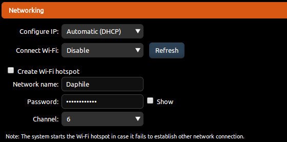

I have looked through the menus in Daphile but can't find one to "create a hotspot'
As there is no ability to drop to a command line I am at a bit of a loss to know how to implement this..

Not all wifi cards can be switched to AP mode, at least with linux drivers.
I have very limited experience on different Wifi adapter (six different chipset based).
  • One Broadcom adapter does not work at all with Daphile because the firmware file may not be redistributed as part of any distro and Daphile does not support user installation of individual packages
  • One Realtek based adapter seems to support also AP mode but authentication fails always. There is probably some kind of driver problem. CLient mode works.
  • atk9k miniPCIe, Zydas ZD1211 USB and Intel 6235 miniPCIe Wifi adapter that I have work fine also in AP mode.
  • Old Intel 3945ABG adapter (miniPCIe) does not support AP mode, otherwise OK.
So three out of my six Wifi adapters work fine.
"Create Wifi hotspot" is available in the Settings only if the Wifi adapter is recognized to support AP mode.
Thanks for that clarification.!
Guess I will have to use a usb stick with Daphile on it and try several laptops until I find one that has a suitable chipset.
