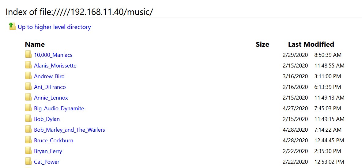

Thank you!!! \\192.168.11.40\music works!
I've got a list of music folders....ok next dumb question....how do I copy/paste these to a folder on my local machine?

The picture you shared show that you are using a web browser and not windows file explorer !
Drag'n drop should be possible folder by folder.
If you open File Explorer (open any folder on your machine) and paste in the path bar or use [Win]+R Run Box, paste \\192.168.11.40\music. You have the right basic tool to manipulate files.
Open your tumb drive as usual and ask yourself how do I copy from a folder to my thumb-drive...

Thanks chfaure!! ...I'm an idiot..and it was before coffee this am... :eek:
copying now..I know you mentioned 3 times FILE explorer...
Thanks again!
