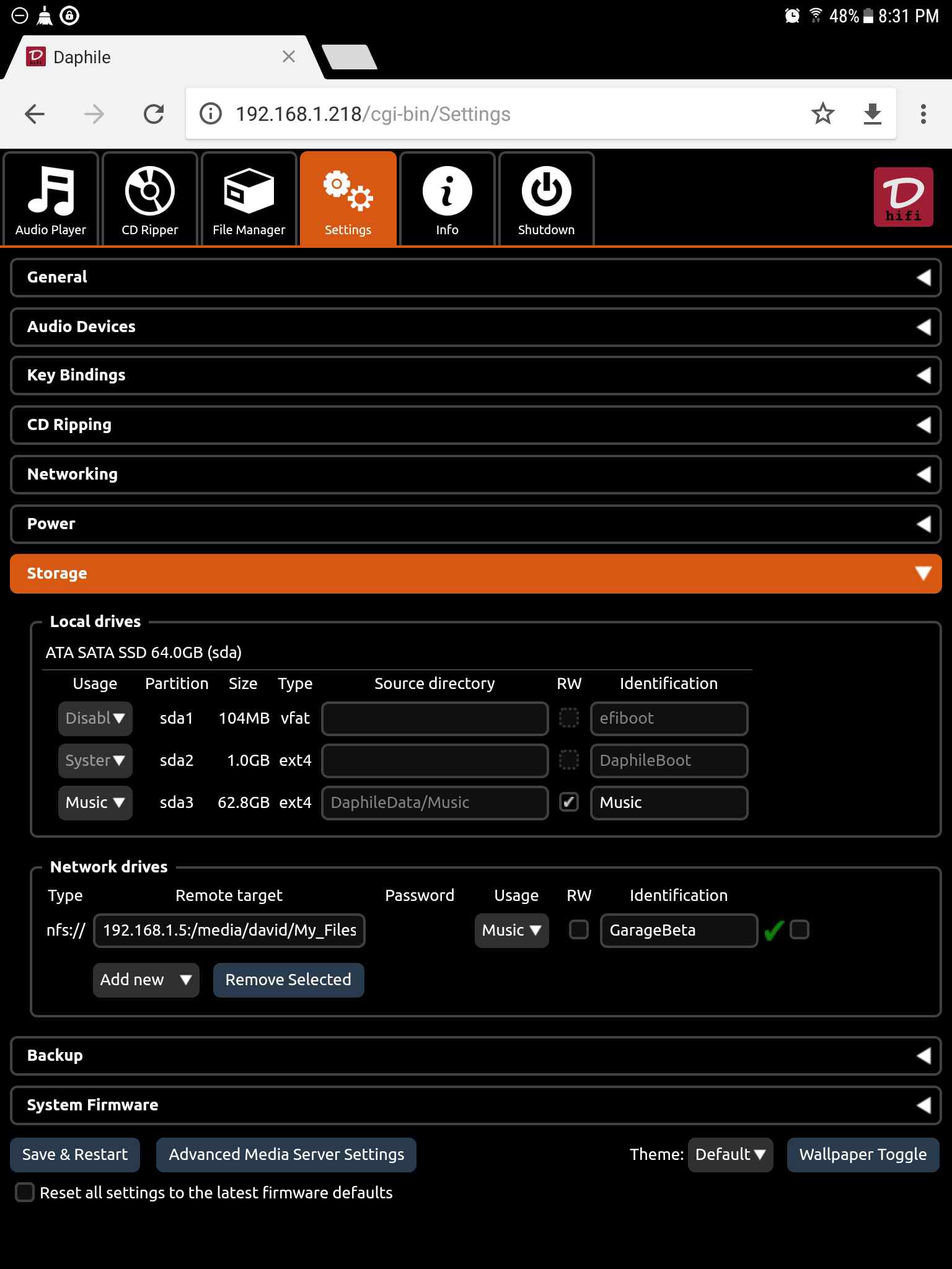

I've read the wiki page and everything i can get my hands on. I'm not using windows. I'm using ubuntu (linux), which in theory should be easy to do since daphile is Linux too. As for storage settings, I think I've exhausted all permutations of user, ip address, password, folders, etc.. I just get the :forbiddn: sign at the far right.
Some examples from yesterday. Today I tried another 10 or so.
Since you use Ubuntu on your fileserver did you enable CIFS on it? (I don't know if CIFS is installed by default on Ubuntu). Check if cifs-utils are installed. If not you should do so (apt-get install cifs-utils) and then "export" your file locations you want to see remotely. (It's been a while since I did this myself so I can't tell you how to do this. I know that e.g. the webmin tool can help you with that)
If you already have CIFS running (and file locations are "exported") you should be able to mount the file location as you tried already. I don't know if you are running the Daphile stable version or one of the Beta versions? If on a Beta version you will be able to login via SSH from Ubuntu. Use "root" and "zaq" as user and password. Then try to mount manually from the linux-prompt, e.g.:
mount -t cifs -o username=USERNAME,password=PASSWD //192.168.1.88/shares /mnt/share
(of course use your own IP/sharename/mountpoint,etc.)
If it works you can go to your mountpoint and you should see your files/directories. If it does not work at least you'll see an error-message which may help you further.
I hope this will help you to solve your problem :)
(P.S. you can also use NFS to export/mount your file locations).

Success! Thanks for your help and patience. Turns out on the server side (the remote machine) there are two new packages to install, nfs-common and nfs-kernel-server. Then chmod to allow permissions on various directories. Then exportfs command to export the filesystem. And then add a line to fstab to make sure your partition mounts automatically on server startup. And at some point I started the nfsd service.
Simple once you know what steps are needed. Otherwise very frustrating.

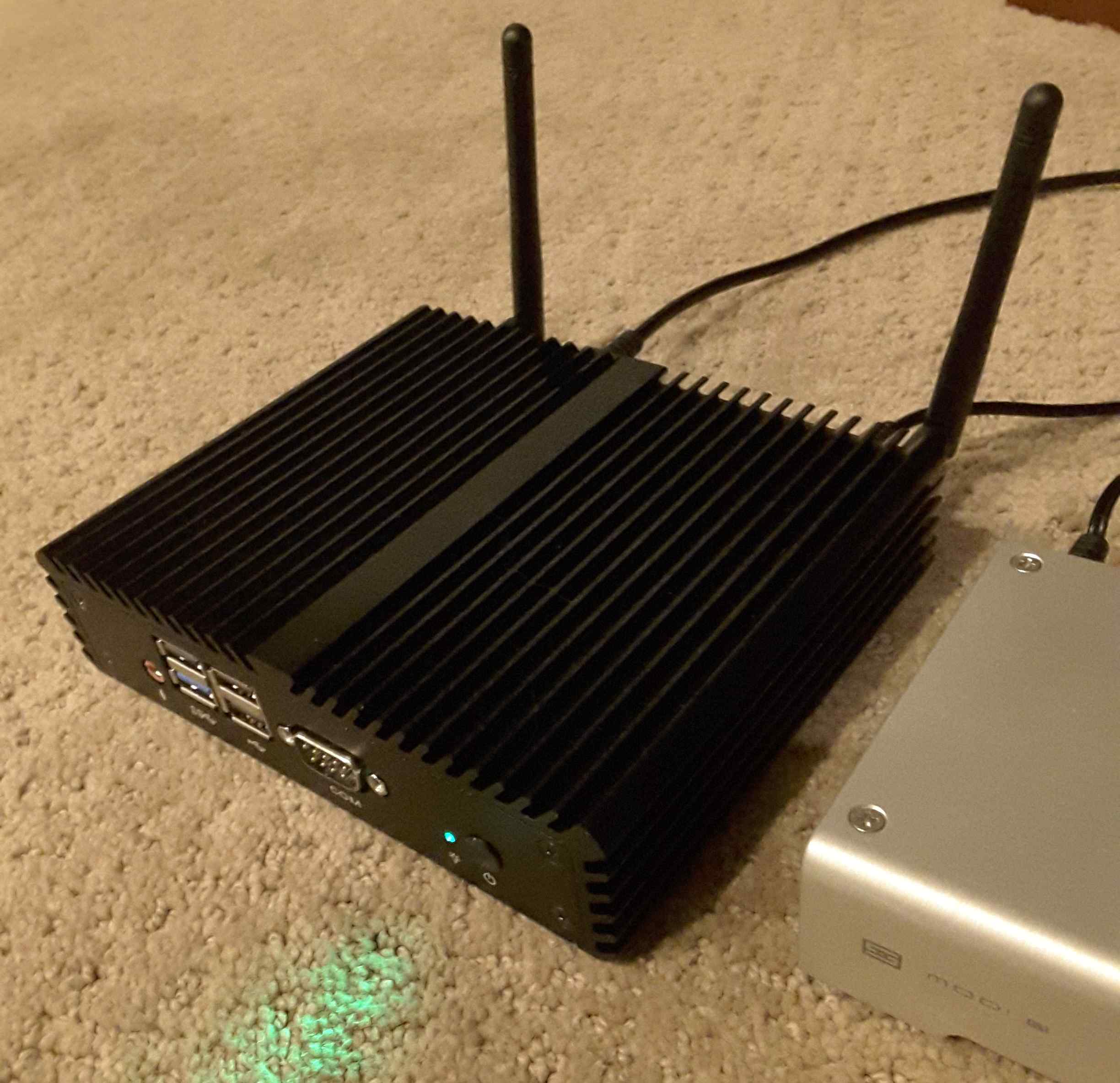

So I'm up and running, see pictures. Daphile works fine with a schiit modi 2 uber, modi 2 multibit, and a hifime DAC. Is someone keeping a list?
Anyway I realize that 1st paragraph is too much info, unless you're stuck in Ubuntu.
And my cheap, direct from HK, medium power, fanless computer runs like a champ.
