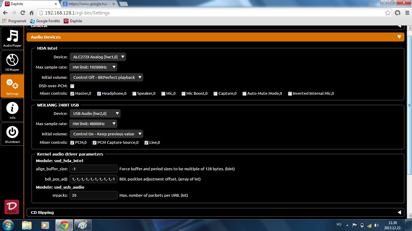

Hi!
I tried the Daphile and have some problems:
- Volume control is not working. I've tried selecting "Control On-Keep Previous Volume" and "Reset to Fixed" and restarting but the Volume slider did nothing except, that only the fixed volume worked.
- On my ACER ASPIRE ONE netbook in the booting I get "undefined video mode:317" message and the window crashes, but the Daphile is working behind it.
- With my Weilang 24Bit/96Khz USB to SPDIF converter I can get only 48Khz setting.
- Is it not playing APE files?
- The program (WEB interface) many times slowing down, or disobeys my commands, (for example: pause, stop etc.) or even crashes the window, but the music is still playing.
Otherwise it has very nice sound!

If you are using Daphile without the network connection i.e. Daphile works as an Wifi basestation or you have only ethernet cable between Daphile PC and the other PC then this is a known issue that I haven't managed to fix. Is this th case?Hi!
Daphile tries use 1024x768x16bit graphics mode (vesa mode 317). I'll try to think some kind of fix for this in the future.- On my ACER ASPIRE ONE netbook in the booting I get "undefined video mode:317" message and the window crashes, but the Daphile is working behind it.
Could you send me the output from http://daphile/cgi-bin/audioinfo.cgi of your Daphile PC. Please send it through the contact form on www.daphile.com- With my Weilang 24Bit/96Khz USB to SPDIF converter I can get only 48Khz setting.
APE files aren't currently supported because the conversion application license terms are a little bit unclear to me (I wasn't sure if the redistribution is allowed). I have asked clearance for this today and if the conversion application may be redistributed I'll fix in some future release.- Is it not playing APE files?
Could this be some kind of networking problem? Is Daphile having some high load activity (library scanning, ripping encoding, file conversion/resampling) that make your single core processor overloaded? I didn't quite understand what did you mean with "crashes the window" (if the web browser crashes the reason must be somewhere else than in Daphile).- The program (WEB interface) many times slowing down, or disobeys my commands, (for example: pause, stop etc.) or even crashes the window, but the music is still playing.
That's the most important ;-).Otherwise it has very nice sound!
Hi Kipeta!
Thanks for your help!
- I use the Daphile on my netbook with WiFi connected to my HP620 Notebook. Without ethernetcable, and without any router and any other network. Just the two PC.
Greets:
Tyimo
O.K. I will send.Could you send me the output from http://daphile/cgi-bin/audioinfo.cgi of your Daphile PC. Please send it through the contact form on Daphile ? Digital Music Convenience for Audiophiles
e.g.:The control buttons doing nothing.I didn't quite understand what did you mean with "crashes the window"

Hi Kipeta!
I tried the networkcable connection, but the volume setting still not working. Just the full output or a fixed value.
Greets:
Tyimo
I sent you the datas.Could you send me the output from http://daphile/cgi-bin/audioinfo.cgi of your Daphile PC. Please send it through the contact form on Daphile ? Digital Music Convenience for Audiophiles
