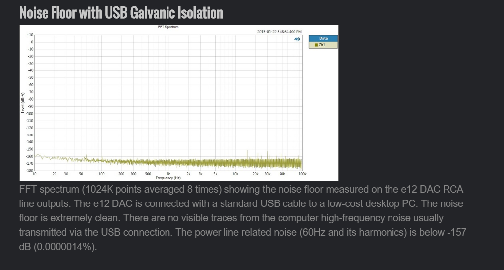

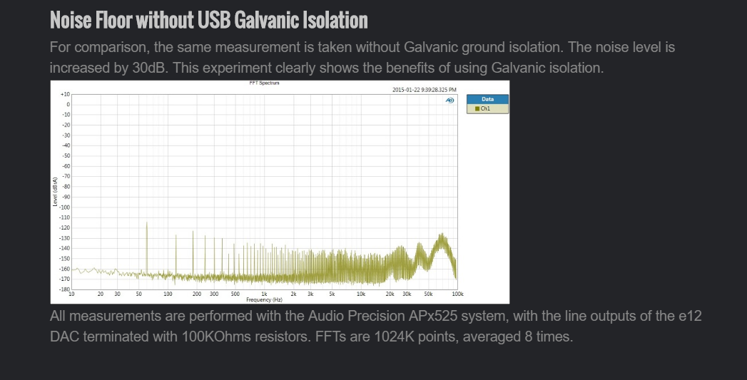

You make more money when people buy into a belief system of "everything matters" and think that there are differences even when there are none.
Well here's some evidence from Exasound.
