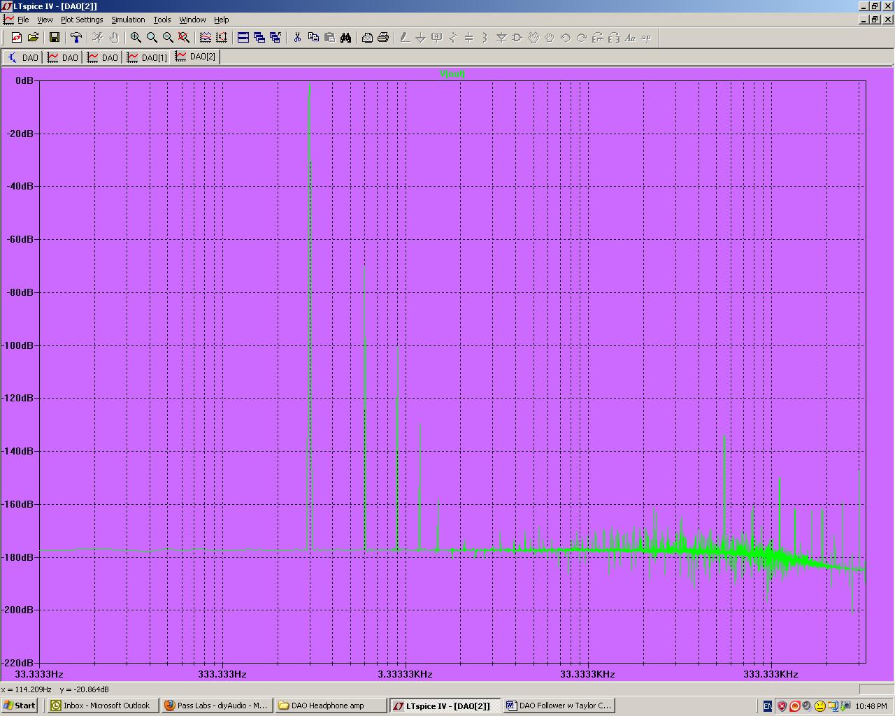

I have been asked about the distortion performance of the TCS version vs DAO with original CCS. Apparently simulation gives better results with the CCS than the TCS.
The idea of the TCS is to modulate the lower current source so as to provide more current drive, as well as cancel most of the even harmonics (when done right). The circuit values published were NOT based on simulations, but actual measurement of devices (LU1014s) under near-working conditions (bias, Vds, temp, etc.).
But if you would take Steen's well documented review, then there is little to choose between the two. So I would only say, build both and decide for yourself which one suits you better.
