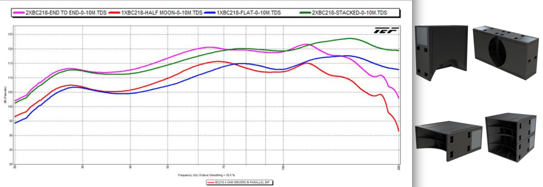

I have measured and (repeatedly :^)posted the same thing Ivan Beaver and Tom Danley have, that the low corner does not drop in TH multiples, and that the low corner drop in FLH is not much either.
As you can see in the measurements of the 60 x 60 x 30 inch DSL BC218, (hardly an "undersized" FLH), the low corner hardly decreases from one to two cabinets, and the upper response actually increases several dB more than the 6 dB low corner increase one would expect from doubling cabinets and power.
The measurements also show the difference between being set as an FLH (flat) and a BC (boundary control), the BC increases level between 40-70 Hz, but rolls off response above 120 Hz.
Art
The roll off at about 120hz is not a naturel system roll off. It`s probably that some acoustic energy is reflected back to the throat and causing an additional low pass filter.
