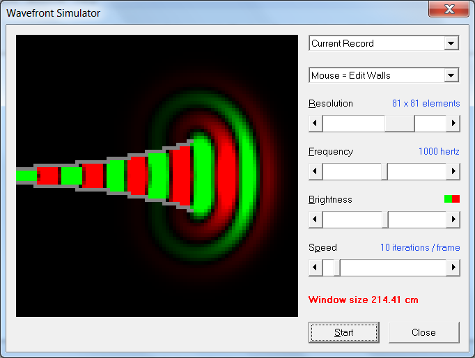

Maybe a series of pics will help. You can let me know at which step you disagree.
A multi segment 2 pi sim in Hornresp or Akabak would reflect this physical situation. A horn mouth flush with the ground, which is considered to be a single infinite boundary. Note there is no bubble drawn in, apparently there is no bubble included in the sim.
Now a 1 pi sim in Hornresp (Akabak can't do 1 pi). A horn mouth flush with the dual boundary junction (despite the fact that it's physically impossible to build this correctly). Both boundaries are infinite size and no bubble included in the sim.
Hopefully the 1 pi horn looks larger, it should. I don't know what's going on mathematically but the 1 pi sim of a single cab looks exactly the same as a 2 pi sim of dual cabs. Shown is a random tapped horn sim, the black line is 1 pi, the light grey line is a 2 pi sim in which the multiple speakers tool was used to show 2 cabs in parallel (double the cabs and double the power). If you can't see the grey line it's because the two examples are a perfect match and overlay perfectly. David rejected the term "reflection" earlier, but it does look a lot like a reflection at least in terms of 1 cab in 1 pi = 2 cabs in 2 pi with twice the power.
What needs to be done to get an accurate sim of a boundary extension is to simulate the response of a finite boundary to show the effect of the boundary extension. A diffraction model does this, it takes into consideration the size and shape of the boundary and also the location of the sound source in relation the boundary edges. The boundary provides a forward directivity and increased radiation resistance, same as the 1 pi sim above but only to the waves small enough (frequencies high enough) to be affected by the boundary size, and the sim will show rippled response due to reflections (red arrow) and interference (different path lengths shown with green arrows). Still no bubble, no bubble is considered by the sim.
That's what Xrk did, a normal sim but with diffraction added to reflect the 60 x 60 inch front face. Note the remarkable similarity between his sim and the Danley measurement. I take this as proof that a diffraction sim is already pretty close.
The only thing left to consider is the bubble. Today we learned that none of our multi segment sims in Akabak or Hornresp consider the bubble anyway, so we could ignore it.
Or we could consider it. I'm not sure how big the mouth is exactly on the Danley horn, but based on a 20 inch diameter the bubble would be 6 inches forward of the mouth. Due to the increased radiation resistance provided by dual boundaries (the ground and the horn boundary) it might be considered in the sim to be a bit more than 6 inches.
What we would not do is consider the bubble to extend all the way to the boundary edges, the boundary (180 degree waveguide) has no ability to contain the wave against the expansion of being released into open space in a way that could be considered a horn flare.
I think this matches what's going on a lot better than vortexes and virtual flares made of air.

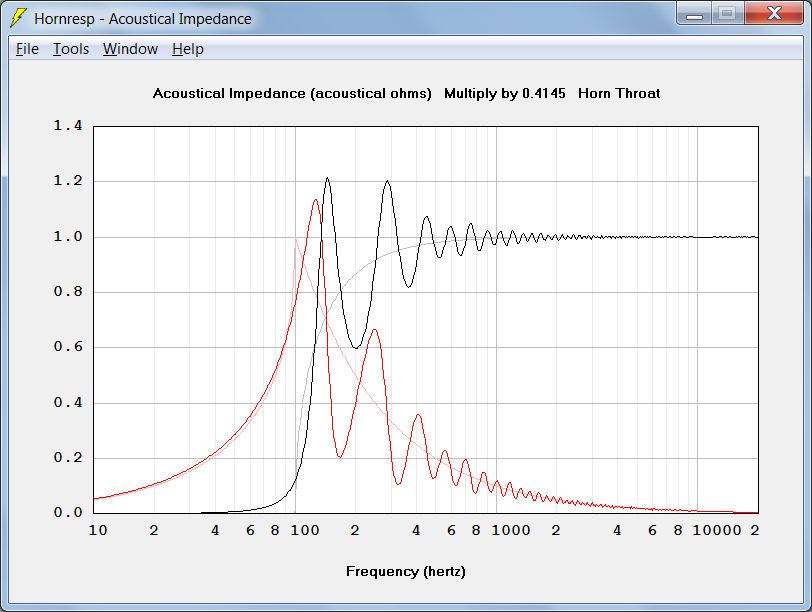

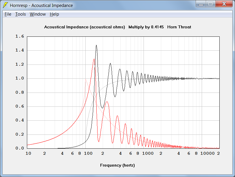

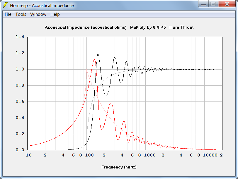

There is very little difference between the plane wavefront model and the isophase wavefront model up to the point at which the horn mouth size exceeds Cir = 1, where Cir is the free space normalised horn mouth circumference in flare cutoff frequency wavelengths, assuming an axisymmetric horn. The Webster model is entirely adequate for most bass horn designs, straight or folded, because the mouth size is usually less than Cir = 1.
To illustrate the above, attachments 1 to 4 show the throat acoustical impedance for a 100Hz exponential horn, where:
Attachment 1 shows the throat acoustical impedance when Cir = 1, calculated using the plane wavefront model.
Attachment 2 shows the throat acoustical impedance when Cir = 1, calculated using the isophase wavefront model.
The different between the plane and isophase results is minimal.
Attachment 3 shows the throat acoustical impedance when Cir = 3, calculated using the plane wavefront model.
Attachment 4 shows the throat acoustical impedance when Cir = 3, calculated using the isophase wavefront model.
The different between the plane and isophase results is now significant. The plane wavefront model has broken down and the results have become inaccurate. The isophase results are tending asymptotically towards the infinite case (light red and grey traces) as Cir increases, which is the correct outcome.
It should. The math is identical (or it should be). We do this with magnets as well. Also, electrostatics does the exact same thing as well.

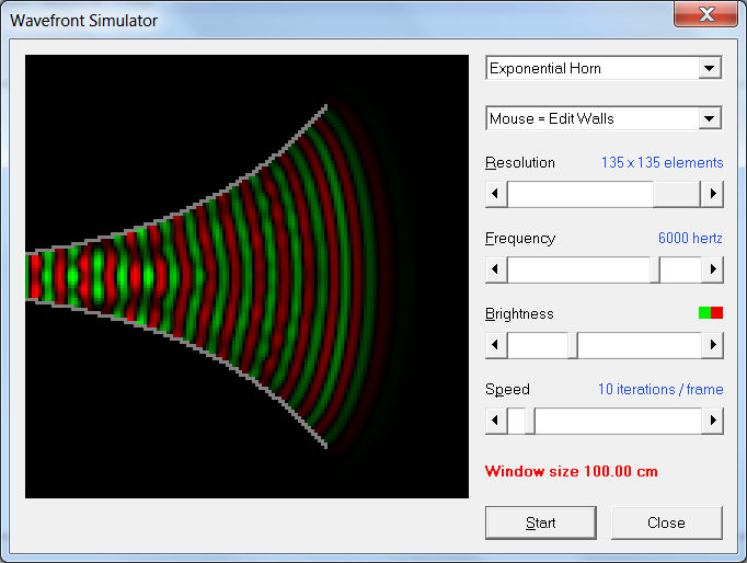

Again, the diffraction models shown uses wavelength significantly smaller than the openings. It assumes planar waves approaching the opening as well. David's jpg, while also using smaller wavelengths does show some of what I'm thinking of..
The plane waves going through the hole are clearly much larger than the hole, they narrow as they go through the hole and then expand in a curved wavefront.
I believe the drawing you provided will create reflection at the boundary everywhere except at the hole. There will be energy crowding at the orifice, due to the boundary reflection increasing the pressure variations.
See attachment.
Thanks David. I note also the wavelength is significantly smaller than the mouth, but see no reasonable way to have the point made with lower frequencies.
Of significance to me is the shape (curvature) of the fronts as they leave the confining walls in your model. Note that the sim has no curvature within the mouth, and the further it travels, the more non-planar the wave gets. I would suspect this volume of space, where edge effects have not yet been eliminated, may be what Danley is thinking of. edit: If you look carefully, the area where the boundary effect goes away is somewhat triangular in shape. If you were to put two horns side by side, the midplane conditions mirror, and the triangular boundary effect area will extend to twice the length. This aspect is entirely consistent with the general knowledge that adding more and more horns extends the low frequency response. I'm not saying it's cause and effect, but that it is consistent with current knowledge.
edit: I do feel however, that at lower frequencies, the model needs to go non linear. Pressure/rerafaction at the edges cannot be symmetrical when wavelength approaches mouth size.
edit 2. I note you also do not include boundary effects within the horn. I would have expected curvature to start as a consequence of the wave travelling against the expanding boundary.(I see now that you do indeed have that, your isophase mode)..
Again, thanks guys, a really nice discussion.
Again, no it doesn't. I made the plane waves approaching the exit bright red so you can see how big they are compared to the opening. They narrow as they go through and then expand on the other side. If the waves were small they would go right through the hole and be completely unaffected. (Or hit the wall beside the hole and bounce back the other way.)
David showed the exact same thing, as the large wave passes the boundary it wraps back around. I put a couple of curved red lines on the picture on the right to show the wrap around at the edge. This is all simple diffraction.
Diffraction is what happens at the edge. The finite boundary itself provides extra forward directivity and radiation resistance. This is all captured well in a diffraction sim.
No it's not, the waves are larger than the mouth.
If you still don't agree put up a pic of what you think a large wave going through a hole looks like.
In your drawing, the energy which hits the wall will reflect back. At the hole, it passes through. At the hole edges, the pattern changes due to edge/reflection effects on the drive side of the boundary.
You are confusing width with wavelength. Wavelength is the distance from center of red to center of red in David's simulations.
Diffraction happens even when the wavelength is smaller than the hole. It may be argued that is where it matters more - hence desire to make features around a dome tweeter very smooth and flush and have rounded baffle edges not sharp. Diffraction of larger wavelengths with features of size of hole or baffle don't matter as much because hole or feature is smaller than wavelength. Not the other way.
Width is a necessary component of wavelength. If you take Hornresp's Wavefront Simulator (the pic he showed) and increase the frequency, the waves stop wrapping around the edges, they proceed with full forward directivity in the forward direction.
Width is a necessary part of a 2 dimension simulation. It has nothing to do with the definition of wavelength.
