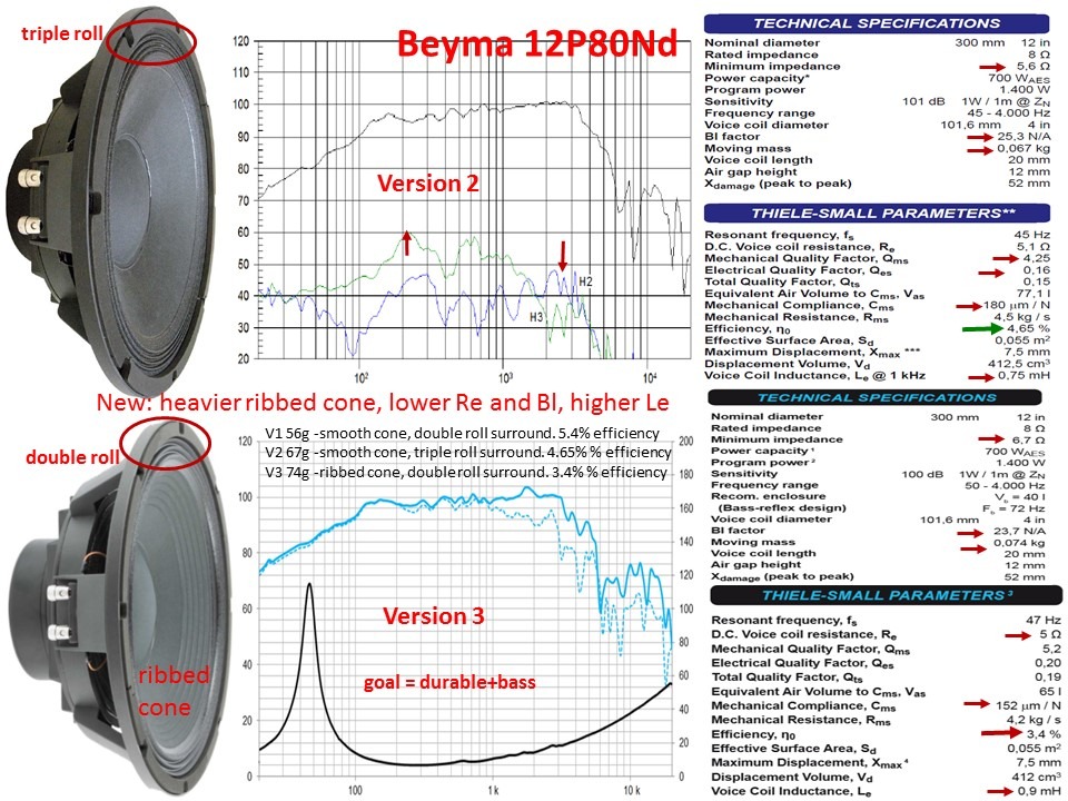

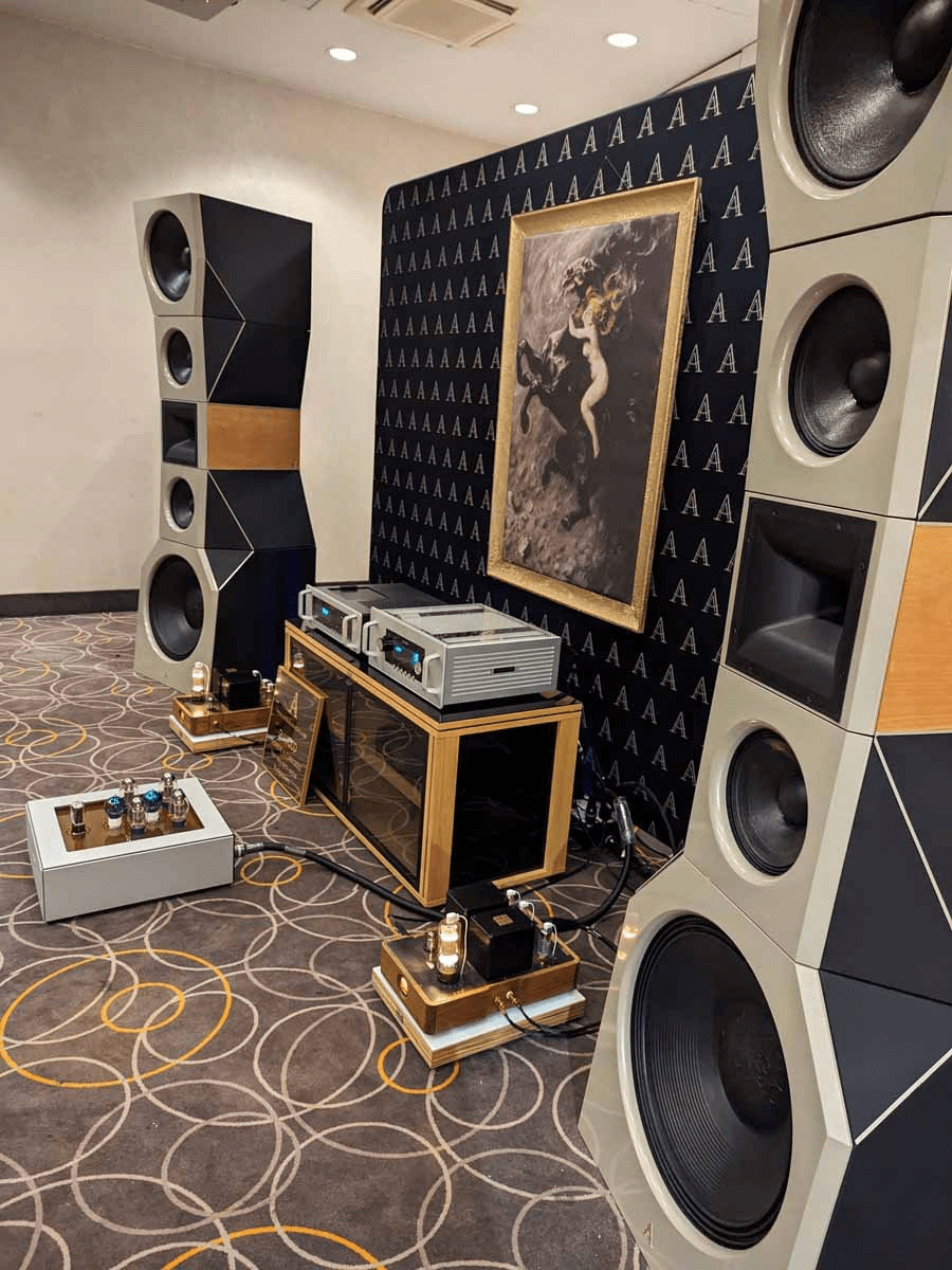

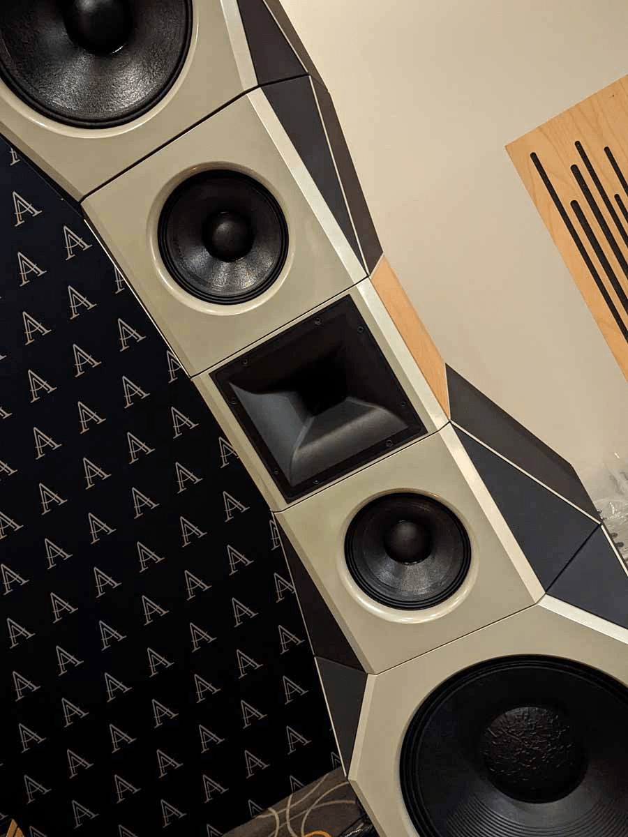

I plan to design a speaker with similar approach with Beyma TPL200 + 10MCF400Nd and probably 21PW1400Fe V2.
Can you name your 12" mid please?
J.
Beyma 12P80ND / V2
Be aware there are 3 different models of it that has been produced.
The earlier versions had different smooth cones and surrounds etc and higher efficiency.. Plenty of info on that transducer available on here, search for 12p80 on the forums here.
And the one in the pictures from @atilsley is a smooth coned version, so not current production model.

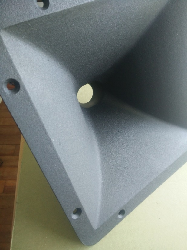

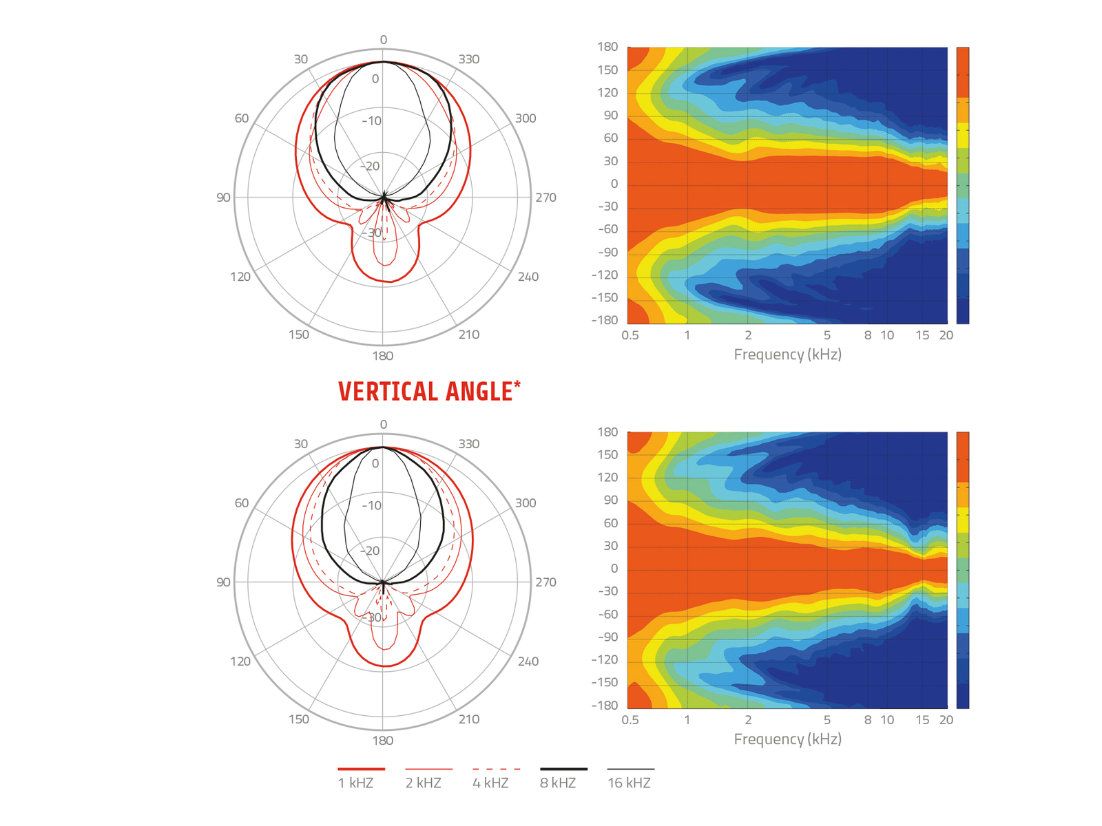

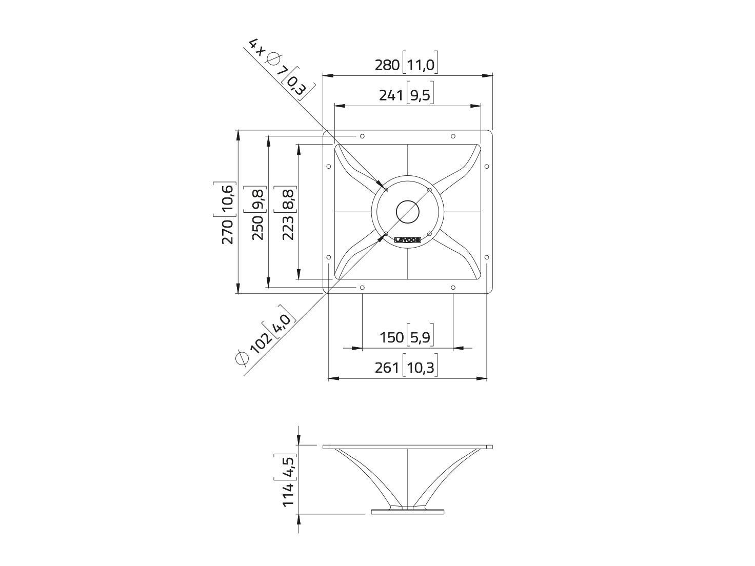

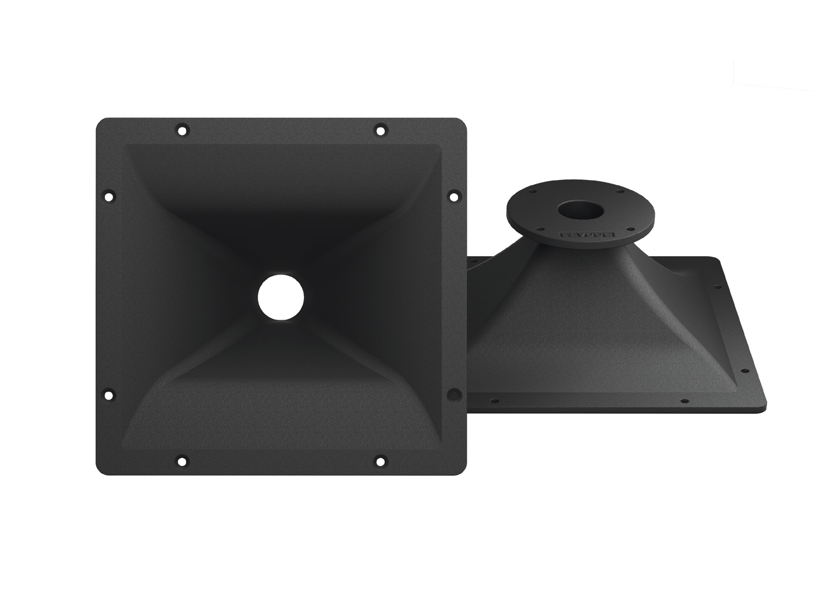

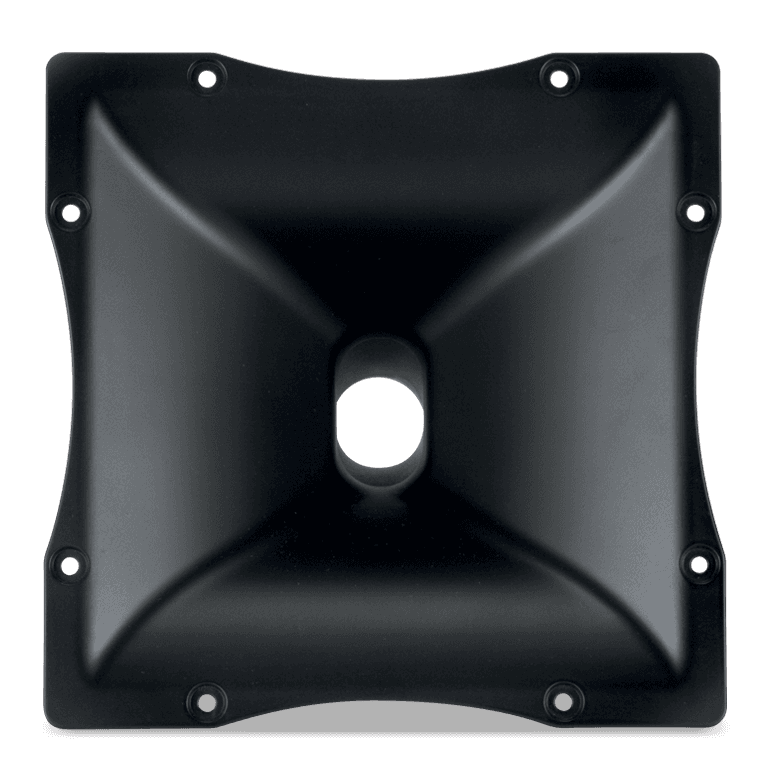

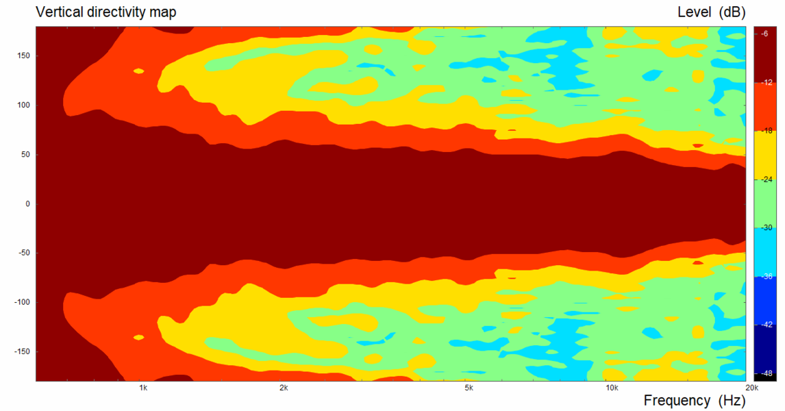

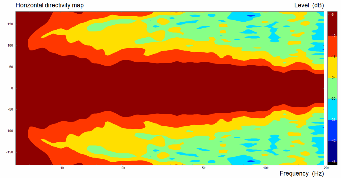

It should.
However, a more modern counterpart to the PH-94 is this LaVoce HD1403.
The polars are among the best I've come across with such short horns.
There are no hard-edged transitions inside the horn, which is usually a good thing > leading to better sound quality.
Reactions: 1 user

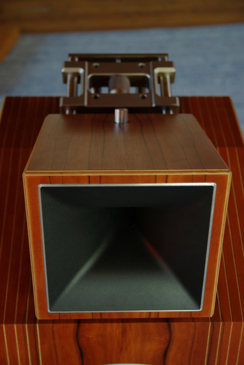

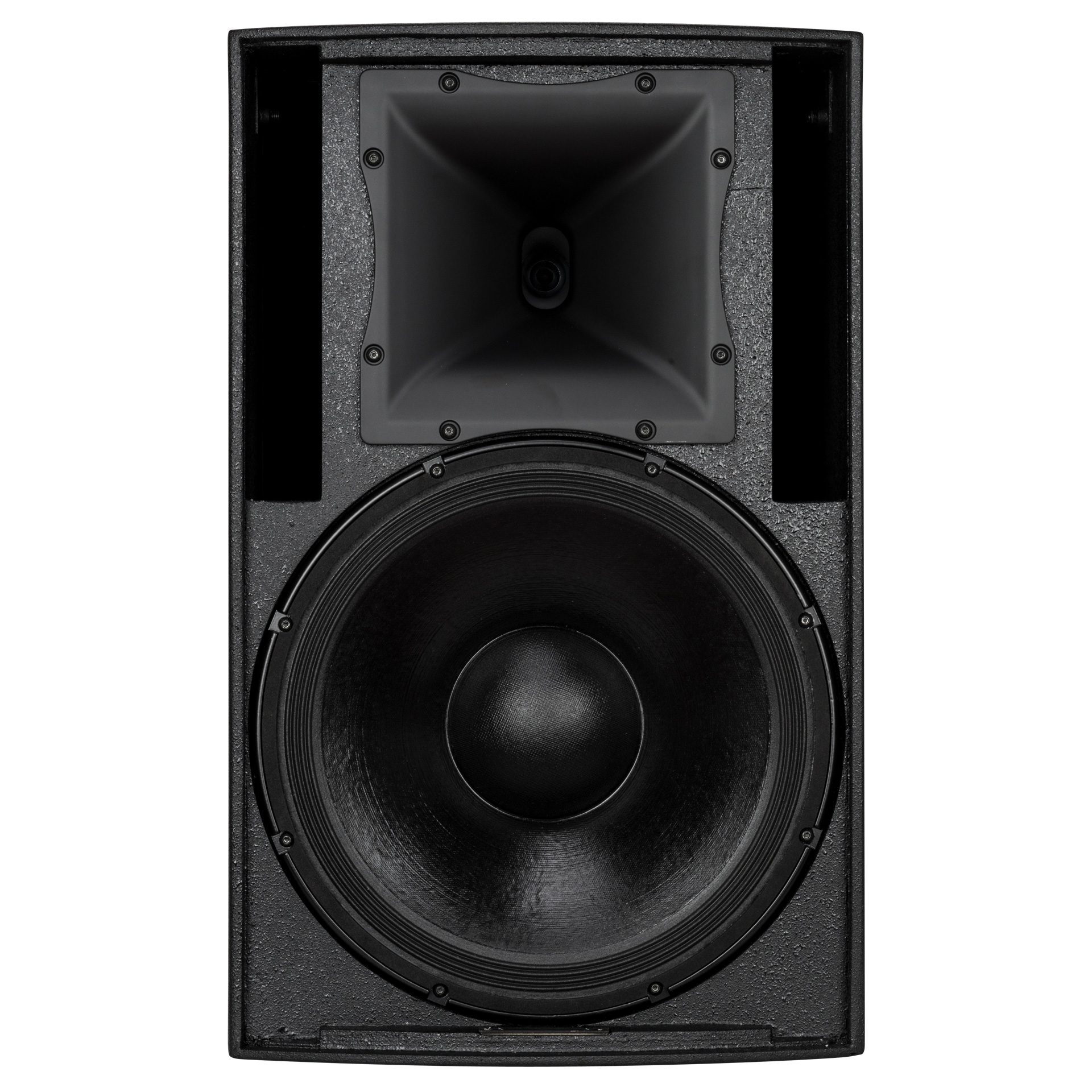

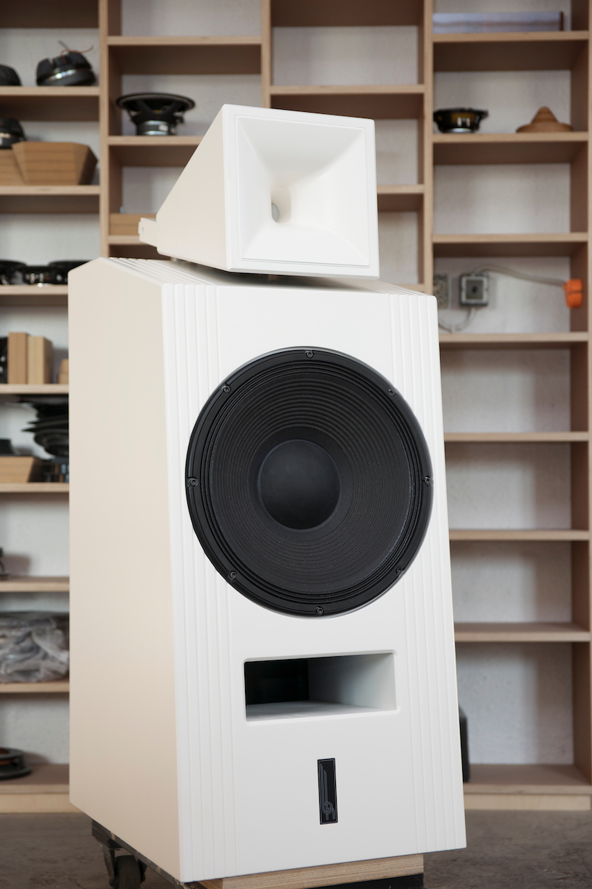

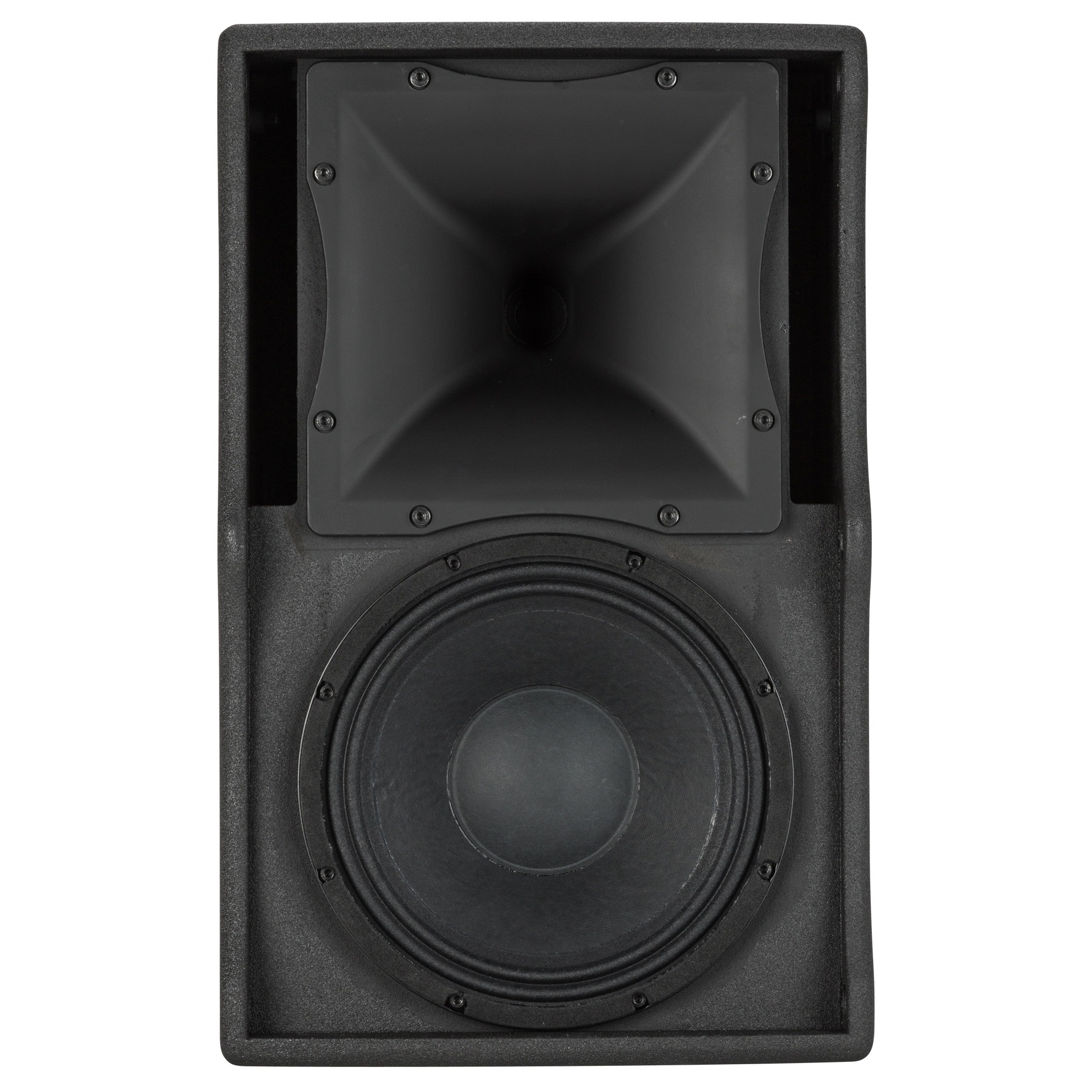

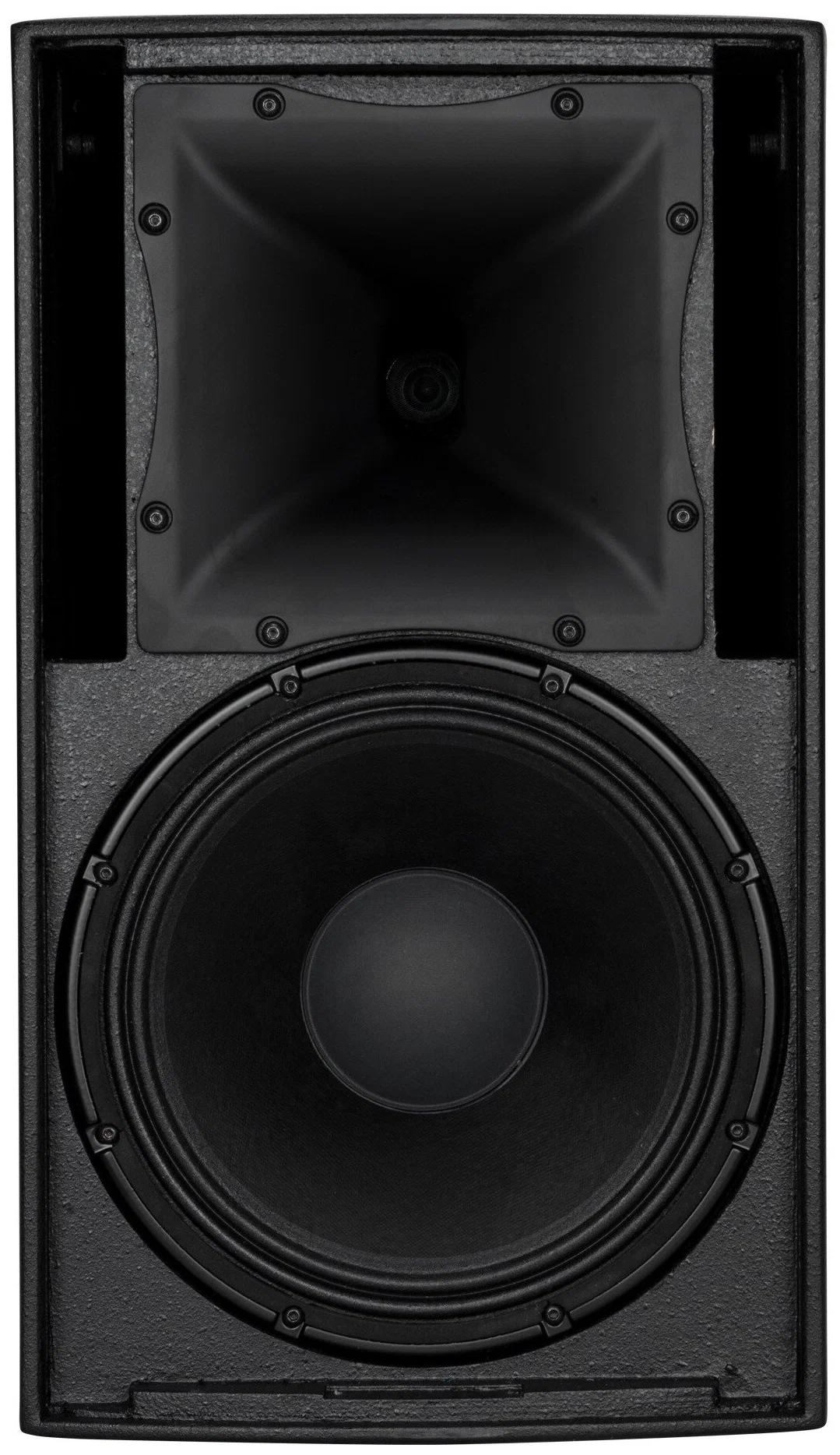

I would say that the RCF one does definitley have some sort of diffraction slot. It also looks very well manufactured. If it weren't a PITA to route I would have tried it many times.
What I wanted to say is that the "diffraction slot" on the LaVoce seems to be horizontal, which looks a little strange. And it can't be rotated easily because heigth and width are not exactly the same.
Regards
Charles
The RCF does indeed have a slot, it's short though, which helps reducing the nasties (astigmatism/distortion).
Hate those woofer cutouts too. Blumenhofer made them invisible.
