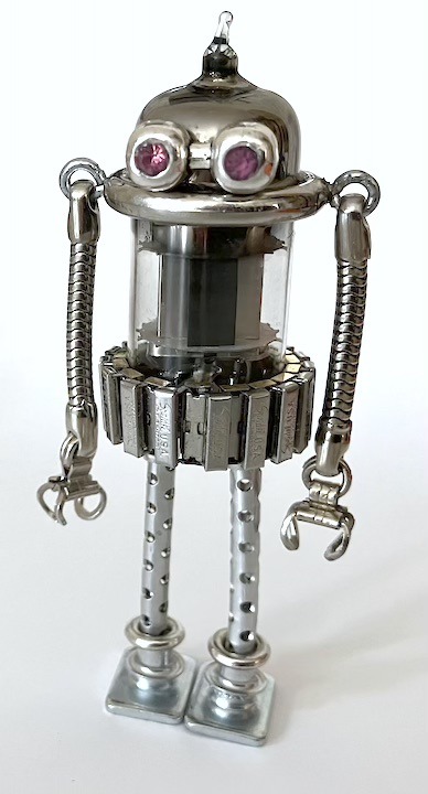

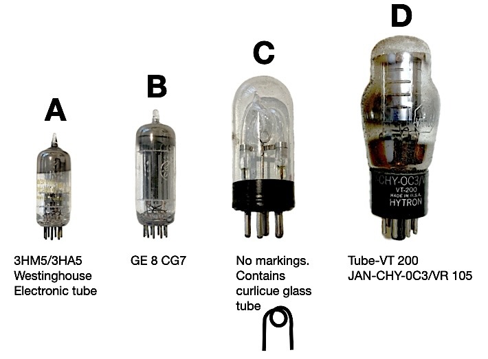

I would like to cut open these old vacuum tubes to use the glass bulb and a few of the parts. Er....I actually already cut one open and became concerned about the dangerous elements that may be used in these tubes. Questions: 1) is it just to dangerous to open these and use the parts? 2) Is there a safe way to minimize the exposure to the dangerous elements used in them?

C. Is a flash tube. A Noble Gas, Xenon perhaps.
D. Is a gas regulator tube; A noble gas, probably Argon. Perhaps the cathode is coated with a toxic material, I do not know.
I put those on amplifiers, and power them, just to make that pretty colored glow.
A and B probably have strontium or barium coatings on the cathodes. Don't put them in your Tea cup; don't lick your fingers.

The radioactive gas was krypton 85 and there's only a little of it. If it's present, the data sheet will specify equal striking voltages in the dark or in light. Guidance used to be that if these devices were broken, it should be done in the open air, and that you shouldn't breathe above the breakage. There were a very few other valves containing radioactive materials, but they usually carried a warning trefoil.
Thoriated tungsten isn't really a problem because thorium's half-life is so long that it's a poor emitter. If you buy a camping gas lamp, its mantle (that glows yellow) is the same thoriated tungsten.
Probably the most common hazard is the oxide coated cathode (barium, strontium) because it easily produces a fine dust. The earlier cautions about eating, drinking, and breathing apply.
However, according to Deketh, some valves improved their heater-cathode insulation by employing beryllia. That's very nasty stuff and highly carcinogenic if you inhale its dust. I definitely wouldn't open one of those.
Mercury vapour rectifiers should very definitely not be broken open. They need very careful disposal.
