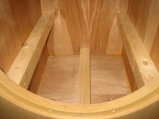

I need to kill some vibrations.
I have a subwoofer box that a local craftsman built from my plans for some dayton reference 12hf drivers (if in Columbus, OH, I highly recommend Edwin Daniel). It it designed for Q=0.707, volume-parts is about equal to 2.1 cubic feet.
I am now testing it out. Subjectively, it rings a lot when I give it a knock. The back, top, and bottom walls vibrate a little during test tone playing. I am not sure if the top and bottom only vibrate because the room is vibrating, tell me what you think of the bracing.
I tried adding stuffing, which definitely helps to minimize the ringing. Do you think I should add more bracing to the back top and bottom. The attached picture shows the current state of the bracing. I don't want to recklessly add bracing and make the box too heavy, any better recommendations than just nailing in a lot of wood?
Also, I am going to use one pound of stuffing, as I don't want to drastically change Q (new Q=0.65). Can I just have it all lying on the bottom of the box. Would you recommend stuffing even more?
Thank for your help.
Lee
First of all, rapping it is not realistic, as that puts in freq much higher than its operating range.
The most effective bracing is to connect pairs of opposite panels.
They become essentially infinitely stiff at that point, as the equal and opposite air pressure on each side cancels.
I don't think off center is necessary or desirable for sub boxes, assuming the first wall resonance is well above the sub operating freq range.
Since resonances won't be excited, the name of the game is minimum flexure, meaning minimum distances between braces and corners, and that is achieved by centered braces.
frugal-phile™
Just to be safe i'd still put them off-centre so as to distribute resonances -- you never know, it could get excited as a harmonic*, and off-centre pushes will actually kill the lowest panel resonance, where as a centred brace can actually encourage it.
But pretty much, flexure from air pressure (*which is itself enuff to cause the panel to resonate) is the biggest issue. A brace will help -- more intersting might be a pice of ready rod thru the cabinet cranked up enuff to pull the box walls in slightly.
dave

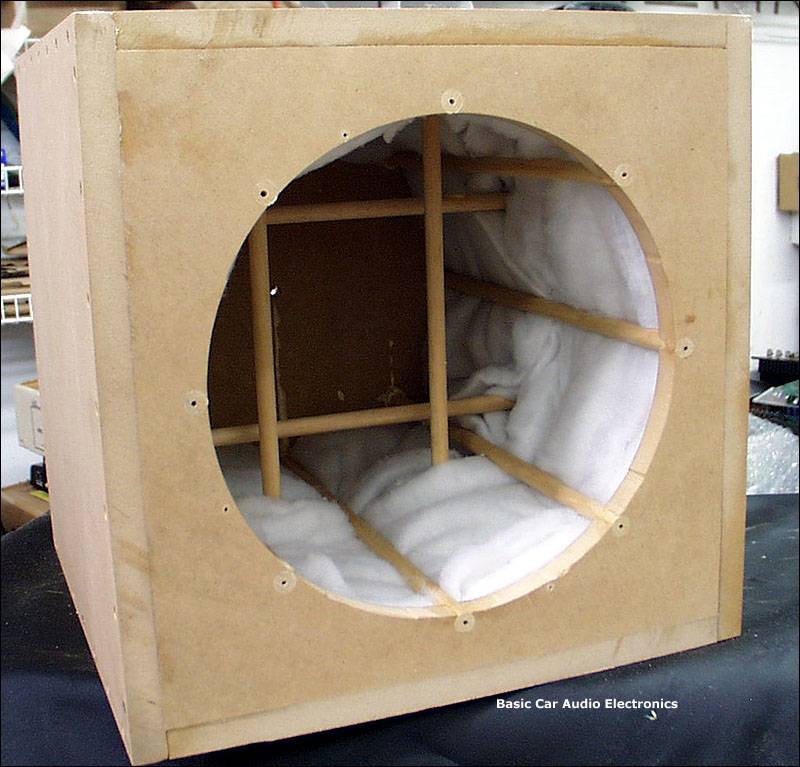

This is one example of a sub box with dowels used for bracing. The dowels were cut slightly longer than the dimensions and were sanded flush with the sides of the enclosure after the glue dried.
The holes in the dowels were going to be used to mount the woofer but they proved to be too fragile so I rotated the woofer about 15° and used T-nuts for mounting.
If the image doesn't load here, the following link will load it from the server.
http://www.bcae1.com/images\jpegs\speakerboxdoweltogetherwpoly.jpg
