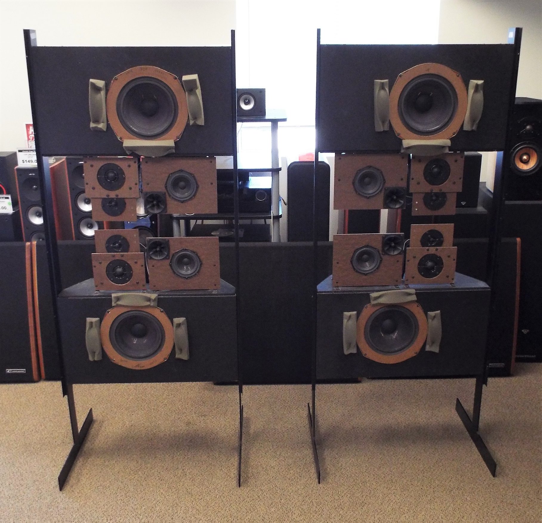

Hi ! plese forgive me if i take up this old thread
I listened to the DQ10 driven by Audio Research electronics many many years ago for the 1st time ... i guess it was in the 1978 ?
I was immediately hit but what i still think is the most fascinating effect with stereo ... a nice 3D soundstage.
As the drivers used are very nice but quite "normal" i tried to study the crossover ... without any real understanding of it
My question is the following
I have found a FR of the Philips midrange cone in another thread
https://files.diyaudio.com/forums/gallery/data/1935/medium/fr.jpg
It goes unbelievably flat up to almost 10kHz :oops::oops::oops:
In the DQ10 if i am not wrong is cut at about 1kHz ?
Why on the earth do not stretch it up to let's say 3kHz ? in this way just a very good dome tweeter would be needed to cover the remaing highs
I mean ... why not make a 3 ways DQ10 ?

The speaker was designed circa 1969-1970. Back then they did have available .75" tweeters which could give you good dispersion up above the 14440 Hz max you get from a 1" but the power handling wasn't there. So Jon Dahlquist (JD) decided on a piezo for the top end up to 27k I believe, and i 1" dome under that. At that time there were no commercially available ribbon tweeters AFAIK.
I think he got very enamored of the 2.5" dome mid driver which had to be cut well over 500 hz and well under 6k. so now 3 drivers over 1k. While you could find a nice woofer like the Cizek 1 8" woofer that could play over 1k, the problem is with a 10" woofer there is going to be a lot of IM distortion in the higher range. So the xover was set at 400, and the 4" cone was added.
By the end of the run, JD did go to a cheap JVC ribbon and turned it into a 4 way, which is what I did per the available plan. It resulted in a much better treble - more natural and acoustically neutral IMO, not to mention faster with more detail like harmonics coming through better.
Some folks got hold of the Sequerra ribbon and used that, never heard it, but it was a big step up from the JVC as I understand it.
Also for coherency JD chose a 12 db slope between drivers. Compare that to a very fine current speakers like the BMR Philharmonic - which has 18 db and maybe even a 24 db slope. Understanding, modeling, and implementation of Xovers is well ahead of 50+ years ago.
My mods were:
woofer: doping the paper so it would play lower Hz, and adding a pair of internal baffles to break up standing waves. Then I turned it on its side, with the woofer at the top side. I also integrated a cut piece of solid oak under both so they would be slightly angled up to the listening position, and appear to be a single square at the base.
I replaced the caps with the Solens - best reasonably upgraded priced caps then. Got rid of the coffin resistors, but left the inductors alone.
I oriented the drivers in a straight vertical line, spacing them at the 1/2 wavelength length on two very ridgid metal poles on the woofer cabinet above the woofer. The mid was actually in front of the woofer as it tapered off to the edge, and added more damping because you could hear the cabinet behind it.
I tossed away the entire metal frame in front of the drivers, and the cloth, but saved the two side pieces of wood with the baffles attached. I build a metal flange inside the wood/baffles to hold a new black fabric in front of the drivers , and a thin strip of wood below the woofers and painted the remaining part of the woofer cabinet a deep gloss black. Later I faux painted them a red marble/black marble finish which looked excellent
After a bit I realized that the OG baffle pieces were at a tuned distance, so I added felt to them and another wider flange piece for the short side (turned sideways the woofers were not centered. They looked decent but obviously home brewed, but they sounded well better than a stock DQ-10. People dinged them for visuals so I stuck them behind a curtain, and blindfolded my friend that sold them to me to 3 years earlier, and he was convinced that they were a pair of Verity Parsifal 1's because we had both heard them shortly before and I in particular were struck by them - they were $12.5k I believe then. I ended up buying a used pair of the Parsifals 3's about 13 years later. My 10's were 97% as good, I wish I kept them. Using the best amp I ever heard on the DQ-10's was the Threshold Stasis 3 - another piece I wish I never sold. I went through a lot of stuff since, and it wasn't worth it.

Yes, JD was a huge fan of the Quad ESL-57. The DQ-10 stock could player louder and deeper. It could not pass a test tone as cleanly.
The DQ-20 I believe was not totally JD's design. Its a good speaker, with upgraded parts today well worth having, but after the Home Run that was the DQ-10, nothing was ever going to top it.

The 20 was not a match for the 10 sonically. Veiled, homoginized.
The OG dome 1" tweeter and piezo are very well replaced by a solid ribbon tweeter, there was a plan, and it cuts the xover complexity and load on the amp.
The Philips midrange at a 12 db slope would blow - that means -24 db at 100, and -36 at 50. Good luck with well recorded bass music at realistic levels. Pull up the sheet on it, bet it behaves badly under 400 Hz.
You'd be much better off with the drivers in the BMR Philharmonic - Raal ribbon, BMR mid, Scanspeak woofer - $1200 kit, another $450 for the flatpack. Blows the stock DQ-10 out of the water. Even better than my modded DQ-10's.
Woofers that can woof at 32 Hz in a sealed cabinet do not produce good mids into the female contralto+ range, not in the least if you are talking purity.
