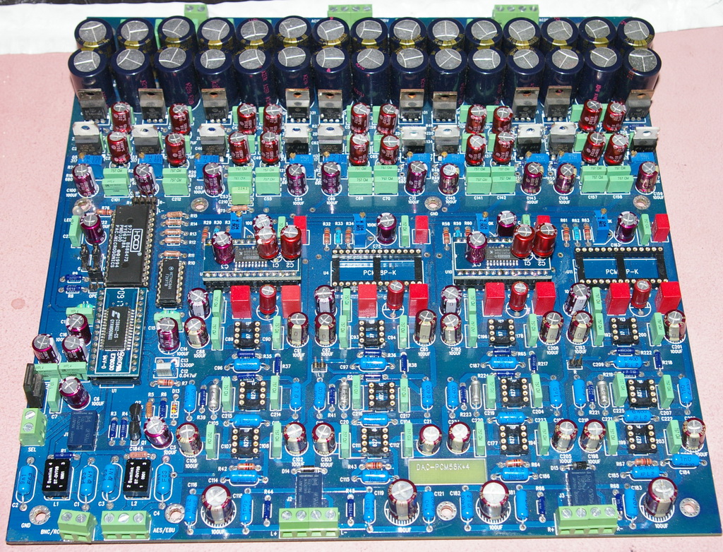

A few days ago a friend of mine bring me a DAC with four PCM1704, PMD100 HDCD decoder and CS8412 receiver to listen. This DAC was bought from Analog metric..
The DAC have one S/PDIF and one AES.EBU input,
I made two power transformers but the DAC doesn’t work.
Any one has experience with this DAC?
Any suggestion?

Hi, check schematics of PSU part for this DAC. I have another model of DAC from this firm and found that they made very strange shematics in PSU - they use the same type of regulators chip to obtain (-) and (+) voltage. Thus, (-) voltage they derived with regulator placed in path to common "earth" on PCB. You need separate second windings (not common earth connection between them) on transformers for EACH voltage on PCB connector, even with eaqual values. After your previous attempt and before new connection, you need check all diods in PSU - some of them already could be broken.I made two power transformers but the DAC doesn’t work.
Thanks pionik
I just received the schematic diagram and i will check everything from power supply to output stage.
If some one made an improvement to this DAC i would like to know more about it.
I think that this DAC has more to show me after I will make him to work again

its not such a strange way to use floating regulators, as long as they inform the customer. in fact myself and a friend are utilizing the same technique with our dac psu. we are doing it for reasons 2 fold. the very high quality linear tech lt1764a regulator does not have a negative pole counterpart of the same extreme high quality, low noise and current capability and we can buy in bulk all the same chip to use throughout all 10 regulated voltages, simplifying layout and allowing bulk pricing on the regs

Finally i manage to fix this DAC with the help of a friend of mine but i am disappointed. A lot of components for nothing.
Will be better to make another one with this good quality parts.
I have the service manual for Nakamichi Dragon and I intend to inspire from them to make another DAC with 4x pcm1704 with HDCD decoding and 192khz support.

I made more tests to this DAC and none with good results
24\96 don`t play well ,after a few seconds he start to loose digital signal
and the output stage is awful. I will try another time with another output stage.

The PMD100 will cripple the sound of any dac. I've done enough comparisons with conventional DF chips in otherwise identical dacs to say with conviction that the PMD100 is an AWFUL chip, sucking the life out of any dac's sound. Makes things sound totally two dimensional & artificial. PMD200 isn't as bad, but I generally regard "HDCD" on a dac unit or player as a warning label.

My frustration is about the 24/192kHz sample rates. The DAC don`t play this type of signal. It plays well up to 24/96 kHz.
