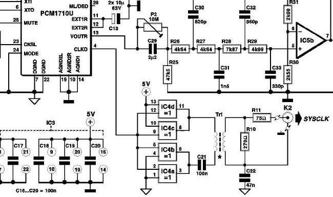

Do you mean that slave/master config is just a matter of interchanging the VCXO with XO and connecting the TentLink?
Yes, and re configuring the jumpers on the XODac. Just tp be clear, you are not "interchanging" VCXO and XO. You are substituting the VCXO in the XODac with an XO of the same frequency. On the transport side, you are substituting the XO with a VCXO of the same frequency.
Do you mean that slave/master config is just a matter of interchanging the VCXO with XO and connecting the TentLink? Then why did I go for another set of XODAC and XO 3.2?
Yes. I have been making this clear for quite a while. Never mind about the extra modules, I'll solve that for you.
best
a few questions.
If my dac has zero word clock input and output. and I have an external interface connecting pc (usb, 1394, wahtever) and does that mean this dac has to be slave? Since the dac has no word clock ports, it must use PLL, right?
likely, unless the DA has a sample rate converter on board
