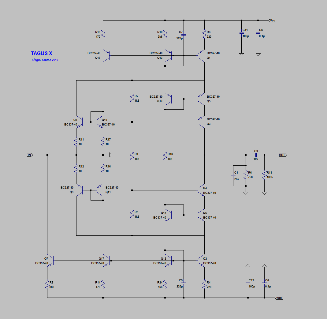

. R13/C2 looks potentially problematic and may make it prone to oscillation with inductive source impedance. This can usually be fixed with an input shorting cap, but point is to be aware of the issue so that you know what is going wrong and why in case of problems.
The bootstrapped cascodes creates a loop that is prone to oscillate at rf , R13/c2 is for adding loss at high frequencies, normally I have good results with this, in theory the c2 should be connected to positive rail, but in that way the PSRR at high frequency get worse.
I have see a lot of bootstapped cascode designs without any means to stop this oscillations to occur . But that is not much advised.

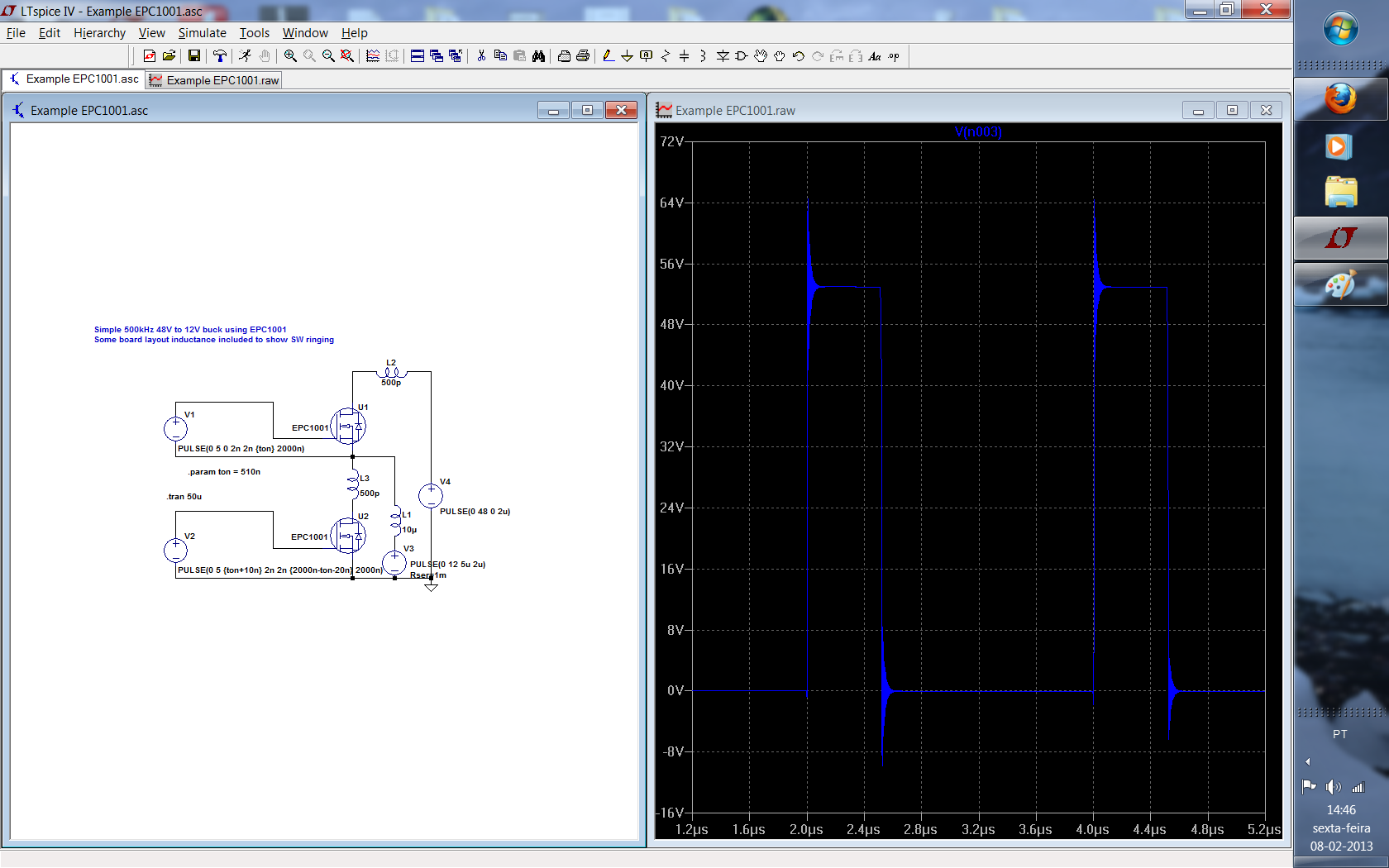

Speaking of parasitic inductances and Just for curiosity , the most problematic situation that i enconter was with eGaN FETs , this type of FETs dont even have leads and have several souces and drain connections in parallel to lower to the extreme the parasitic inductance, at the speed they can switch the slightest inductance can cause ringing with enought voltage to damage them , especially in the gate that have maximum gate source voltage of 6 volts.
simulation with pcb traces parasitic inductances , in power switching is a must.

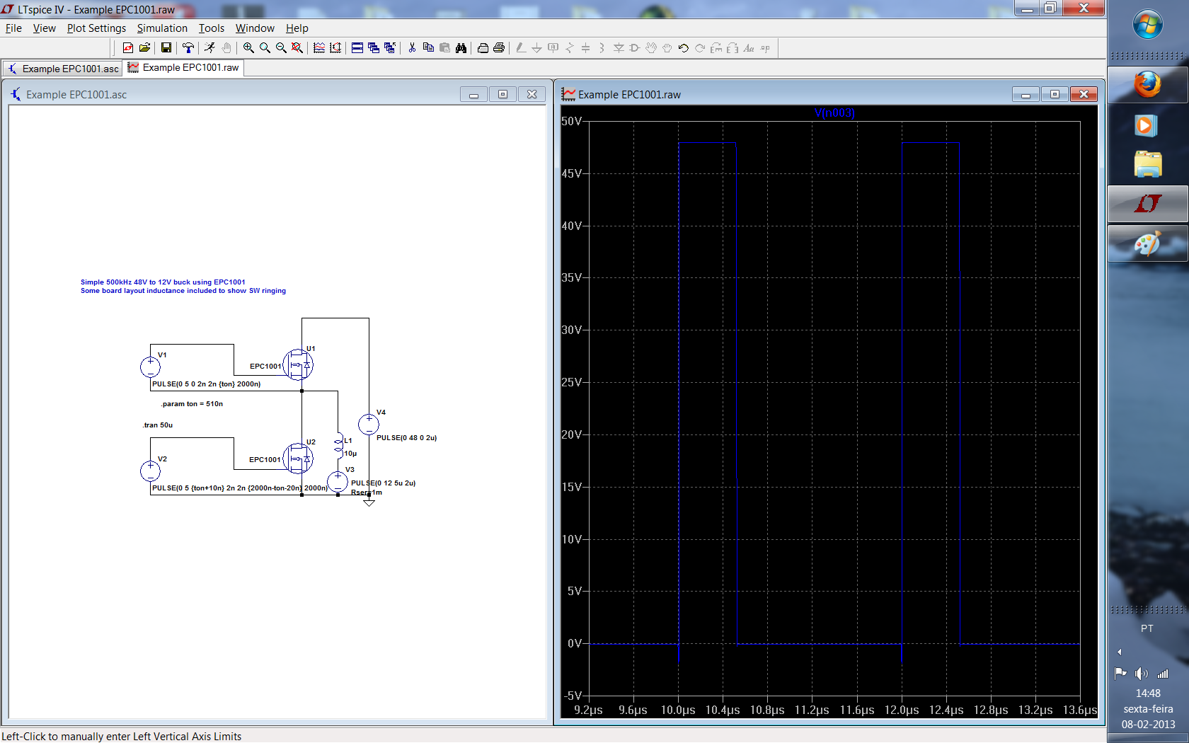

just for show how even a 0.5nH (a to220 lead has 12 nH of inductance) can have impact, i post this circuit the first without the drain parasitic inductance (500pH) the second with the added parasitic inductances, this is a extreme example and i just post it here for curiosity, in non swithing audio aplications this is not that bad .
with 2nH of parasitic the switch node reach 75 volts because of riging.
simulating this circuit without the pcb trace parasitic inductances can have drastic consequencies.

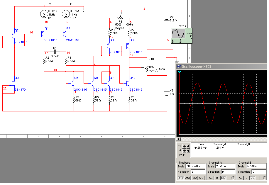

That is a circuit that uses floating power supplies , first I think you should check this thread to grasp the concept, then if you still need I will explain the rest. Dont forget that the current that is injected to the circuit by the I1 will have to return to ground and the only path is by the output resistor.
