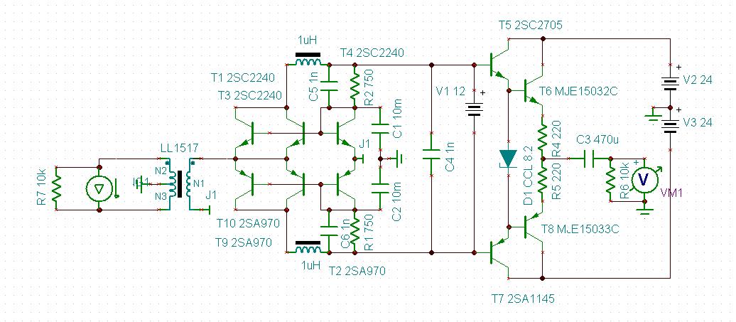

OK! thanks for your input. The discrete circuit has far fewer active elements than the two IC chips in the other circuit.
I have now put the balanced version into the system and it certainly does it´s job to suppress the last bit of hum. Hiss is also extremely low so at insane volumes you think that the system is not on at the listening seat. Ear on my 95dB sensitive speakers the quality of the hiss is very soft with no aggressive tendency in the highs and no flicker noise. 1/F corner is very low too so there is not that typical low volume rumble that tubes and JFets can have. I knew that the BC327-337 are very good in this regard but this is even more quiet then our Pardise stage.
I also think that the sound has improved further. The size of the stage, focus, clarity and dynamics are amazing. Since the hum is gone the bass is now very articulate and powerful. Still there is this airy, low distortion quality. I am quite astound how well the Nichcon ES electrolytics work without any foil bypass. The next step could be to build the circuit again with medium power BJTs like the BD139, 140 and make a matching RIAA stage. I tried though several times medium power BJTs at the input and i always preferred low power trannies.

As I understand these circuits, they are current conveyors, so there isn't any voltage gain except what ever is produced as a result of the I/V resistor choice.
In my circuits, the transformer is acting as a current conveyor, since there is virtually no voltage on the primary or secondary (only a few millivolts).
The output of the version i build is a good constant current source with a lot of drive capability. There is plus-minus 32mA on tab. Bandwidth is high too so i think to make a phono stage a transimpedance RIAA plus buffer is enough. I would run the input stage then maybe on 20V and the buffer needs his own supply when we want the input stage to be run floating. We could run the input stage on a plus-minus supply also but i am not sure if that sounds better.

We decided not to call the last circuit i build balanced. It has the same gain then the circuit before that had the bases connected to ground. As i told you it has the ability to lower the hum though because input and output ground are separated by the 3 Ohm resistor.
Well, then it's still a great idea. Bravo!
Joachim, I took your idea and applied to my 2SA970 IV converter. Distortion went down a little (0.0003% at full output) and the very low frequency peak disappeared. I connected the negative side of the secondary of the transformer to the union of the two emitters in the current mirror. (J1-J1) Thanks!
