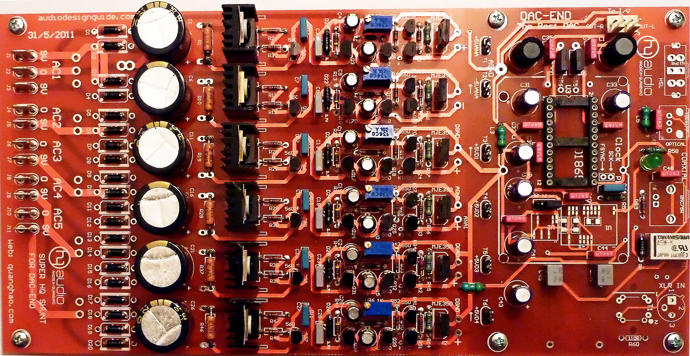

Hi all,
I'll use 5687 and E182CC tube, so I have the following questions:
- filament: linking J1 seems the heaters are powered wih 12.6V, so what secondaries of R80-36 transformer should I use? more simple, what colours?
- anode: using 4 rectifiers and R80-36 transformer, what secondaries should I use 0-230 or 0-260? in parallel? more simple, what colours?

hi!
if use 5687 or e182cc use 12Vac for filament
use 0-220Vac for shunt!

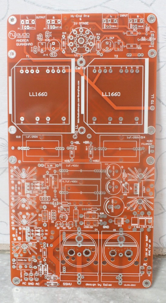

To day i have some PCB IV LL1660 , if you like please sen to me pm!

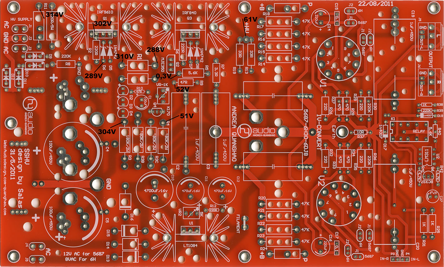

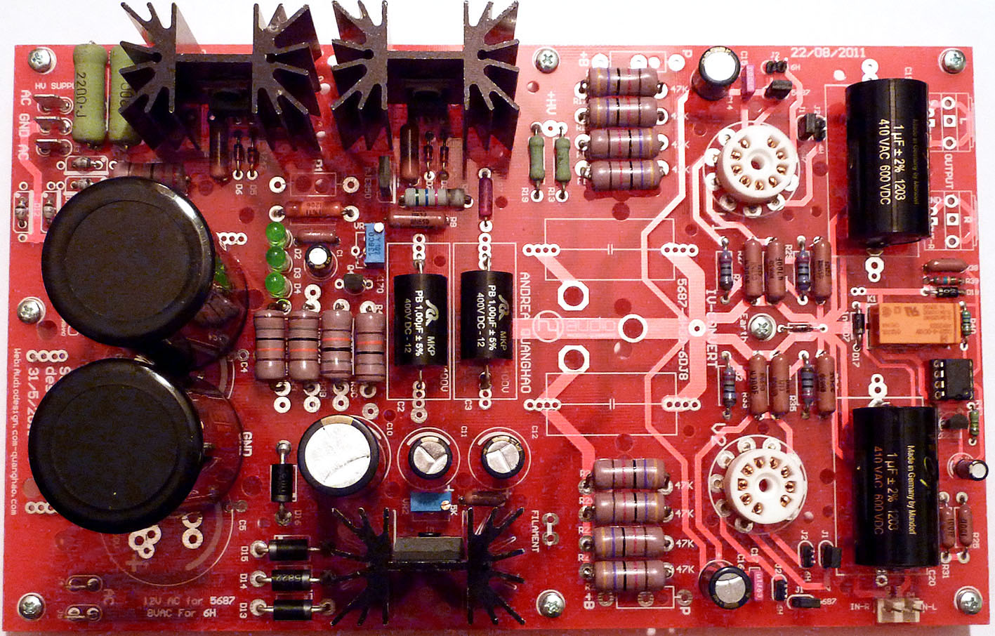

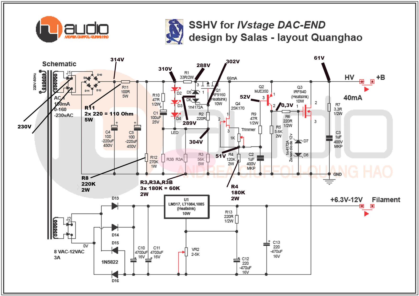

Problem with the power stage circuit
Hi Quanghao, I have a problem with the power stage circuit in the 260V SSHV specifically, since there is only the 61V output.
I have attached some pictures where you can see the component values ​​that have been used and the voltages obtained.
Thanks.
