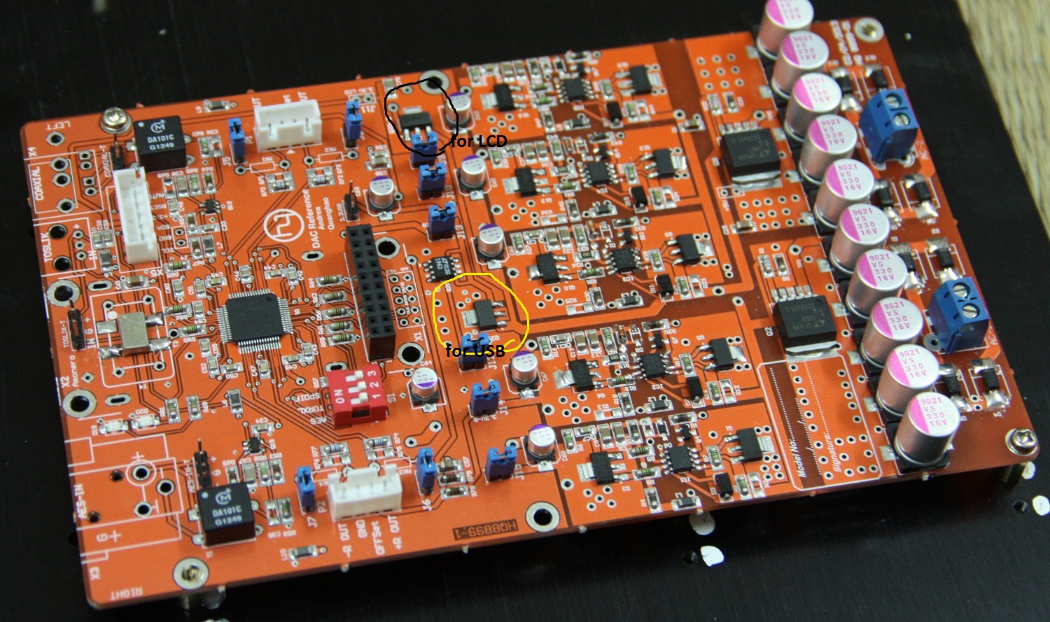

I had to use a lt1963 for USB, you just plug the jumper for it!

Yes!Is it possible to achieve better quality with this DAC, than for example, highly priced hi-end cd player?
1. This DAC uses the ES9018, that's one of the best converters
2. all the power supplies are separated shunt power supplies
3. high quality components, very good crystek clock
4. Amanero USB interface
5. different I/V converters and output stages can be used to your preference: standard opamps, Audiodesign tube output, Broskie unbalancer.
6. Can play native DSD (SACD)
7. Nice orange PCBs
