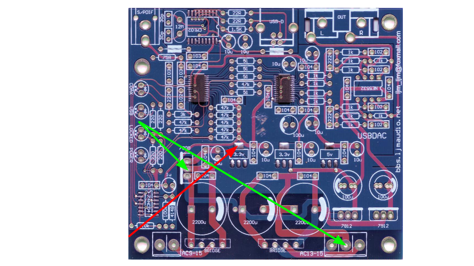

Attached is cheeta's x-ray view of the board. I've highlighted the output of the 3.3v reg with a red arrow and two of the ground locations with green arrows. I measure a resistance of 57 Ohms between the point with the red arrow and either of the points with green arrows (one of these is the heat sink of the 7809 reg). It would be great if you could tell me what you measure.
In looking at that pic I've realised that I haven't removed the large caps taking care of the PSU. I don't think they're implicated but I'm pretty new to this and they're the only original caps left so I'll try taking them off tomorrow. (I changed the majority of the caps after the board failed but without success.)

Hello,
I measure a ohm resistance of about 477 Ohm between your marked points. The red arrow points on the Vout tap of the regulator.
57 Ohm measured against ground looks indeed like a short circuit.
Now here´s the deal: next to the voltage regulator you will find a 100nF capacitor and a 10µF capacitor. I would try to remove both of them and also measure them, if one of them is damaged ( such a error is very rare but not impossible ).
If you have removed both capacitors but can still measure this low resistance, the regulator might be fried and needs to be replaced.
If you´ve already removed the regulator and can still measure this resistance, we need to have a closer look at the components around Pin 13 and 14 of the 74HC04
The 1N4148 Diode, the 100k resistor, the 100nF capacitor and the 1µF capacitor, if you can still measure a error.
Ofc this regulator also feeds the CS8416 at Pin 23 and you need to check the components too:
the 47k resistor between Pin 23 and Pin 20, the capacitor between Pin 23 and Pin 22.
Like I mentioned before, we´re dealing with quite low voltages in this device and it is hard to believe that maybe one of these components is damaged but at least I would suspect the regulator to be fried. And I sure hope that the ICs itself are not fried too.
How exactly did the board die ?
Best regards,

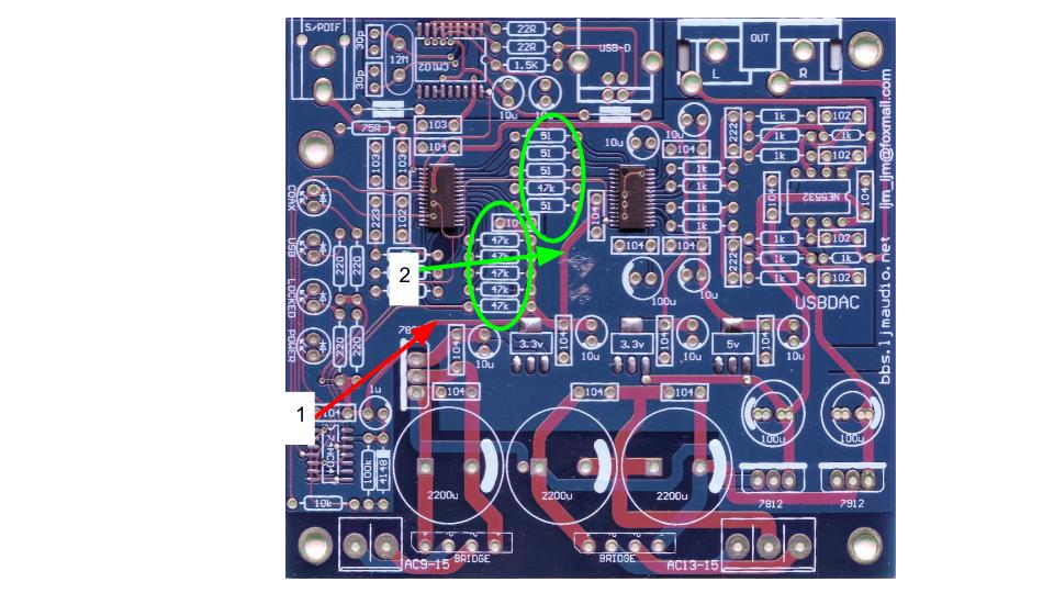

Hello,
now comes the tricky part. I under stood right that though you have removed the voltage regulator and the other components, you can still measure this low resistance ?
Ok, maybe one of the ICs is damaged, or even both but there is a tricky way to find out:
Follow the connection from the Vout, to the 74HC04 and make sure to use a sharp knife, in order to interrupt it ( but make sure that you chose a good distance from the IC so you can still have a chance later, to reconnect the lane with solder ! ).
Now you have no direct connection to the 74HC04 and assuming that you have soldered a "fresh" regulator on the PCB, we can measure the resistance again.
If you still measure this low resistance, we need to do the same, interrupt the trace which leads to the CS8416, Pin 23. ( Also make sure that you chose a lane where you have again the possibility to reconnect the cut again ).
If you measure a higher value now, you might have found yourself a damaged CS8416.
This method is not very clean but it can help to find out if the ICs are damaged.

Hello again,
Thank you for your suggestions. I've removed all of the resistors that I think are downstream of the regulator but to no avail (including those circled in the attached pic).
So, I then resorted to your trick of cutting the tracks. First I cut the one labelled '1' with a red arrow. The resistance to ground remained unchanged (57 Ohms). Next I cut the one labelled '2' with a green arrow. Finally that had an effect in that the resistance to ground from the regulator output is very high
I think this means the problem is with the CS4398 so it's new DAC time?

Hello,
it seems that your CS4398 is fried indeed Well, if you have a closer look at the full schematic of this DAC, you will notice that the circuit itself is not that complicated and the only component which could fail are either capacitors ( they might blow up ), resistors ( burn and cannot be measured again ) or the ICs ( voltage regulators, decoders etc. ).
Ok, in theory you could replace the CS4398 with a new chip if you have the tools to desolder the chip. You could eg. request a new CS4398 chip for free from Cirrus Logic, as an engineering sample.
But maybe buying a new ( empty ) PCB and using new components might be the better deal.

Congrats Gorgomat.
I think I will approach building the output stage differently, by building it on a separate board. This way I do not have to install any of those parts on the bare (ICs soldered) PCB that I ordered.
I also plan to omit/bypass both the CM102 and CS4016 and tap directly into the i2s inputs of the CS4398. The i2s pins break out nicely to some resistors (which normally go to the i2s output of the CS4016) so it should be quite easy to make i2s headers there.
I am also considering bypassing the onboard power section by building my own regulators, but maybe the trick you mentioned with the 1200ohm resistors is enough to clean up the power. We'll see.
Still waiting for the board.
