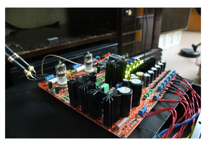

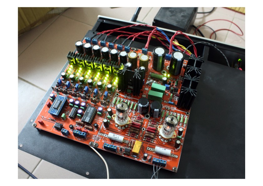

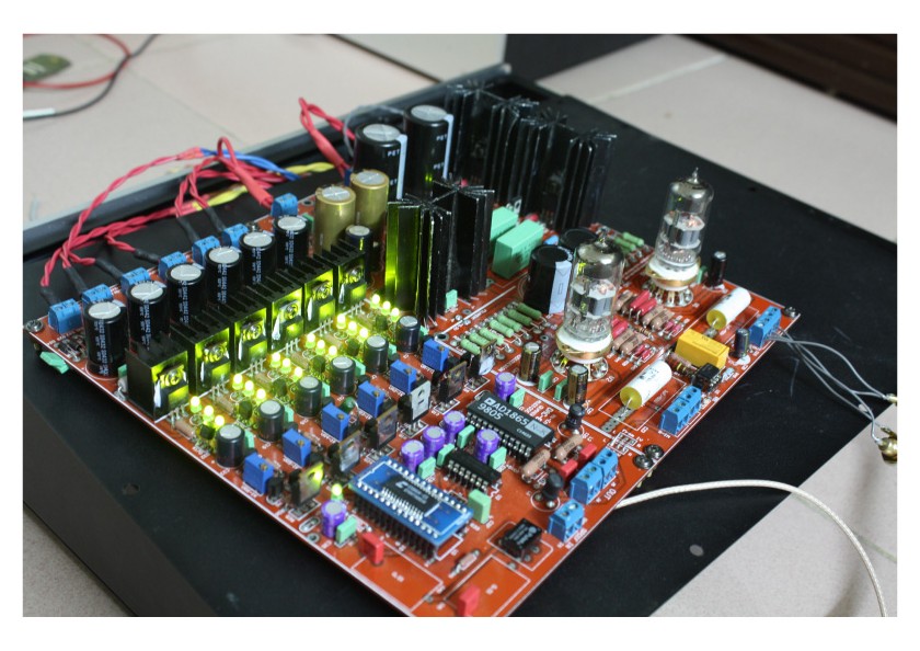

I have Toroid Transformer T120 120W 0-200-260-300-360V(100mA)x2 6.3V(2A)x2 5V(2A), can use 6.3 + 5 =11.3V for filament or is it too high ? Also, can we replace R11 470Ohm 5W with power inductor 10H ?
Regards
You can use 0-200 /100ma for HV
A. About the HV
1. 200 x 1.28 = 256VDc, Use R11 in board IV down 220 R/min 5W, For tube 6h30Pi
2.If you use Chocke change R11, it is ok,
Thus IRF9160 will receive approximately 40V, it will be hotter. You should note heat for it, because I total about 90-99mA, if you use 6h30 or 6h6.
6dj8 is no problem
B Filenment
The AC for filament , it is Hight
EX: (11.3 x 1.4) -2=13.8V, We need 6.3VaC. So 13.8- 6.3 = 7.2V, through Lt184
about 10.8W, heatsink is very hot, and need biger!
You can not use it,
Filament need 7- 8VDC/ min 2A for tube 6h6, 6h30
