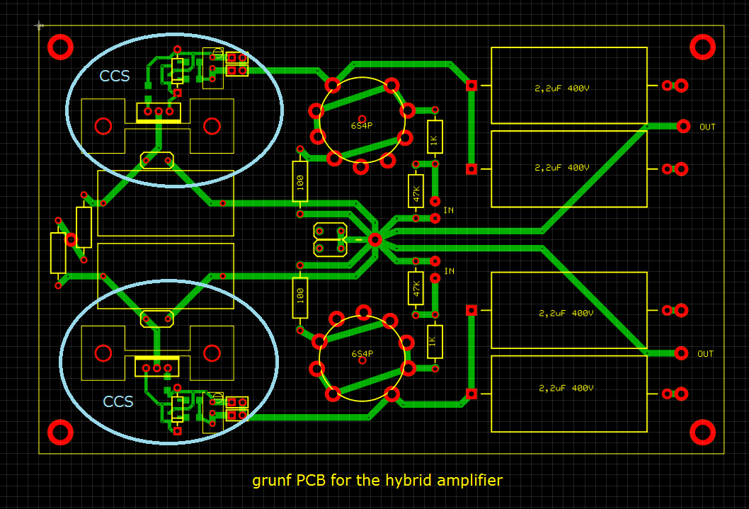

Ok, so, friends, please disregard my last upload #8261. I remade the boards for the tube output stage, with spacing fitting following BOMs. If possible i would ask a moderator to cancel previous uploads.
Schematics remain the same.
These 10uF Wima caps are huge, and so with more space perhaps you could fit some boutique cap. Now there's only 1 filament inlet, with the shortest path. I'll order them myself shortly.
Please let me know in case of further discrepancies.

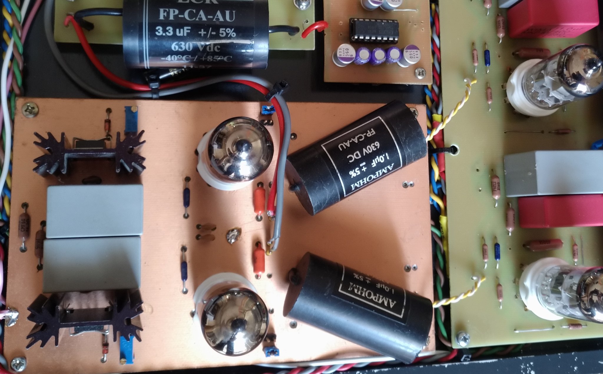

You must correct your PCB, I used the same ones I made for my hybrid amplifier with some corrections. It's important that you see how they should look. You have to miniaturize the CCS traces, I made them partially in SMD to make them as small as possible.
In this case, the tube was 6S4P, but it is important that you get an impression of how the PCB should look. Otherwise, the scheme is the same, instead of 47K you put Riv and a film cap in parallel with it.

Hey Grunf, thanks for your valuable input. Just for me, why is important to miniaturize CCS traces?
