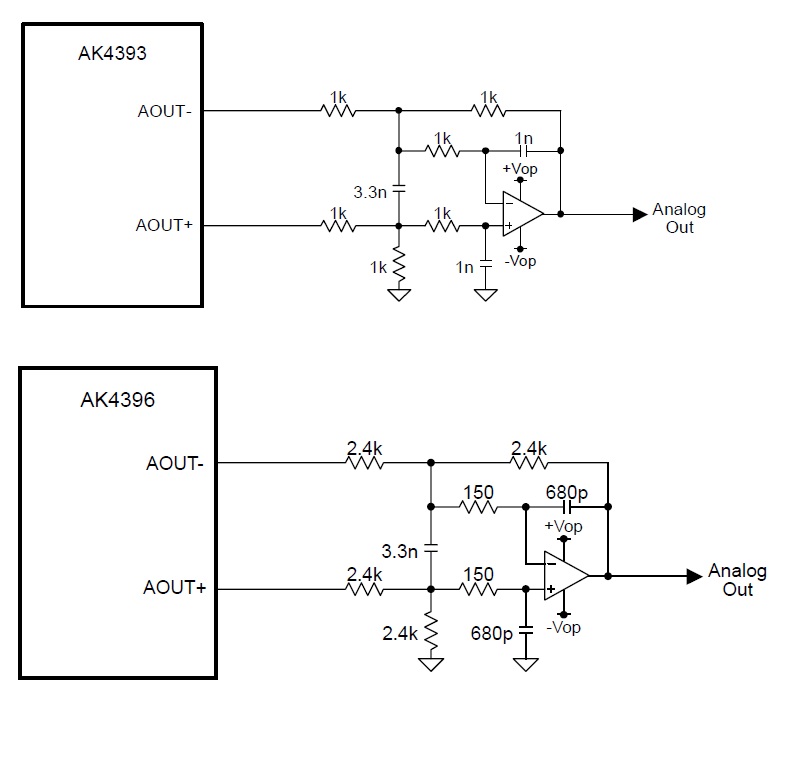

I think I've found why the AK4396 version sounds tonally unbalanced...
I was reading the datasheets of AK4393 and AK4396 and the sample output stage (which incidentally is identical to the one of this board...) and they've the same topology but different resistors and caps values...
So for the two DACs a different LPF is required!!! :(
Then I've checked the one of AK4395 (identical to AK4393 one) and AK4399 (different values from AK4393/95 and AK4396).
So this kit should have different LPF's resistors and caps for the two chips...
Obviously I've found this information the day after I've ordered PRPs for two boards... (if someone with AK4393 version is interested PM me...I'll make a nice price ;) )

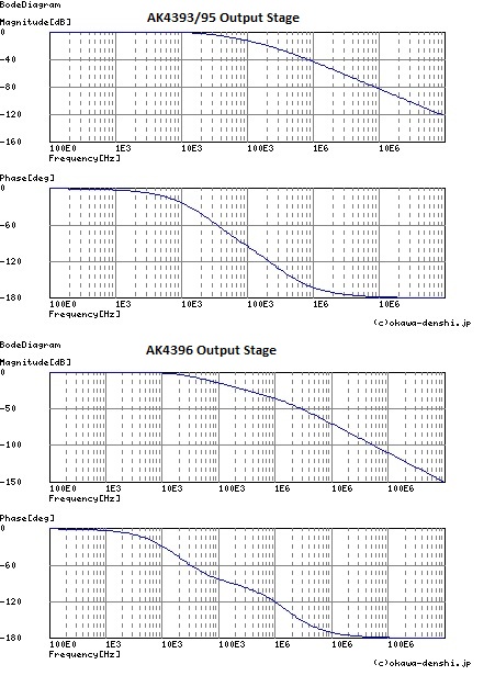

I've attached the two output stages and, since to me they're a Sallen-Key filter, two graphs that shows the difference (made with this calculator).
The AK4396 outstage is clearly more rolled-off...

That is because the level of remaining ultrasonic noise with the AK4396 is so low that it really doesn't need any analog filtering.
I don't think so.
IMHO the LPF filter is there not only to deal with ultrasonic noise but also to adjust the frequency response of the output if the DAC, by design, don't handle it completely.
As a matter of fact different sources (PCM or DSD for instance) needs different filters to achieve the (quite) same final frequency response.
And since different AKM DACs are coupled with different LPFs to achieve the same frequency response it can be deduced that the DAC output frequency response is different....
it doesnt matter what the figures say...if it sounds good .....:)
To my ears it matters... sounds good but unbalanced... ;)

I don't think so.
I think that you will find the corner frequencies of the filters are so far out of the audio band that there will be no measurable difference to the in band response, or possibly even a flatter extension at the top, without the filter. It is just for the ultrasoninc noise of which there is very little with the AK4396.
Why AKM bother to specify different filters for different DACs?
We agree about ultrasonic noise, it's just a fact, but since there's no noise to filter why the AK4396 filter is more rolled-off?

I suggest you to mount it as is but socket the four DAC's output resistors with a SIL socket.
In this way you can, in every moment, pull out the resistors and plug in wires to trasformer or output caps while leaving the IV/LPF functional when resistors are plugged in socket.
If you buy the socket from the link buy also one packet of solid elcos for AK4396 AVDD, and CS8416 VA and VD decoupling...
Since you still have to assemble it I would buy and mount the proper resistors and caps from AK4396...
