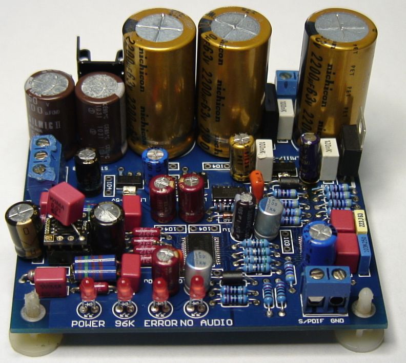

DAC 2496 (AK4393) DAC KIT With CS8416+AK4393+5532
Had a few beers Hic!! but I think they they might help. :drink:

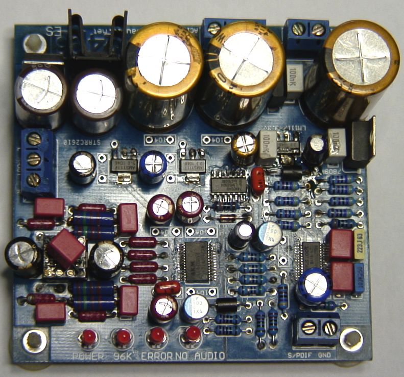

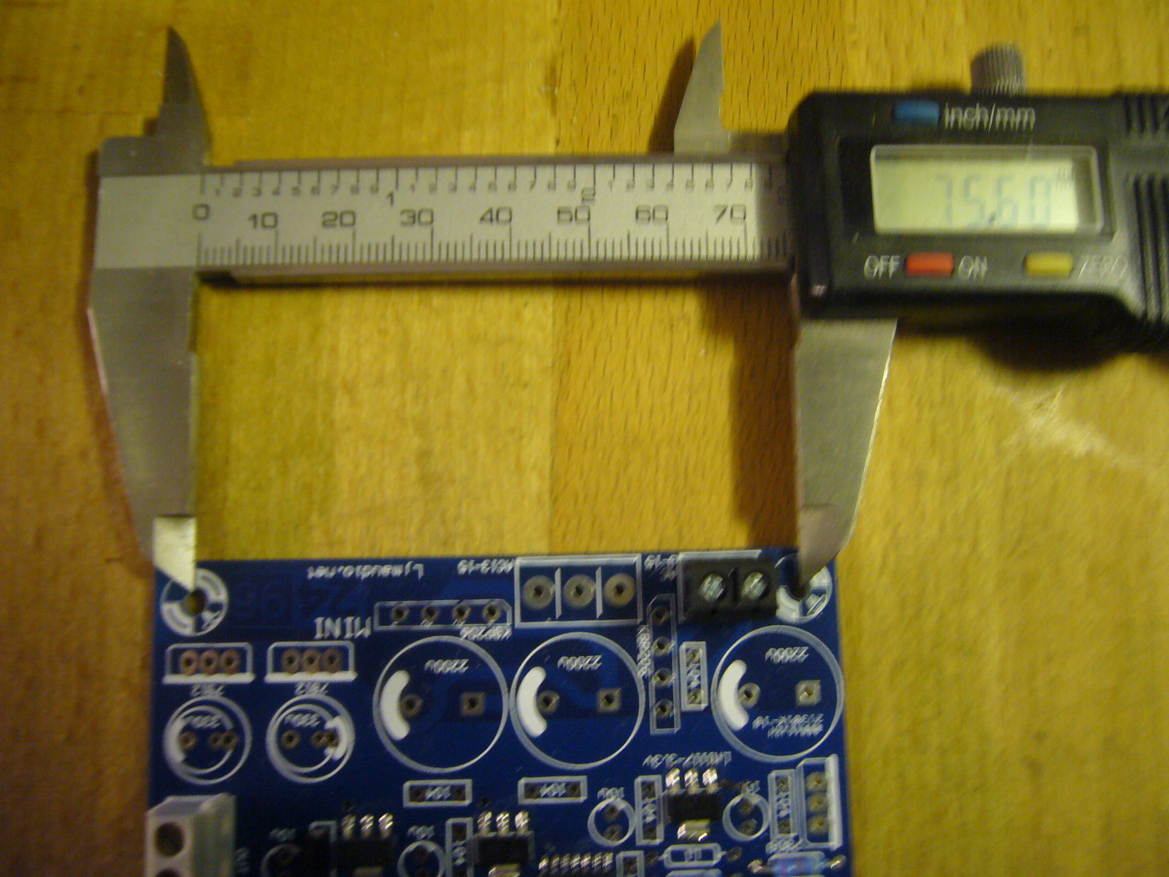

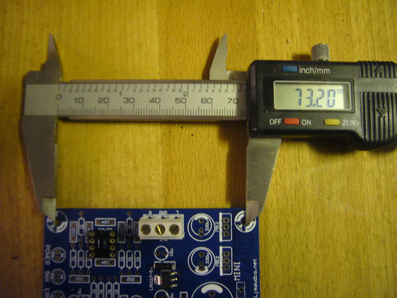

Hello everyone,
I've ordered one of these boards and wondered if anyone has the dimensions of the mounting holes to hand. I'd like to get on with bashing some holes in a case whilst I wait for delivery.
Tony
I measure 72.7mm one side and 75.7mm on the long side (with the LED's).
I would wait for the board though, yours might be a different batch.
Bill

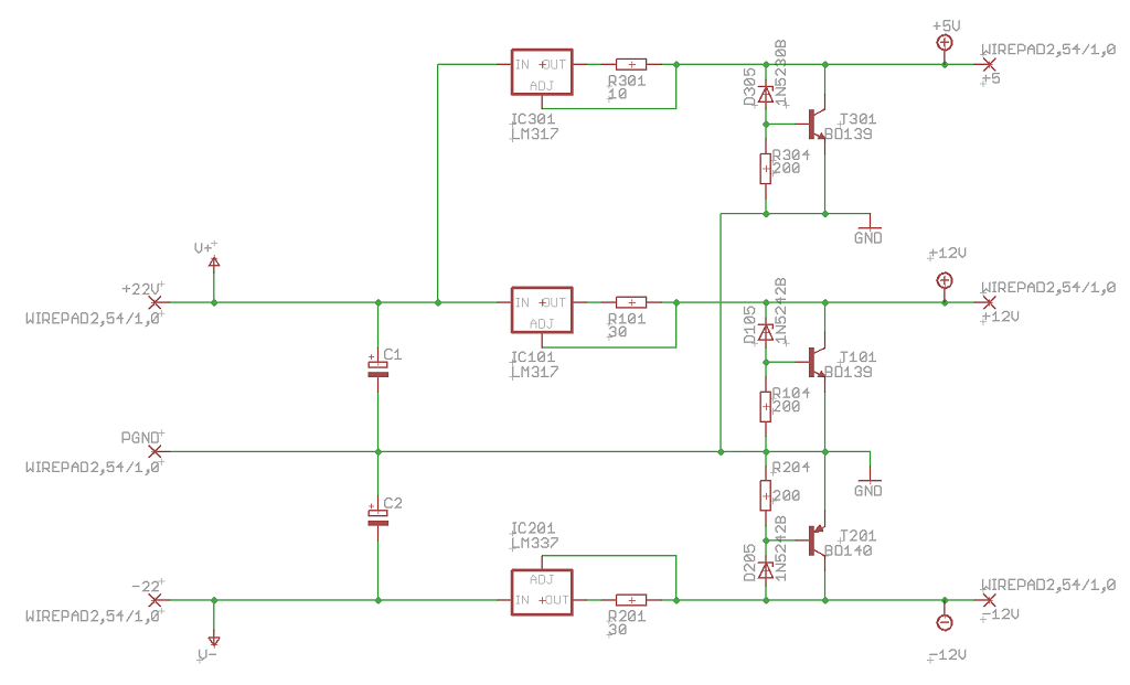

For analogue +3.3 part of CS8416 your shunt has been implemented, I removed completely U9, though didn't touch U6 as it was written here that there could be some voltage peaks during switching on/off the dac. Not sure if I've done it correctly...
For analogue +5v part salas shunt has been built.
C38 can be omitted but why would you omit also C14? IMHO it's needed to decouple the opamp, particularly with an external regulator.
Did you replaced also U10, right?
Exactly, I have replaced U9 & U10 by salas for two opamps (dac + preamp).
No, there's something wrong, maybe you burned the BD139.
Can you post a schema of what you did?
My simple shunt has two sections: a current regulator (LM317 + current setting resistor) and zener+resistor+transistor as the real shunt.
that's weird as the dac is already assembled and has been working fine for 24h now.
the schema is your shunt (att) - LM+zener+BD139. Perhaps the zener was soldered vice versa?!
many thanks for the help!
You're welcome :)
No, you wouldn't read the zener voltage otherwise.
If you implemented correctly my schema (please double check) something goes wrong with your transistor.
The regulator also works with a burned transistor but the output voltage will be the zener one.
current setting resistor for Lm317 is 43 Ohm. Zener is BZX79/C8V2, R is 200 Ohm + BD139. hope this helps.
Perfectly fine, IMHO you have a bad/burned transistor or you have some component reversed/not correctly wired (probably the transistor).

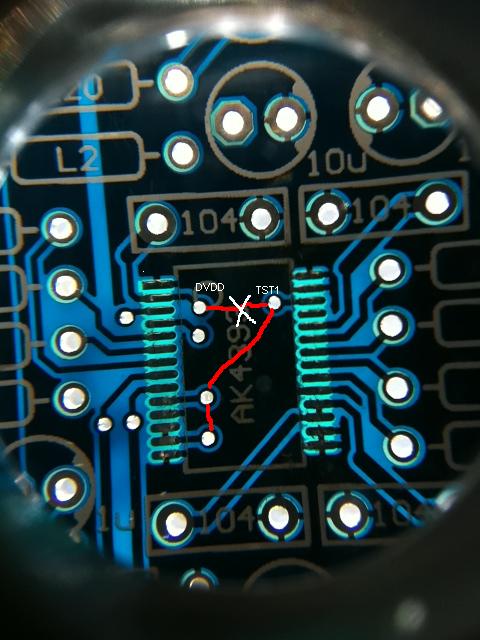

With a little mod on this board (ACKS pin to HI see pic), you can also set it in auto mode for master clock.
Hi Bismuth!
ACKS and TST1 pin in manual setting mode fixed to the analog GND. When auto setting mode enabled ACKS and DVS0 pin must be fixed to the DVSS or DVDD.
Here I do not see anywhere that you're separated ACKS from the GND pins?
Hi Bismuth!
Hi Jazzbear!
On the AK4396 chip, the ACKS pin is pin 28 (top right one on my last picture), you have to desolder this pin from the board, a little bit tricky operation due to component size (I used a very thin wire and a blade to bend the pin gently). Then you solder a bridge from this pin to DVDD ref in order to set ACKS to "HI", I used a simple wire for that purpose (the brown one on the pic).
I left TST1 (pin26) untouched.
DFSO (pin 9) is connected to pin 9 of the 74HC04 by a track (untouched).
PDN (pin 4) is connected to pin 12 of the 74HC04 by a track that I wired to VCC (pin 14 of 74HC04 emplacment) with a soldered jumper (see pic).
It works like this but I may have miss something ?

Hi Bismuth!
Page 8 in Datasheet:
TST1 This pin should be open(outputs Hi-Z in parallel mode)
TST2 This pin should be connected to DVSS(it should remain as is)
Everything else is done perfectly.:)
On bottom side:The line marked in red must be cut with a scalpel.

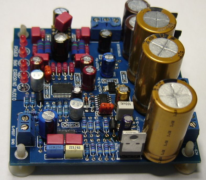

Hey, The new PCB (eBay along1986090 $18 w/ 3chips pre-soldered inc. shpng) and Dario's Upgrade BOM went together without a hitch - almost - and powered up properly on the first try. :D The sound is appearing balanced from both channels - but the "No Audio" LED doesn't light or flicker. I won't see that in the final build, but if anyone thinks it may indicate a problem that may fester, please let me know. I'm running the IsoTek Rejuvenation CD (As discussed over on the MyRef Fremen Edition thread) on it now. Looking forward to an enjoyable afternoon of 24/96 bliss.;)
