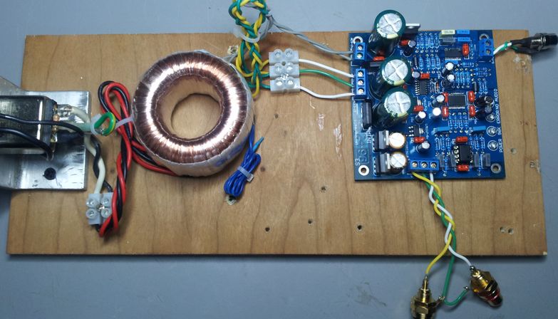

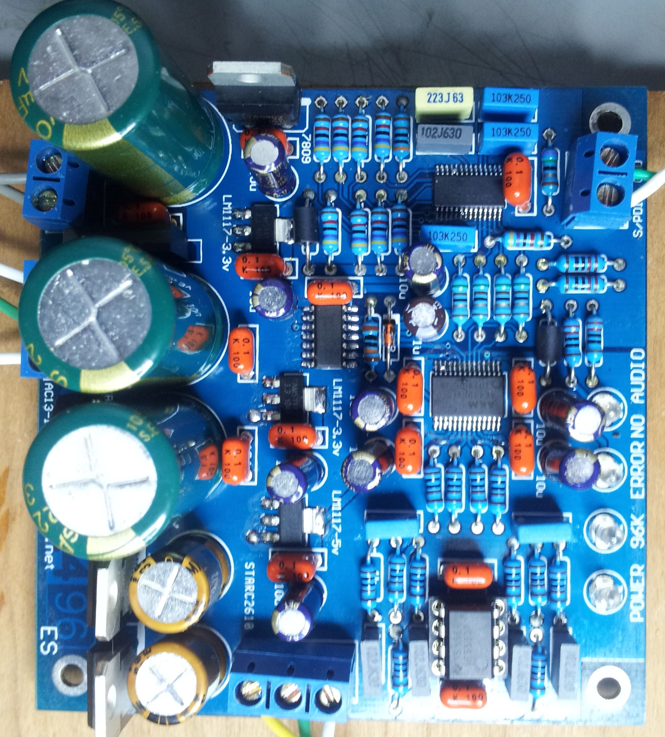

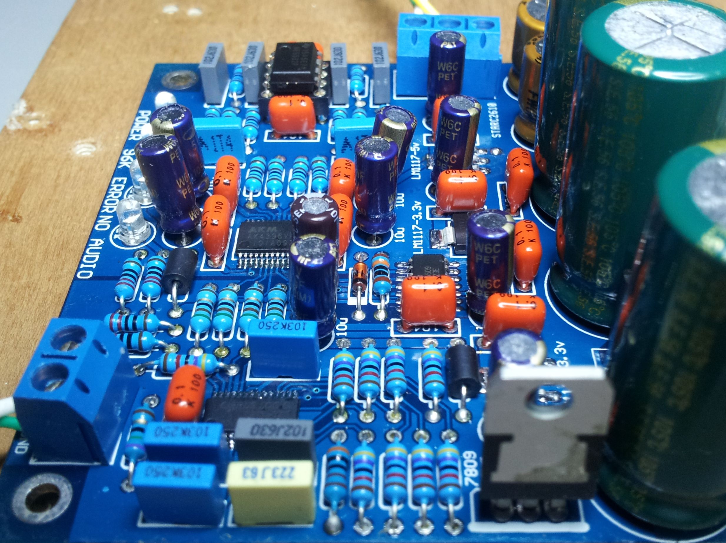

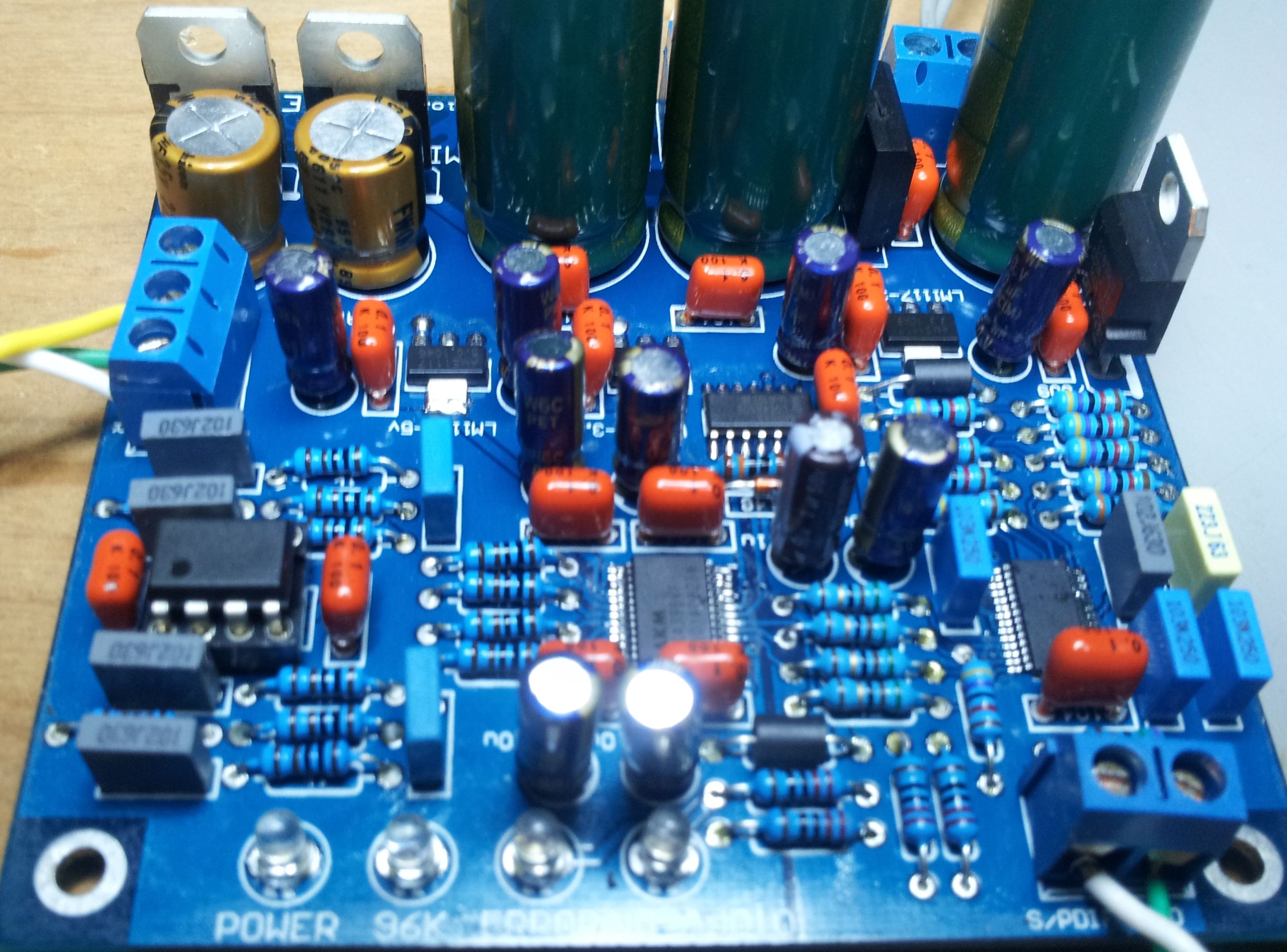

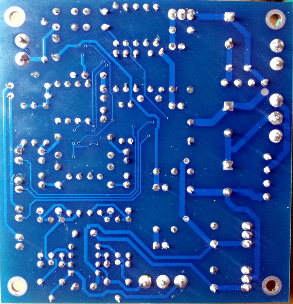

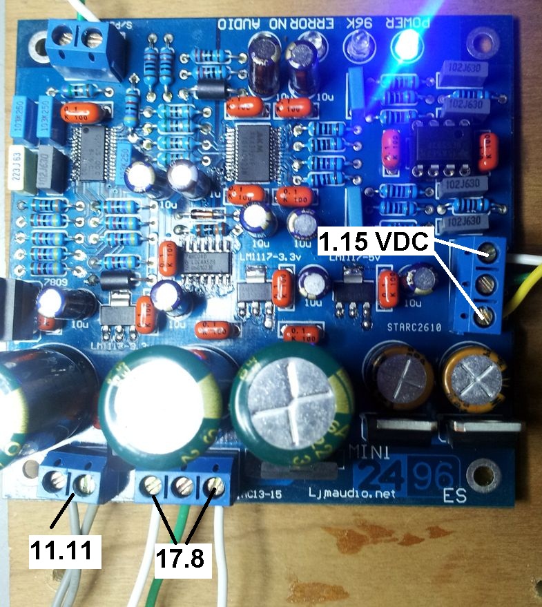

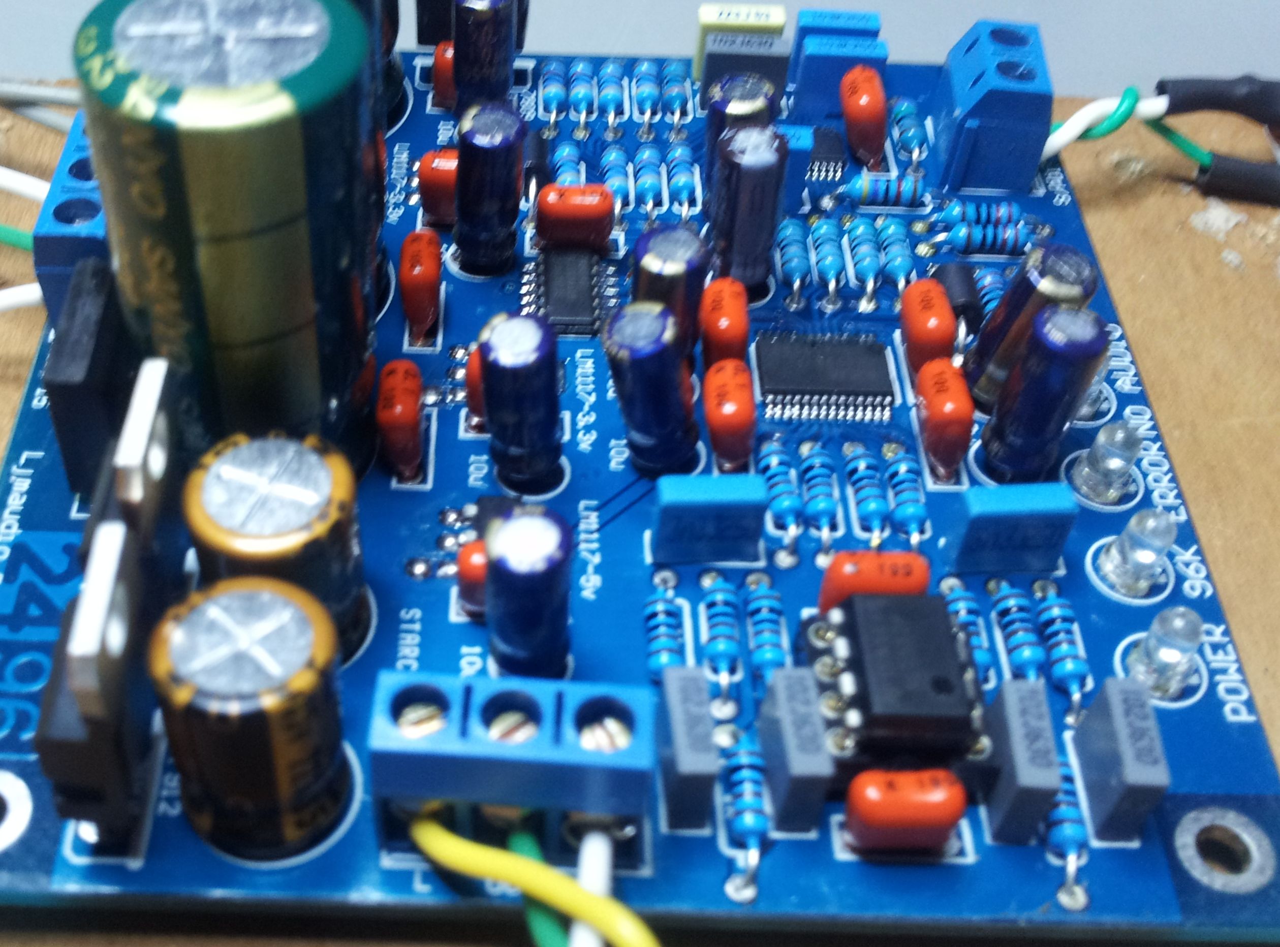

After completing the kit I got active "Power" indication and nothing else. Using the same source and coax that works perfectly with the Lexicon unit - no other LEDs would light. No sound but there was a slight hiss and some low 60 cycle shadow noise.
Things I checked:

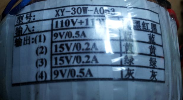

1. 17.8 and 11.1 VAC to power terminals. (though rated 15/9 on label)
2. No temp beyond room temperatures on board or toroid.
3. No visible solder bridges.
4. 1.6 VDC across both audio out RCAs
Luckily, no other equipment was damaged, but turning up the volume pot on the MyRef Integrated amp caused both LM3886 to trigger their protection circuits. Going back to PC --> Lexicon --> Integrated Amp was fully functional again.
The only other possible mistake was initially not using the Euro-style terminal on the 15-0-15 power in. I made direct connections to the board. I don't know if that could cause a problem.
Please review the pics for anything I'm not seeing
Things I checked:

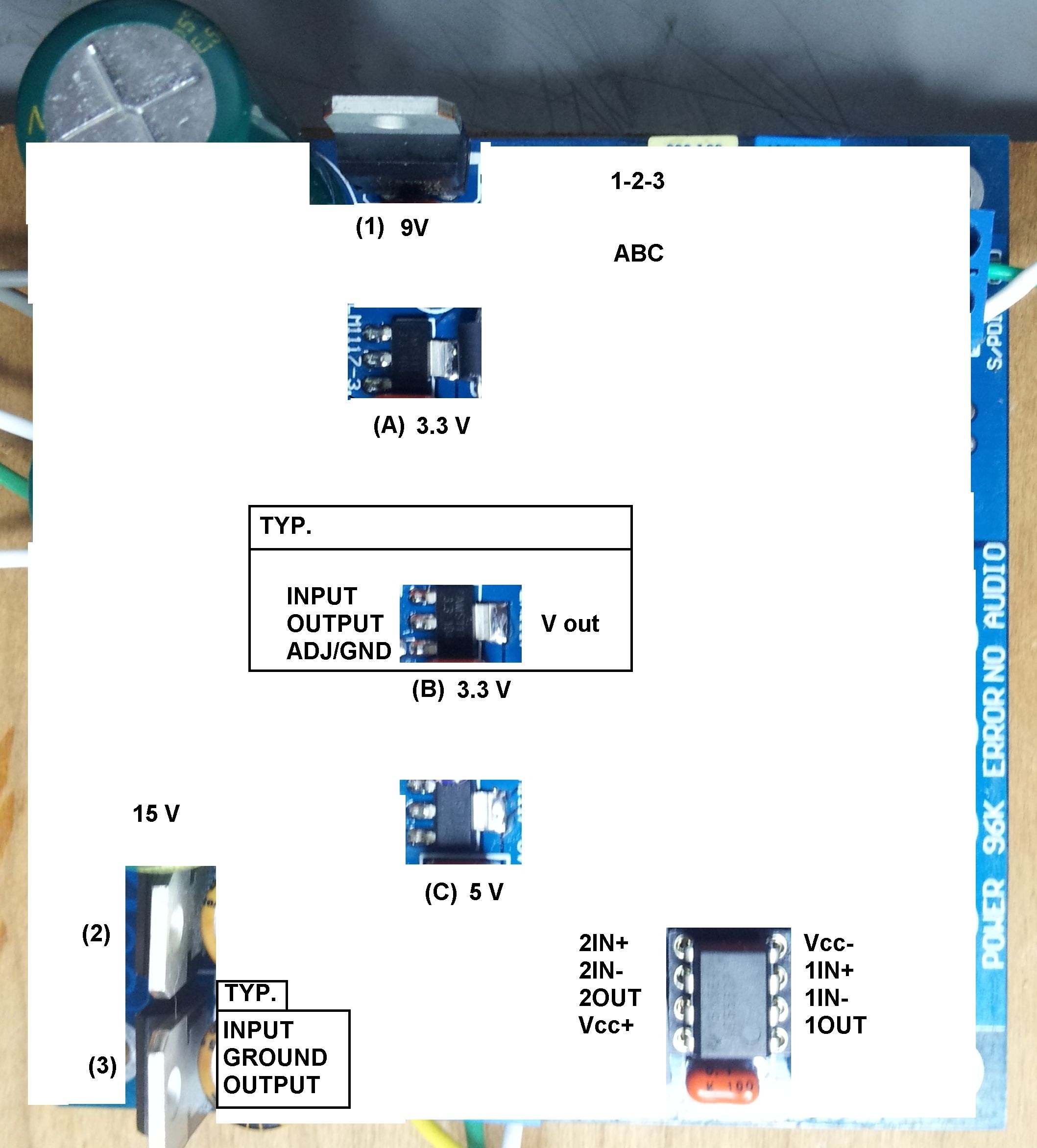

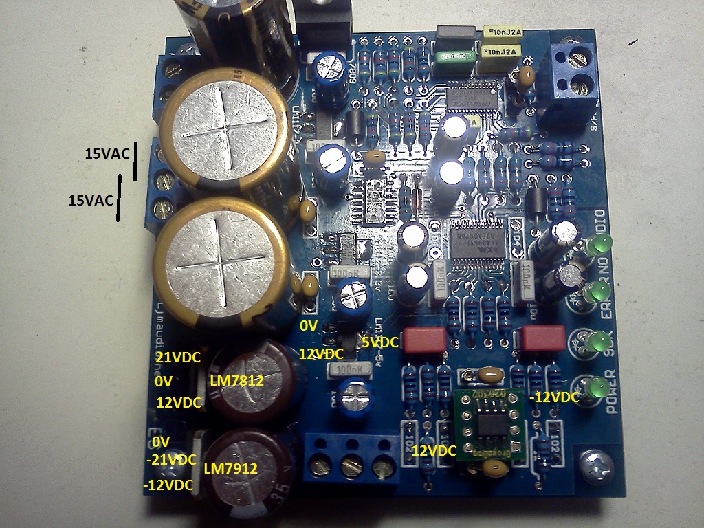

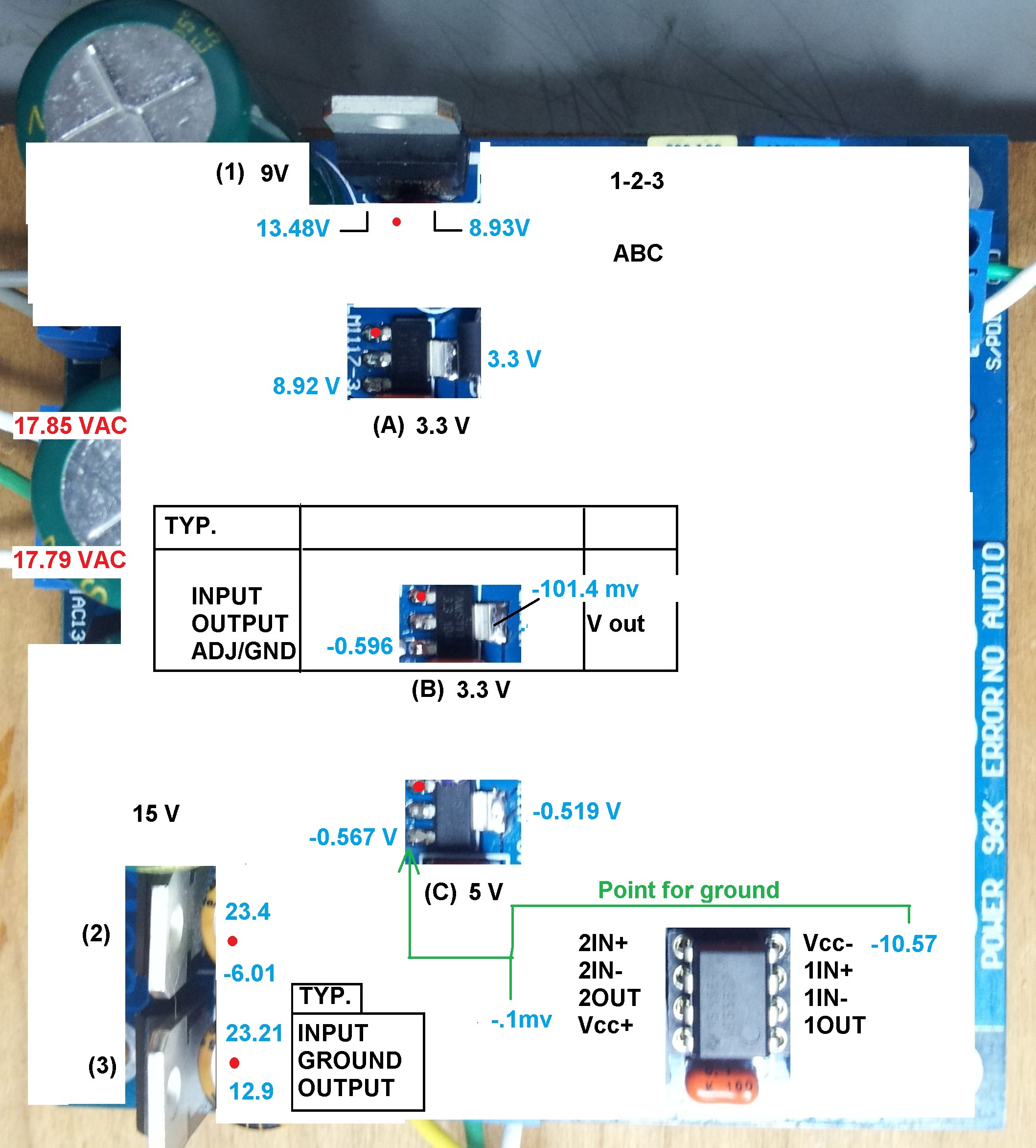

Hi Bob,
I can't see obvious errors but the DC offset make me think of opamp's rails.
I would measure:
  • analog AC rails vs ground
  • DC entering the regulators
  • DC leaving the regulators
  • opamp rails
When no input is present (SPDIF) a slight hiss is normal.

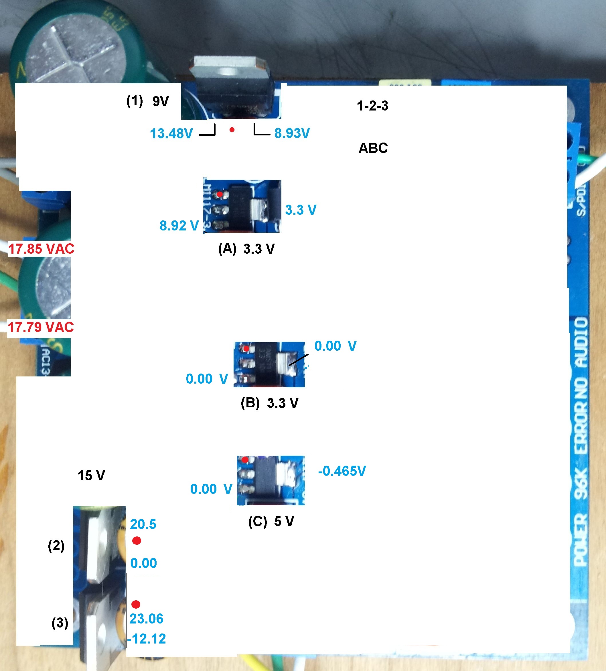

A couple questions before I start poking around.
1. Which group is referred too as "digital" - which analog (123 vs ABC)?
2. What's the best spot to pick for ground to do the opamp readings?
3. Please confirm rails are picked up direcrly from legs of 15V chips - 1,2 & 3. ( just noticed one is L7912CV the other is L7612CV)
Please bear with my lack of confidence/knowledge in this area. Gives me the he-be-gee-bees :yikes: Remember - I'm an ears guy not a schematic scholar.:eek:

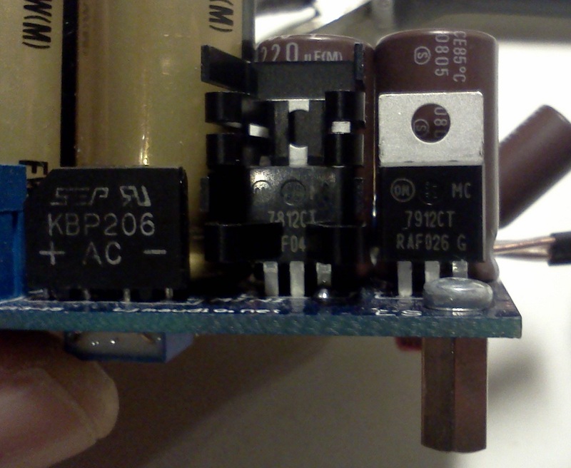

The analog section is the one where I put values in the picture I've attahced in my previous post (7812, 7912, LM1117-5)
The nearest will do (see where I've indicated 0V)
No, only 2 and 3 are the 15V analog regs one posistive (7812) one negative (7912).
Pay attention! 7812 and 7912 have different pinout!! See my picture for reference.
Dario

Dario and Fan are correct as the readings show. I remember separating out the 9cv from the 12 cvs but never took a close look at the board markings. Details, details, details.
So I need to order:
1 LM812CV
1 AK4393
2 LM117-3.3v
1 LM117-5v
Anything else that might be suspect ?
Hopefully my mistake will help others avoid the same.

Order an AKM4396, much better.
Also electrolythic caps on rails path can be blown.
But first replace the two LM7812/LM7912, maybe the rest is good.
