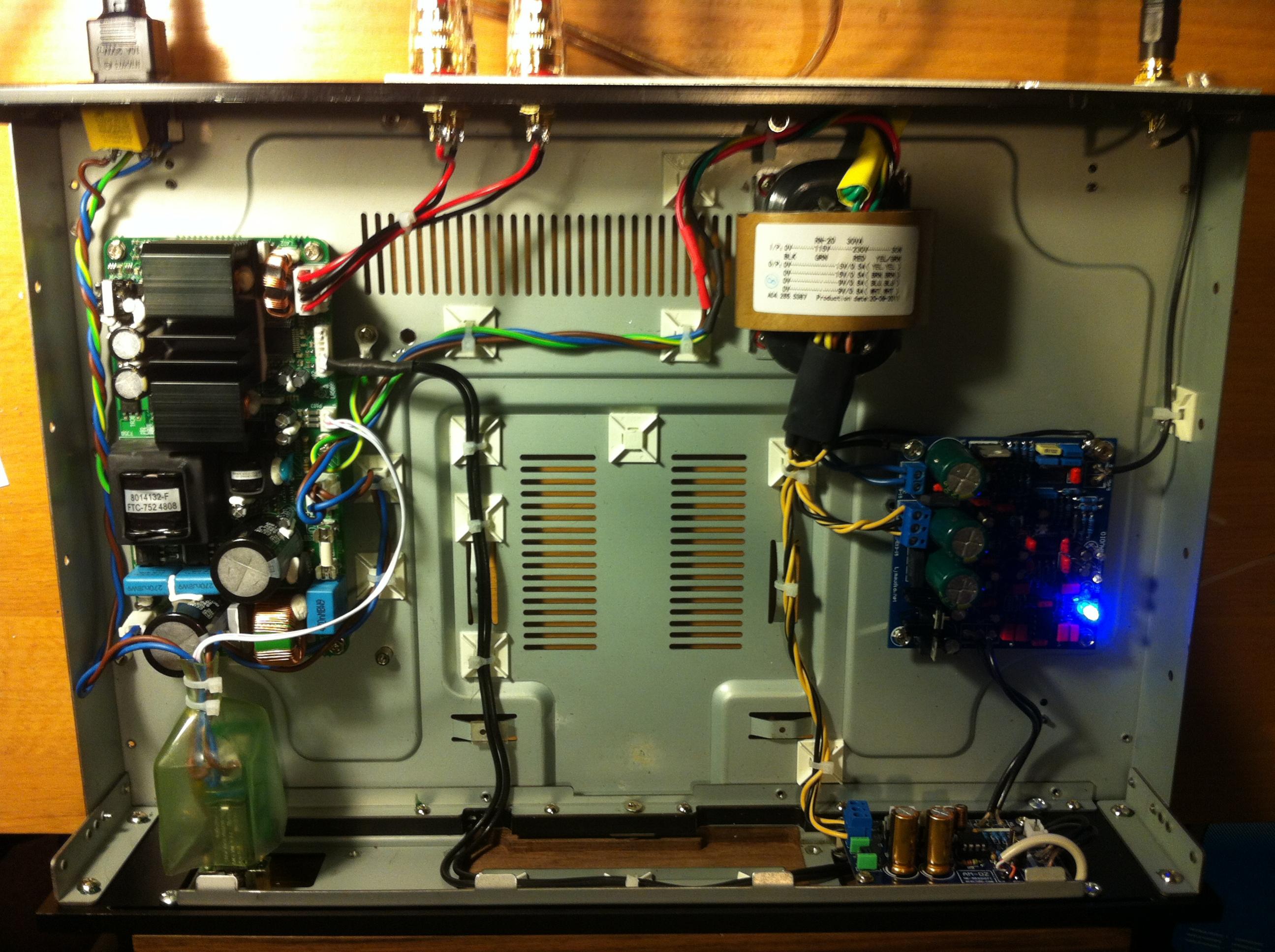

Hum problem.
I'm having some issues with my DAC passing mains hum to it's output. I'm feeding it to a Pre-amp board I bought from Ebay (to buffer, and provide a Volume control), and then into an ICEPower 125ASX2 module. With the DAC disconnected from the Pre-Amp, I have silence, even at full volume (ok, the slightest bit of hiss if I listen really close to the tweeter). But with the DAC connected, I get mains hum - not terrible - but definitely audible with no music playing at listening volumes.
I'm feeding the DAC with the recommended R-Core transformer, and have kept signal paths short, screened, and paid attention to layout. If I ground one output channel of the op amp on the DAC board, the hum reduces marginally, and if I ground the other, it stops almost completely. I wondered if I had a faulty regulator smoothing capacitor - I had replaced the originals with 100uf Electrolytics, per the BOM. (and the regs were also replaced per the BOM). I tried putting in some different 220uF capacitors, but still to no avail. I've checked component values in the LPF (modified per the BOM) and all ok, and checked and resoldered connections.
Unfortunately I don't have an oscilloscope which is hampering my diagnostics. I've tried running a ground wire to the AC centre tap to bring the circuit to chassis earth and am running out of ideas. I still suspect either a problem with the board (why would grounding one signal channel completely kill the hum, vs the other one?). I've tried changing the Op-AMP too in case it was faulty.
I'm about to try putting 10uF caps directly at the Op Amp supply rails, but I'm not sure what else to try! Anyone else experiencing hum from this board? Any other ideas?
Hum problem....
A photo of your build might help.
No - with the digital cable connected it is the same. If I remove the digital cable, I get white noise superimposed on the same hum. I've tried adding the 10uf caps to the Op Amp supply rails, and that made no difference. I have just reduced the gain of the following pre-amp buffer from 2, to 1.2 as I realised that I was achieving almost full volume too early on the volume control - that obviously improves matters in that the hum appears at a higher apparent volume setting, but the problem is still there. When I prototyped it outside the case, I'm fairly sure I didn't have the hum (but not 100% - I might have dismissed it or not noticed it - it's fairly low level, albeit noticeable). So it *could* be a ground loop. I think I'll try moving everything out of the case and recreate my prototype scenario to see if anything changes.
OK, making good progress; it was an inadequate ground from the centre tap of the R-core supply to the DAC and the chassis. That's got it to around 97% of perfect.
I probably still have too much gain in the pre-amp buffer - what I would consider full (clean) volume is somewhere just over the mid-point of the volume knob. I've reduced gain of that stage to around 1.2 (56k/47k) but I'm wondering whether I should reduce it to Unity gain (will I risk stability issues?). To reduce it further, I'd have to reduce the input to the pre-amp buffer, and I'd rather avoid that.
OK, making further progress. Ignoring the gain issue for now. I detect, with preamp volume at Zero, a very low level of hum at the speakers. Have tweaked the layout of cables a little more and am trying to reduce that hum next. Still getting a slight hum from the preamp stage at full volume in addition, but will tackle that in a minute. They might be the same source. My expectations might need adjusting before long!
Have you got a star grounding arrangement of the RCA ground cables on the pre amp?

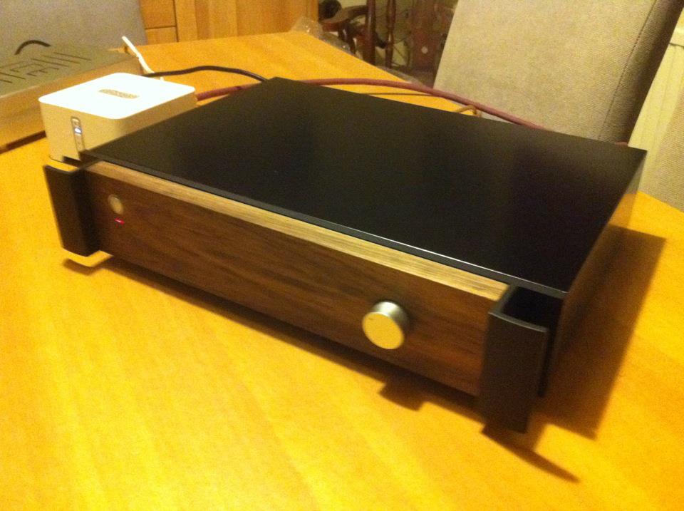

Finished. A DAC integrated, ICE Powered Amplifier, using the DAC module in this thread, a pre-amp module, and an ICE Power, 125ASX2 power amplifier module. DAC has had the voltage regs upgraded, the LPF corrected, and I'm using LM4562 Op Amps in the DAC and pre-amp.
Solved the hum problem - I had to run grounds to chassis from the centre tap, and then bond that to signal ground on the DAC board and on the pre-amp board. If I turn it to full volume, and stick my head against the speaker, I can *just* perceive some slight mains hum, but I couldn't eradicate that with any amount of fiddling or changing layout. It's such a low level now I can live with it. I've attached pictures in case anyone is interested in the layout, or the finished product. The case is from a Rotel 10 series DVD player that died a few moons ago. I created a new front panel from Dark Walnut, which turned out to be the trickiest part of the build as it needed some quite complex routing to accommodate the chassis.

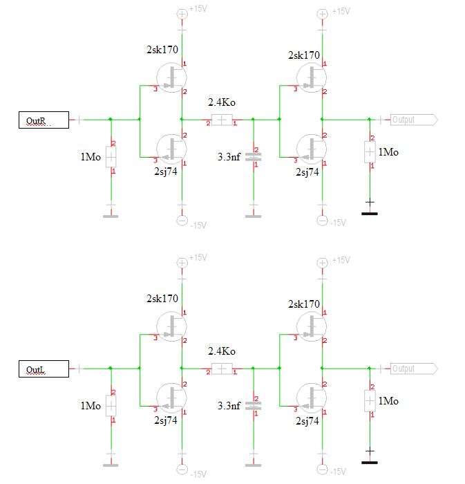

For the fun i try this output stage .
There is no output capacitor because there is one on my WA6 input ( Headphone tube amp ) .
My conclusions today .
Better than the OP ,better than the direct output ( Just a serial capa ,or the RC filter ) ...
Serge
Hi folks, and a VERY Happy New Year to you all
I've decided I am going to use the schematic posted below for the output stage on my DAC - looks simple & elegant which usually bodes well for good sound quality. Would any of those 2sk170s/2sj74s need to be matched, and of certain grades to work optimally? Thank you.
- John
