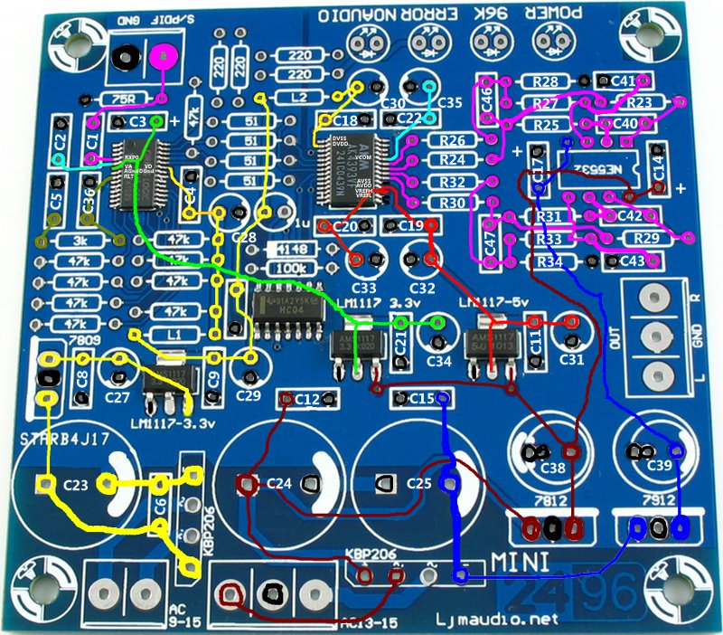

ClaveFremen, I believe the short connection between C9 and L1 is in error. This version looks a lot more accurate than the original posting.
You're welcome :)
Yep!, you're right, I've attached an updated version.

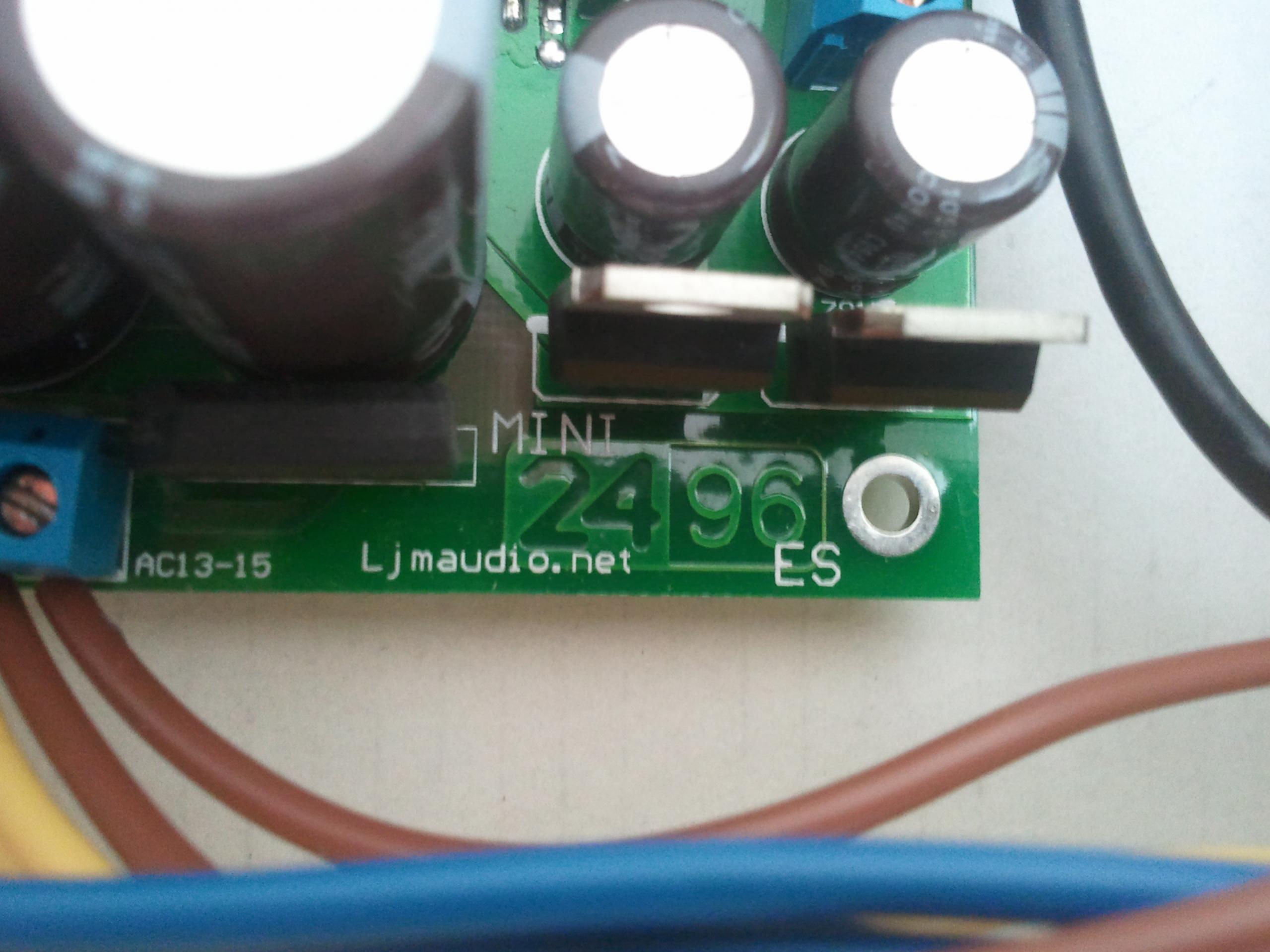

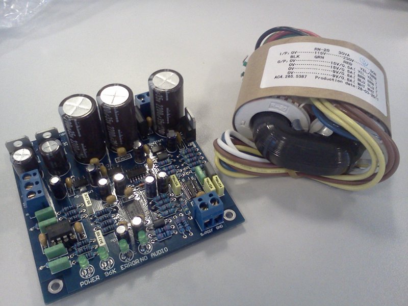

RE: 3 types of pcb ???
Ok, I propose (just to rule out variations) that we compile some pics of the boards we've received.
I'll start here by uploading pics of the pcbs I've acquired...
I noticed on Clave's last attached picture that there's no 'ES' marking in the bottom right corner by the 'Mini 24 96' markings
My boards arrived populated, so I cannot see/confirm if there's any track route differences.
Another thought : I wonder if Evanellion can comment on these variationa as he/she said earlier in this thread that they developed the board design !?!
-Andy-

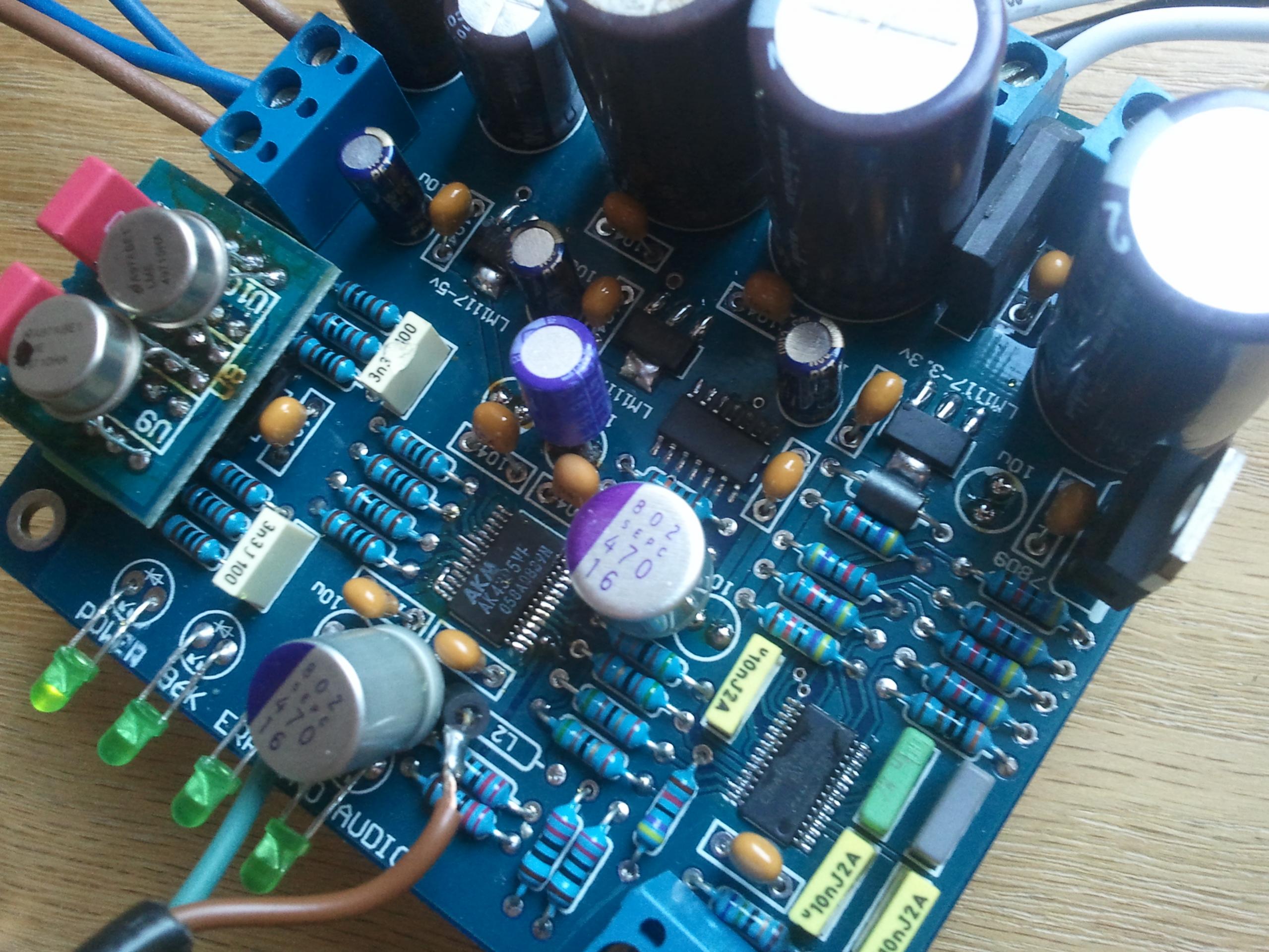

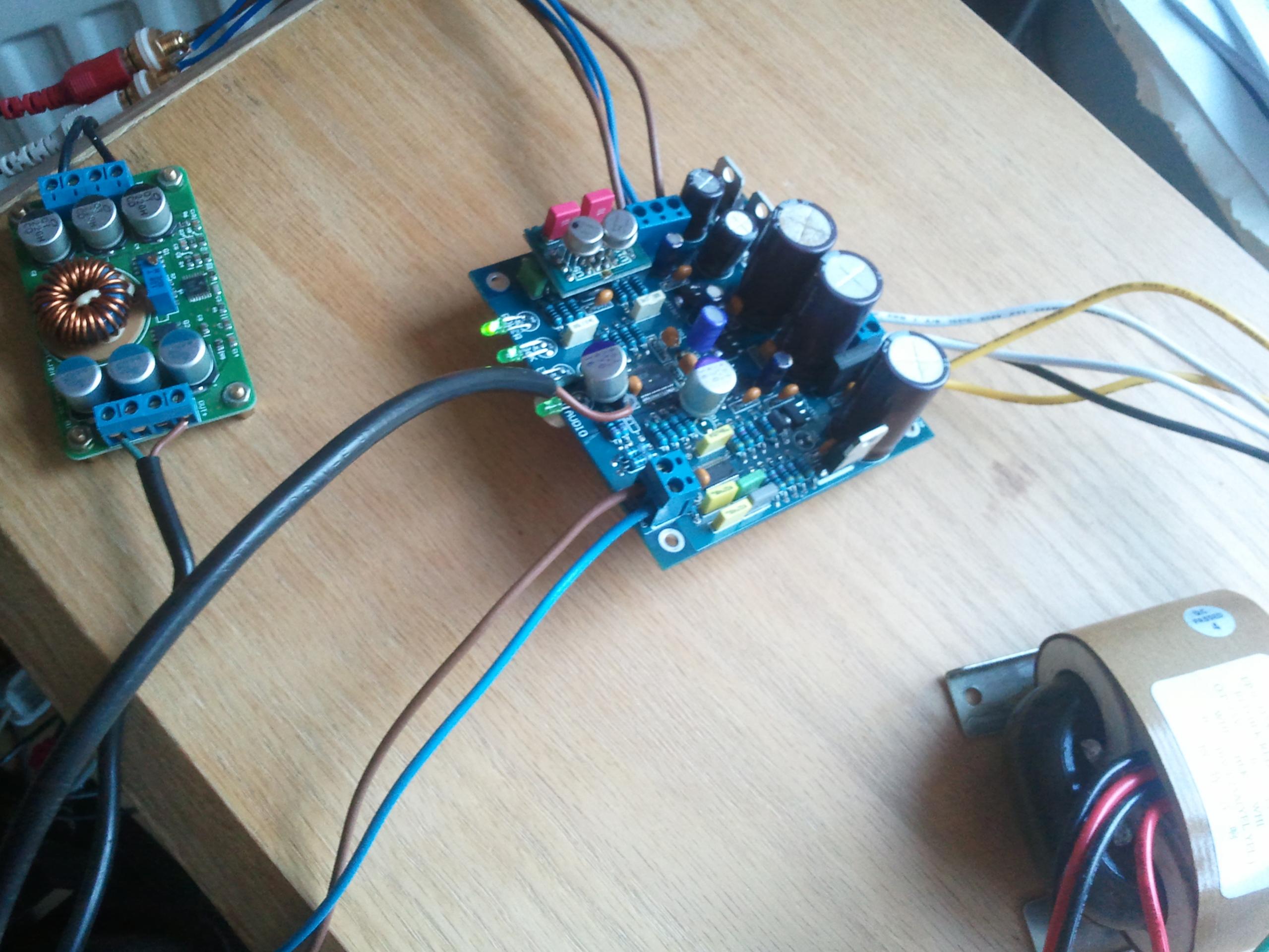

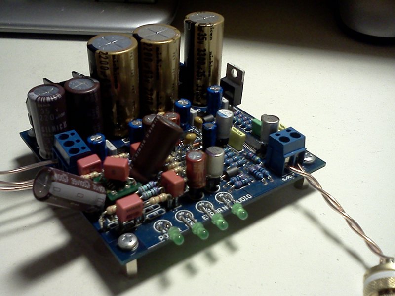

AK 4395 IC/5v reg/Oscon mods
Well, I can say that after all this work, the new modifications to the
AKM kit board is completed... up an runnin' and as I type - burning in ! :D (Big sigh of releif)
Here's how it looks...
For a moment there, before power-up, I was thinking that the chip could be a fake as the labelling isn't the same as the original AK4396 ic..
..but all appears to be working well :)
{This pic shows the extra voltage regulator used to dial-in the 5v required by the 4395 i.c}
I'll run this in for the next 4-5 days then give it a spin thru the stax headphones. Hopefully, it'll be a blissfull experience :xfingers:
-Andy-

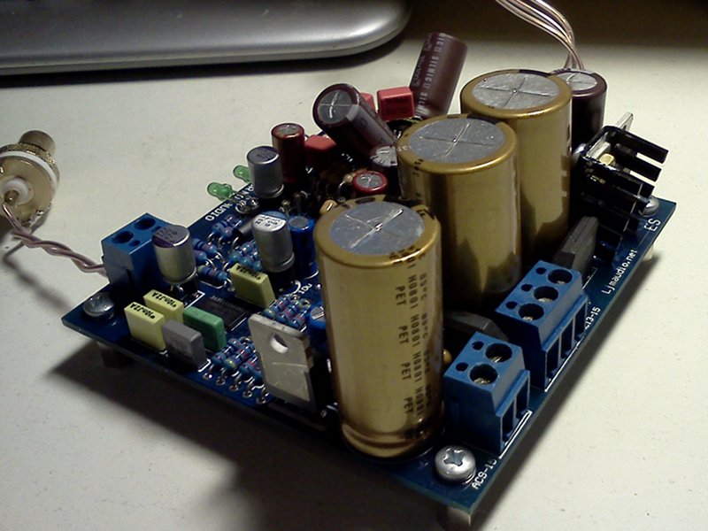

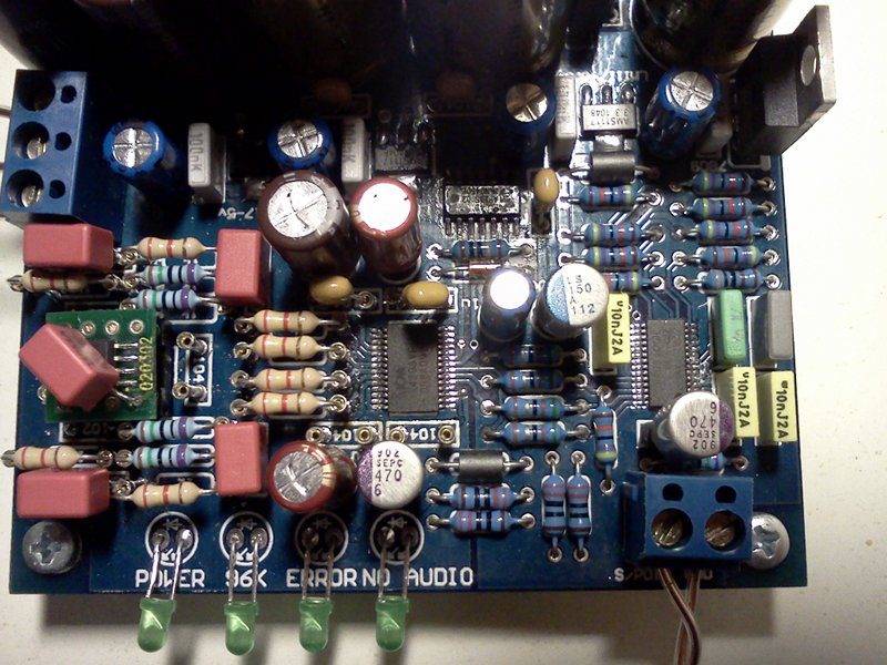

I am a little in advance...
Well, I've attached an updated BOM which reflects what I've actually done and some of the planned mods and also some photos.
It includes preliminary subjective listening impressions and like the previous one it's a work in progress.
Listening impressions of mods are compared to my original assembled kit (photo attached)
The most important mods are the one regarding the LPF (Caps, resistors, opamp, opamp decoupling)
Digital chips decoupling comes immediately after.
As Jean-Paul pointed out the 7812 needs an heatsink.
Apart opamp decoupling caps all electrolythics I've used are a perfect fit. Some Wimas though must be mounted on the other side of the PCB.
In the last photo opamp decoupling caps are removed just for better visibility of others mods
