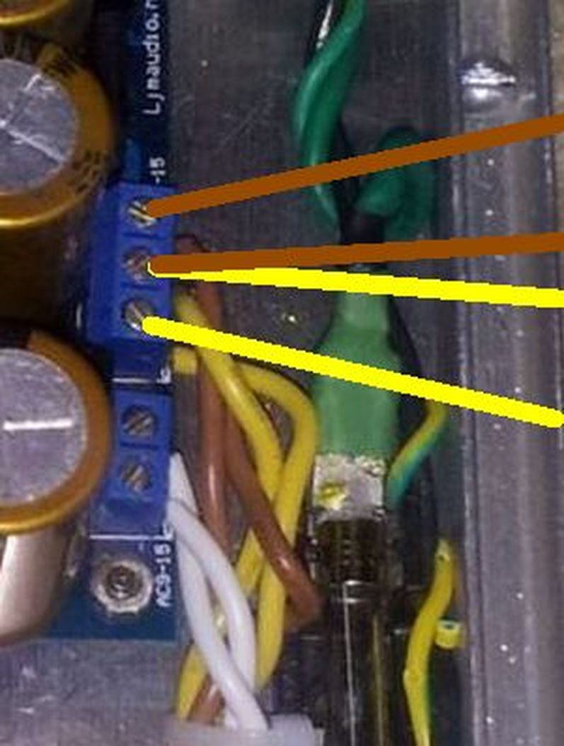

Someone sent a PM asking a photo of the R-core to PCB connection - thinking it might be more complicated than implied.
From upper right down:
1. Simple AC inlet- Green = hot, Black = Common, Gn/Yel = Earth Ground.
2. Fuse holder on Hot leg. Combination units for 1 & 2 can be purchased.
3. Main AC switch on Hot leg.
4. Three position Euro-Style terminal block. For both safety and secure but removable connection to transformer.
5. Supply wires entering trani at left side.
6. Board power supply wires - White = 9V, Brown & Yellow = 15V.
7. The Red wire is for 230 V applications. The end is covered with heat shrink tape.
8. The Blue wire is an extra 9V lead. Also protected on the end.
Just that simple.
IMPORTANT! It is always recommended to make a secure connection between the (Yellow/Green in this case) safety earth ground to the chassis with three wire AC mains. The only exception is in the use of what is called "double insulated" design where the power is never exposed to the possibility of touch. In the picture there are three potential shock hazards:
1. The bare ends of the fuse. That type should be used with the matching cover. A combo inlet/fuse fixture will eliminate that risk.
2. The unused tab on the two position mains switch needs to be removed and/or insulated. Selection of a switch without the extra pole is recommended.
3. Even though recessed, the terminal block screws could present a hazard from contact with a tool or probe.
4. The BNC S/PDIF connector used in this build is not ground insulated from the chassis. The earth/safety ground does not interfere with the signal.
Take your time and insure no uninsulated mains/AC wire is exposed to air anywhere along its path. If you can see it you can touch it. :wave2s:
