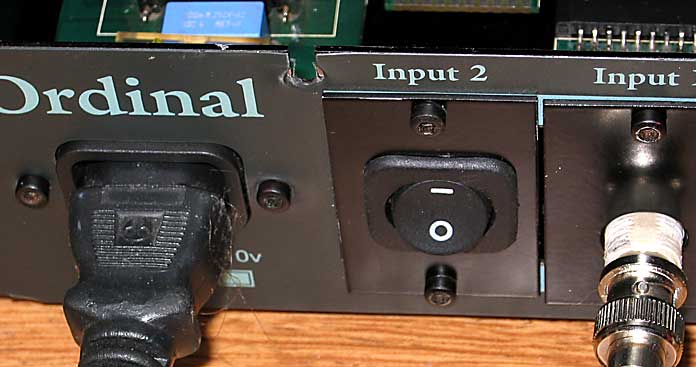

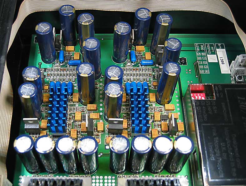

As you see in the attached image, it's not so difficult to change capacitors. I also add a little heatsink on each TDA1547 and a power supply switch.

I'll try to translate from an italian review the meaning of the dip switches of the 1307 filter
( I'm not much into electronics/digitalstuff )
With S/H you chose if you want to sample the audio signal every 3 seconds, to verify the DC content.
If htis option i s not ON, the 1307 sample the DC leven only when swithced on.
If the S/H switch is ON, then the HPF ( high pass filter ) switch must be ON.
The 4th/3rd switch is for chosing the noise shaper.
The DITHER is for applying a dither in AC and DC to the audio signal.
Hope this helps.
