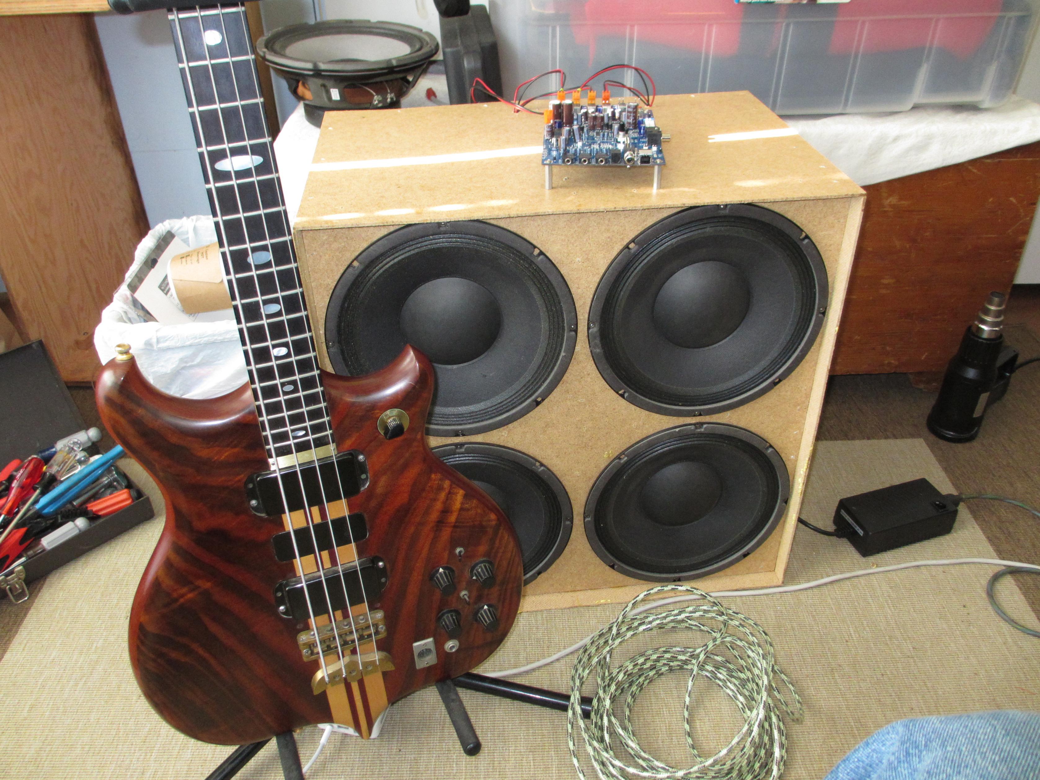

I've started a bass guitar amp project with the D2 Audio DAE-6 chip (Intersil). The chip has a DSP pool that you program with a GUI, so no DSP code, and modulators for a whole bunch of channels. There are canned applications for psychoacoustic bass enhancement, stereo expansion, etc. Basically you should be able to make a really really big Jambox without much trouble.
Before I go too far down the D2 road, are there any other chips out there with similar features?

Looks like really powerful solution with features out the wazoo. Did you make the pcb or are you using an eval module? Which part number includes integrated power amp?
The board is a demo board. I was just at Intersil as an FAE and ordered it. It took Palm Bay 6 weeks to ship it. There are four versions of the board and they shipped the wrong one. Doh!
D2 is closed loop. There are 5 different D2 chips with variations. DAE-1 os older, DAE-3 is newer and DAE-6 is the newest fully flexible part. You can put processing blocks in any order. DAE-4 is new, but has a fixed signal path, an integrated power stage, and you can tweak parameters on all the blocks. IPS is an integrated power stage good for 10 or 20 watts depending on load and if you bridge it. The variations are licensed options for Dolby, DTS or Mark Levinson's Mighty Cat.
I have it up and running and it sounds great. I have four single ended amps into each of the 8 ohm speakers for a total of 30 big watts! With the bass enhancement it beats your head pretty well. My plan is to build discrete power stages with ISL2111 drivers and MOSFETs. Phihong has a 1KW 57V power supply at Digi-Key for $400 which is fine for prototype and early production.
