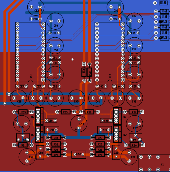

attached is an rough layout for the left channel DACs and I/V
dark red is top layer
lighter blue is gnd plane
dark blue is power layer
orange is bottom layer
dac output is taken after of C43 - pads are still missing...

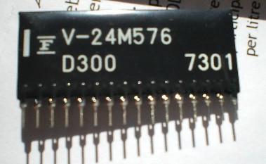

The VCXO is a major issue for this project in that it's scarcity makes the D1 extremely difficult to clone unless you have a Fujitsu VCXO in your possession - no doubt a "good thing" from the Pass Labs perspective. :D
So at this point I have the choice of pushing on with a clone that is effectively unbuildable except those who already possess the said VCXO, or dumping the D1 VCXO/PLL and replacing it with something based on 2 x Tent Labs VCXO to cover 44.1 and 48/96khz respectively. decisions, decisions....

One possible "fix" limited to 44.1khz playback would be to add a footprint for a Tent VCXO straddling the fujitsu footprint. This would ignore any frequency switching on the F0 and F1 lines and run at a fixed 44.1khz regardless of input.
A longer term plan if there was any interest would be to make an adapter that plugs into the fujitsu footprint, with relay switching between 11.2896 and 24.576mhz vcxo's. This would enable 44.1khz, 48khz and 96khz playback with a suitable rx and df - cs8414 and df1704 were used in the 24/96 D1.

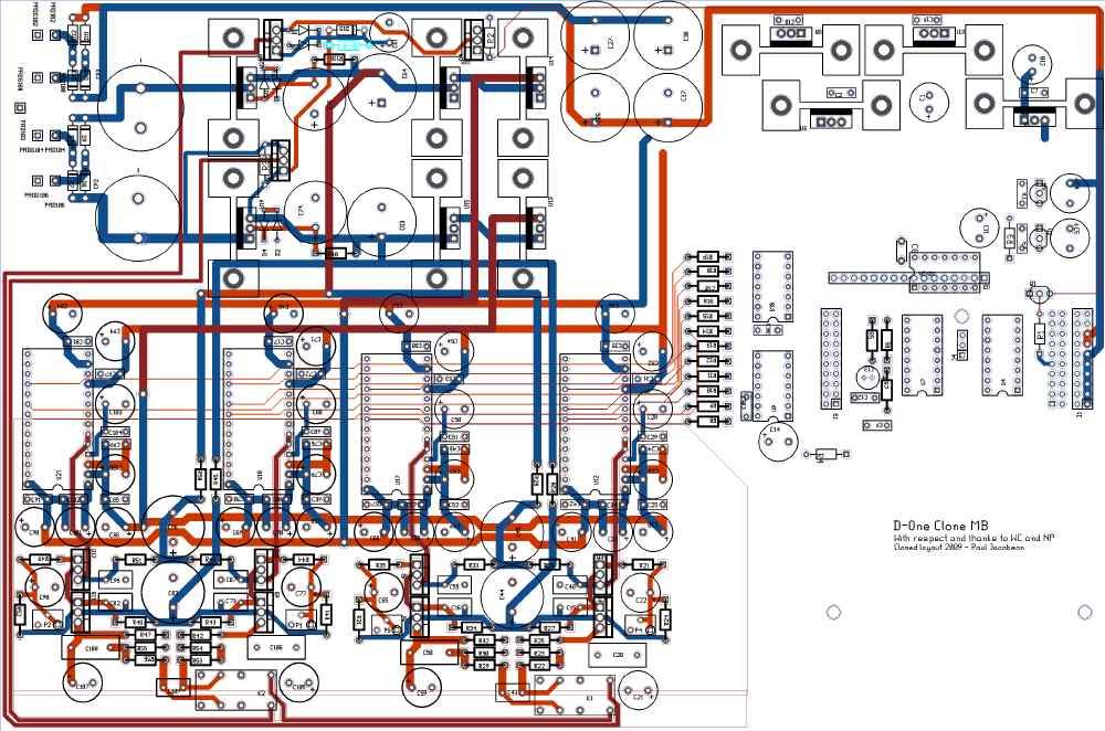

I'm slowly making very slow progress on the D-one clone mother board.
The component placement for the MB is almost final and the routing of the VCXO/PLL and digital power still needs to be done. The attached pic has the ground plane and a top layer polygon shown as outlines only. Cap diameters are sized to allow use of Silmic II's for everything except 1000uf/50V and 3300uf/35V psu caps.
The rx daughterboard is also a work in progress. I've abandoned trying to source the ODL 50 ST module and will use a HFBR-2416 rx and LT1016 comparator as per the datasheet in it's place. There is some discussion on this in the digital forum.
Of course, as soon as you post a comment like this you realise that you've got to shuffle half the layout to fix a glaring error. I'd transposed left and right channels, and it only clicked when I worked out how to fix the vast difference in data line length in the layout I posted.

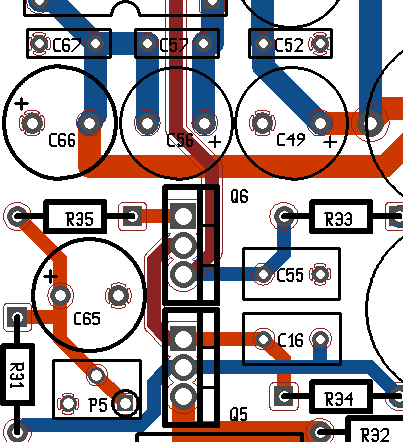

I've been looking at the routing of the 0.01uf caps at the input of the I/V and think I've got that wrong.
I'm not 100% on the purpose of the these caps, but they appear to form a low pass filter with the output impedance of the PCM63. The corner frequency of this filter is just under 24Khz so I suspect it cleans up any RF noise coming from the PCM63.
I'm not sure that the current layout does what is intended??

Thanks to ALDO I have a clearer picture of the layout of the D1 Rev0, and as a result I've ripped up most of the layout I'd done and have reworked the component placement based on this new information.
I've noticed that the 3.3K resistors (R26/R33 on the schematic in the post above) in the I/V are different to the rest of the resistors. In the Rev0 dac these appear to be something like holco's while the rest are dale. In the 24/96 version they look like dale RN60's while the other resistors are the standard Pass issue industrial items. It appears the aim is to reduce the noise contribution from this resistor which is at the input of the I/V stage.
At this stage the plan is to do a small run of the boards, which should come in at bit less than $100US for 4 layer motherboard (11.5" x 7.5"), daughter board, and front panel.
