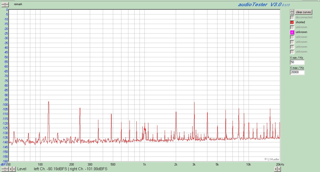

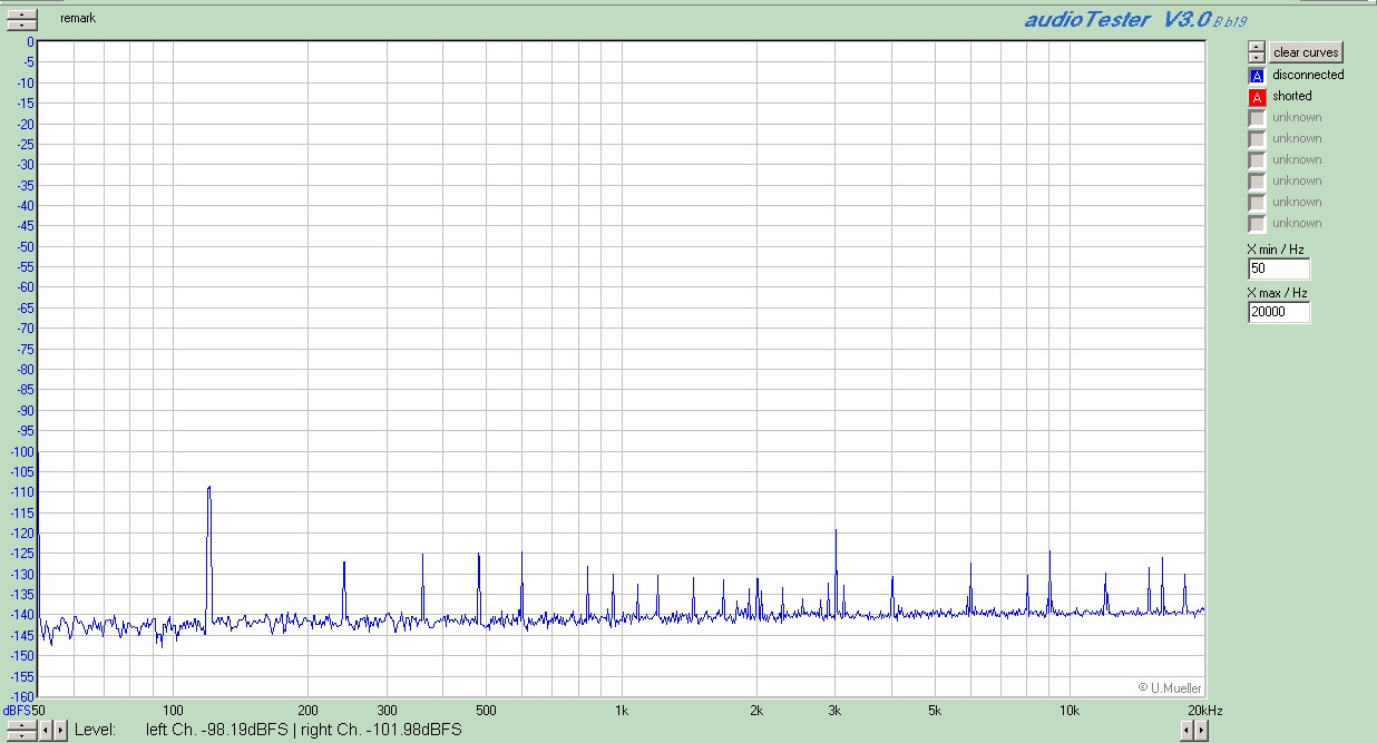

I am getting more suspicious of the soundcard. When I have no cable connected to its input, I get a noise floor that I was expecting (blue graph).
As soon as I connect a 1/4" plug to the input, I get something I don't like (red graph). This even with the other end of the short cable shorted out (tip-ring-sleeve). What I don't understand is why I am getting significant quantities of 1 kHz harmonics, with the input shorted and generator off ? Both input channels do the same thing.

In a word, yes. See if you can borrow another soundcard to check. The Audiotester software is a bargain- the functionality is sometimes suspect for speaker measurements, but for basic electrical measurements, it does a fine job, and can give you excellent resolution.
All right, now we have some progress. Used the cheap soundcard input on the laptop, and got a poor noise floor, around -96 dB, but it was very flat with no harmonic aberrations. So clearly there is something amuck with the Saffire.
