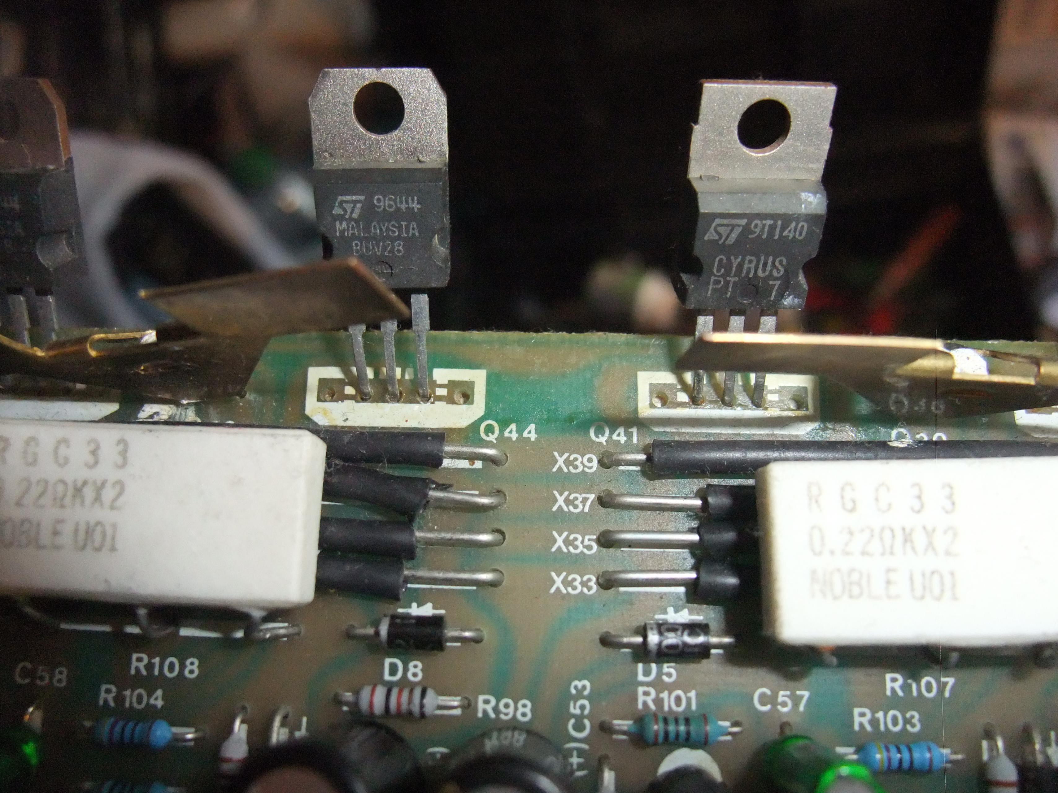

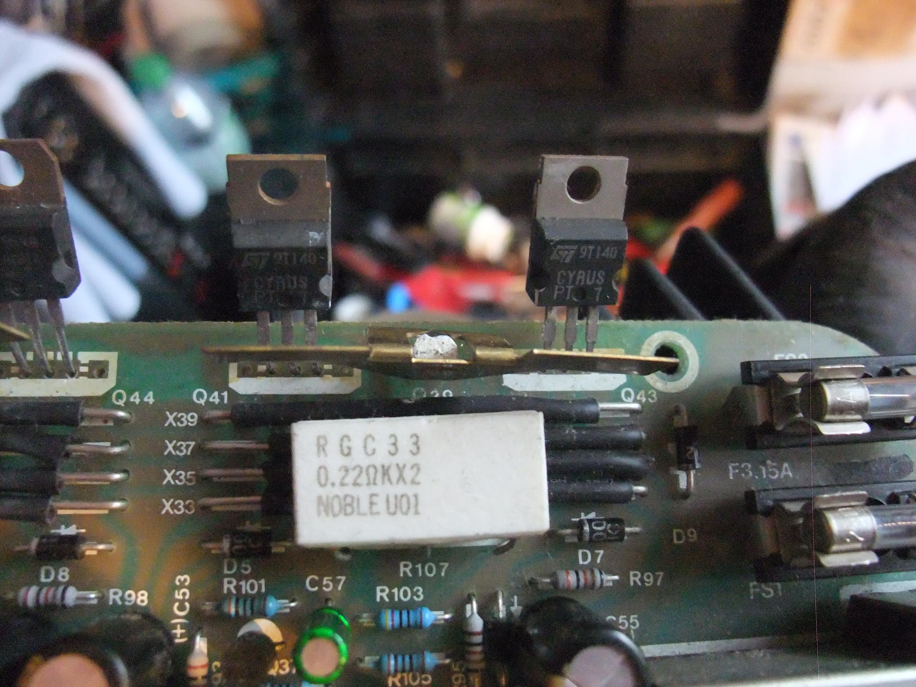

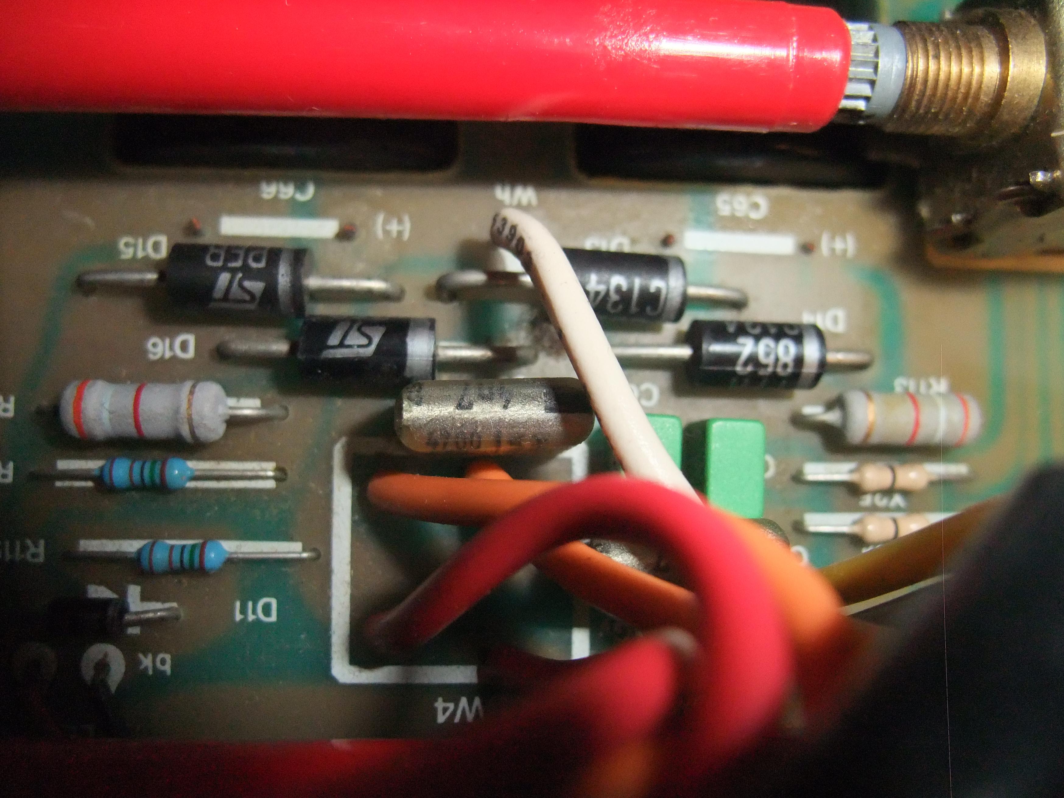

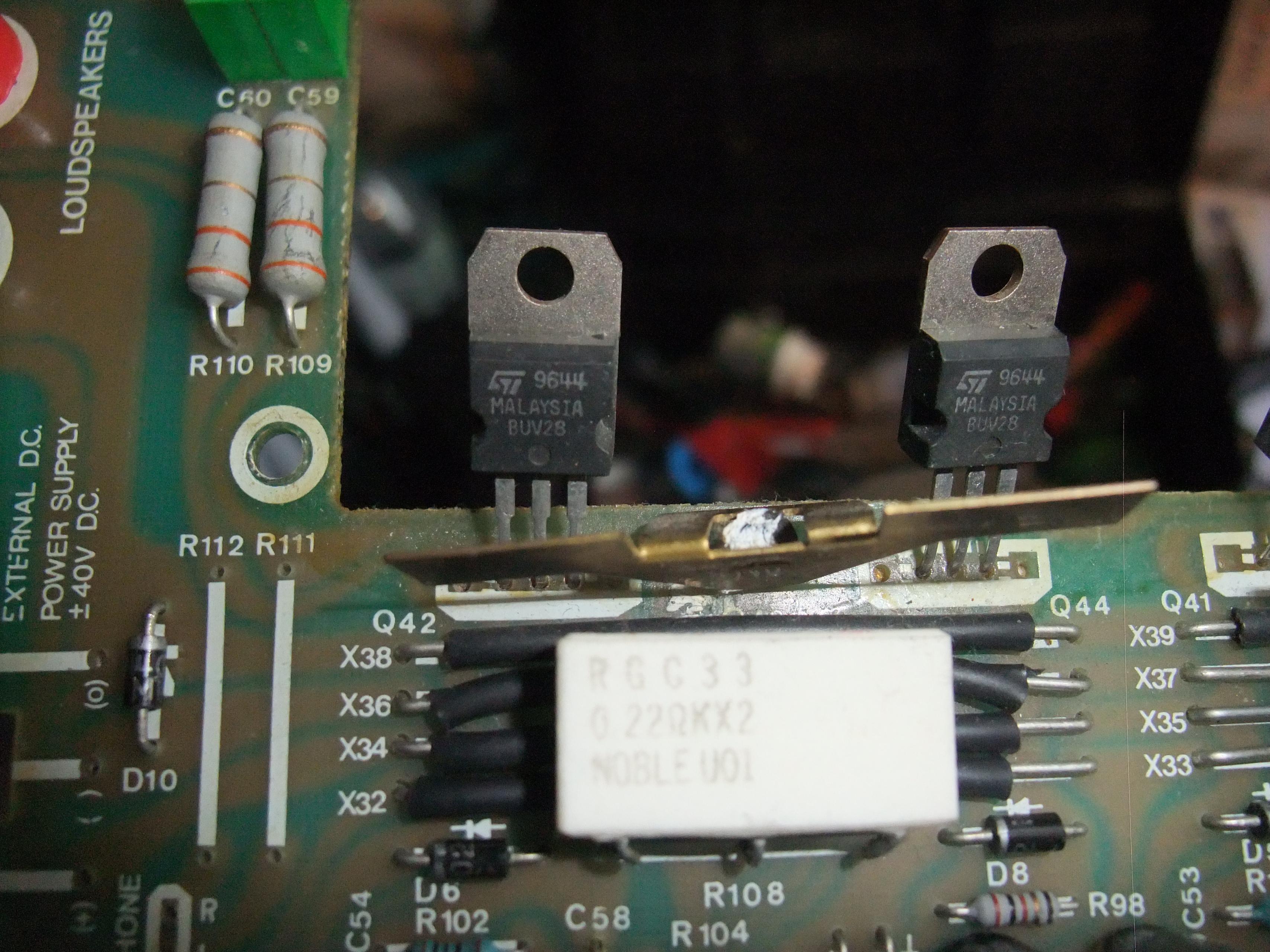

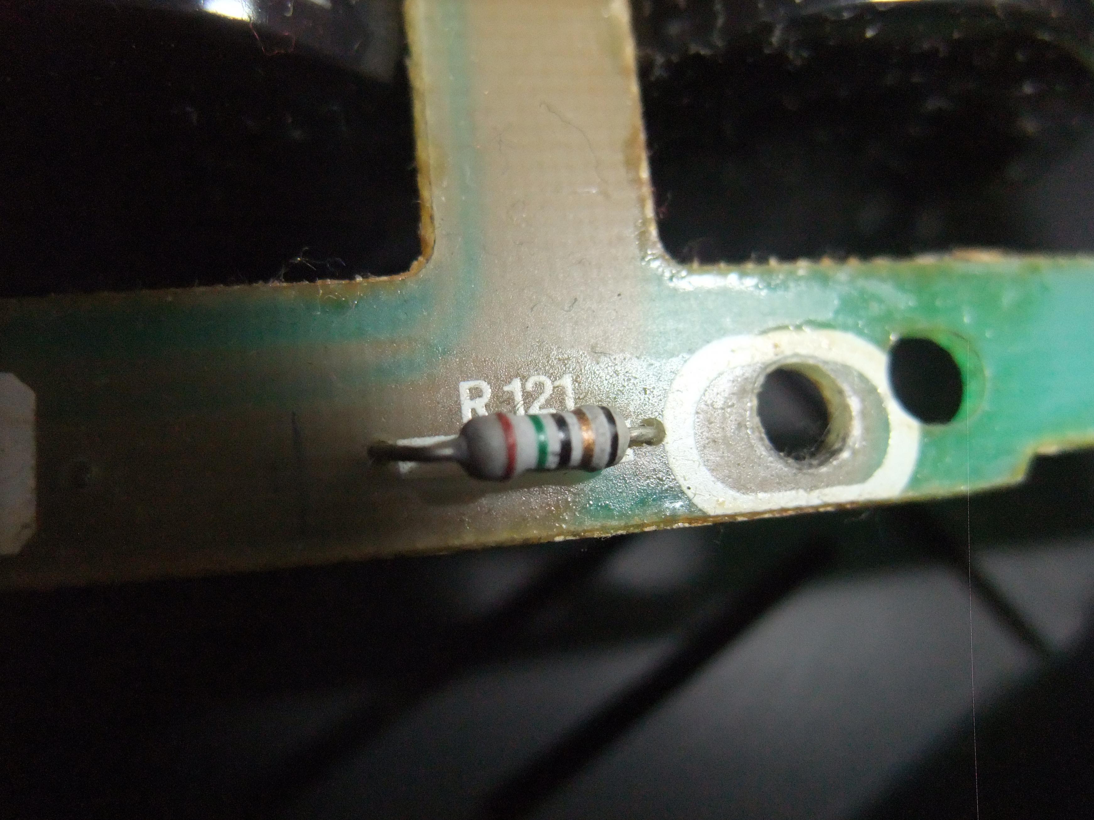

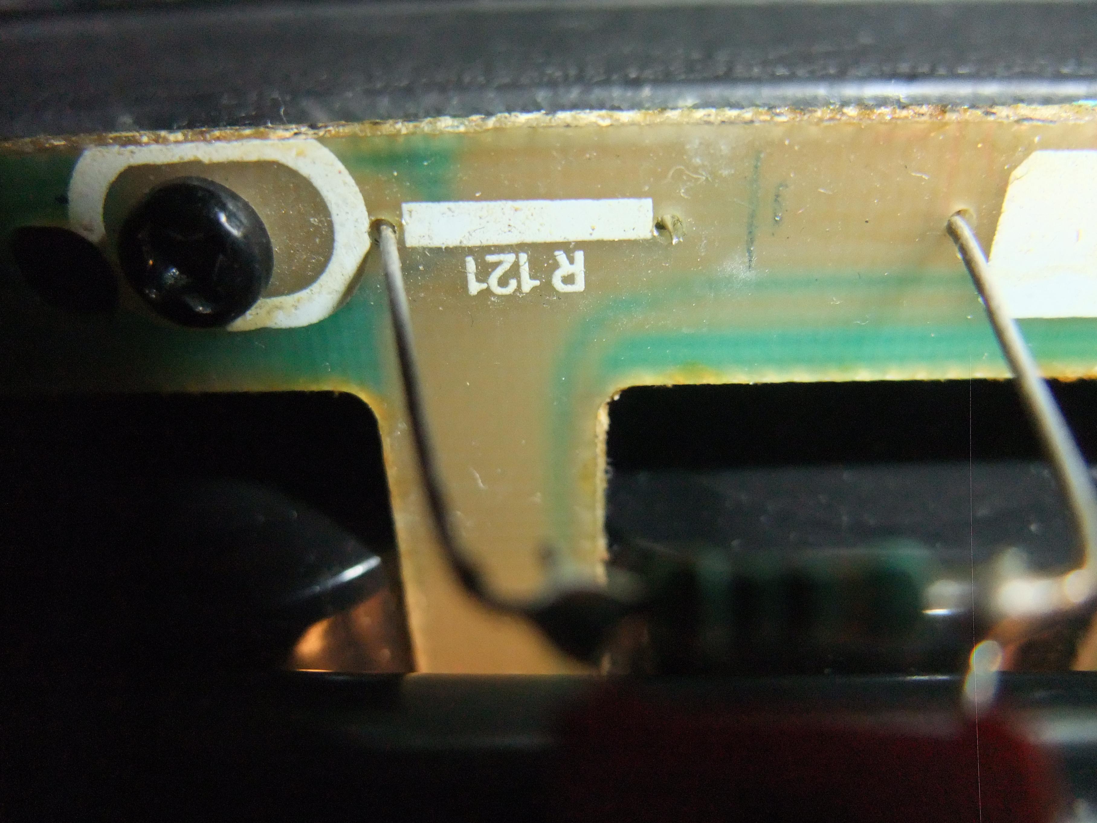

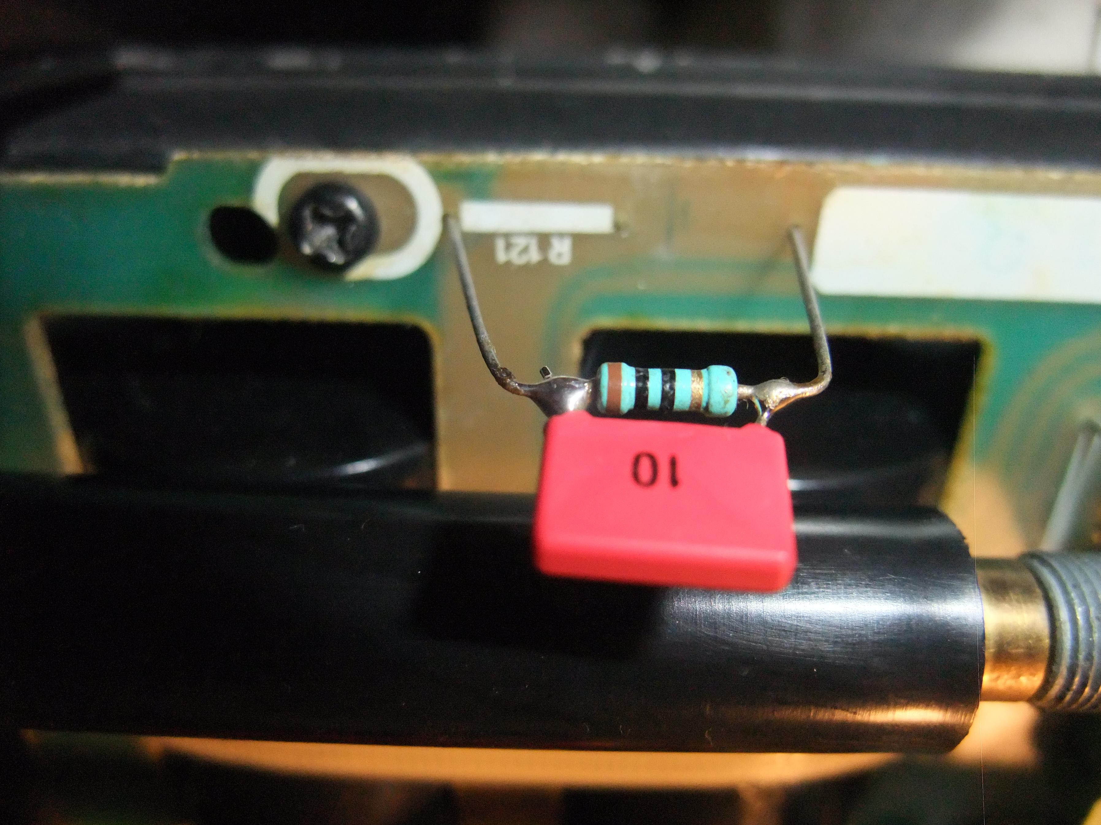

Today I have get a humming Cyrus ONE (all caps was already replaced by Panasonic versions) due an interrupted 15R resistor "R121" between GND and chassis (go to the attachment - first three images).
The usual present parallel connected capacitor was not in use.
Sometimes by a high current flow blown this resistor.
What is the main reason therefore ?

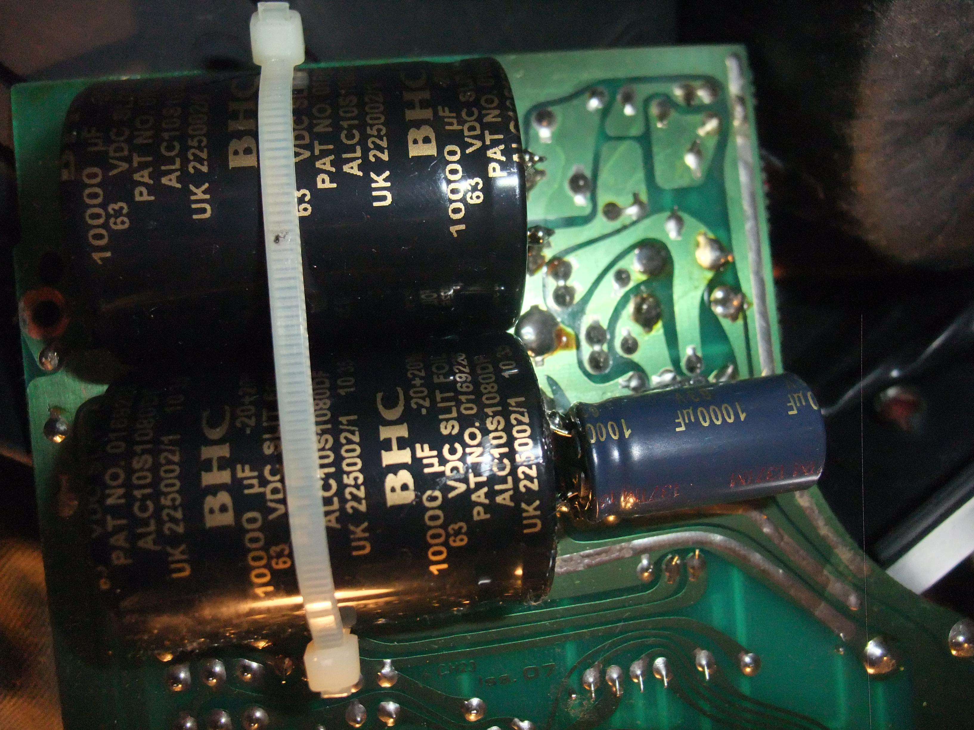

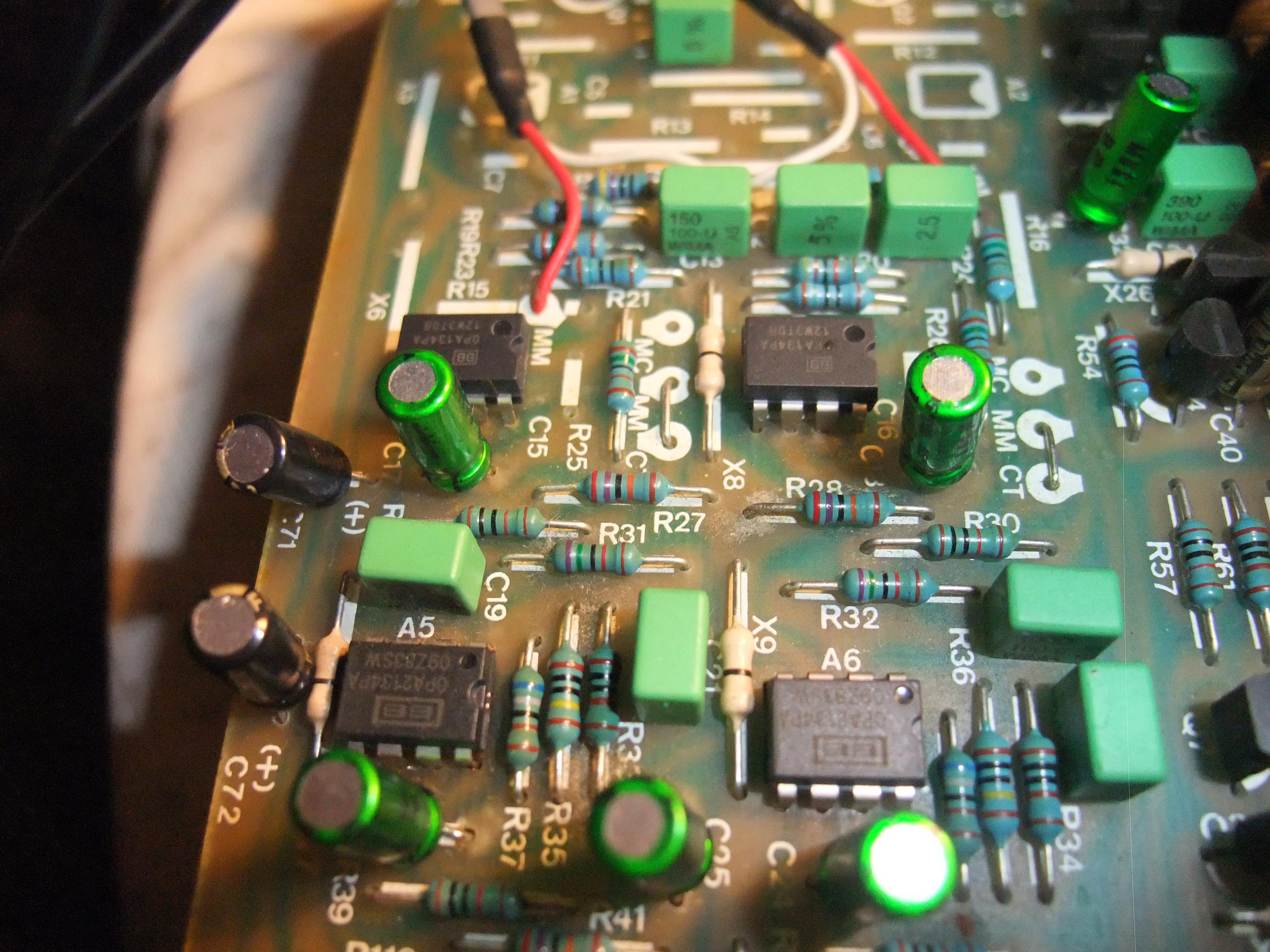

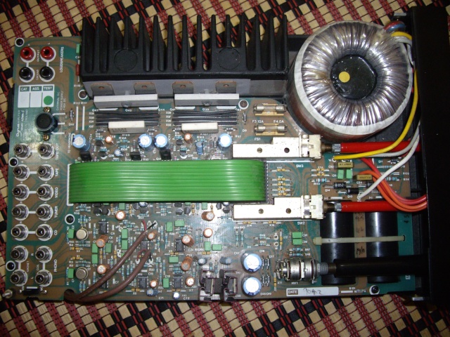

Additional I note a bypass-cap on only one of the both 10mF/63V behind the rectifier (the cap between pos. rail and GND - go to the fourth image).
is there a special reason for that ?

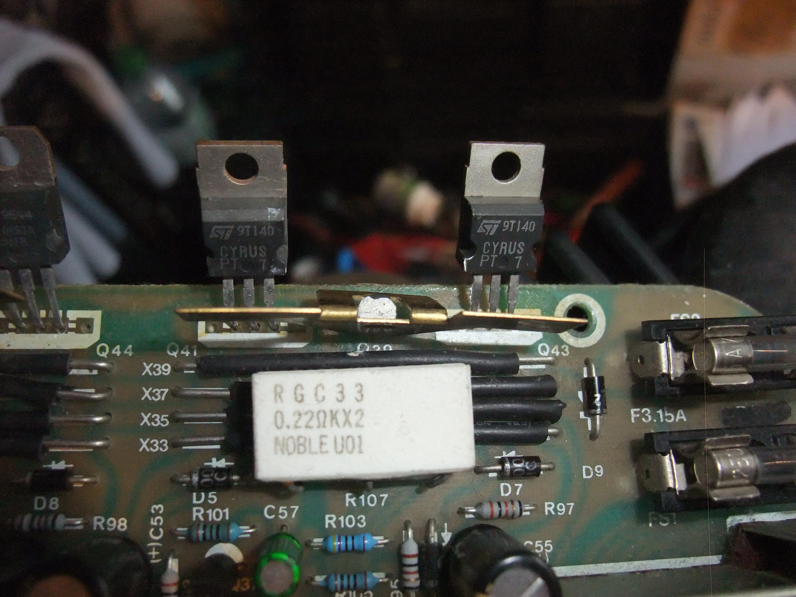

The used output power devices for this quasi complementary output buffer stage are different for L+R - go to the images No 5-8. Which exact type from SGS-Thomson is behind the PT-7 ?
The fast recovery diodes for rectifier PFR852 (last image) - go to

The PT7 are supposed to be BUV28/BUV28A fast switching devices.
If you fit standard audio transistors the amp tends to sound dull and lifeless to me. I had a cyrus one with PT7 in one channel, and some generic linear parts in the other, the linear parts sounded rubbish. I have found parts like FJP13009 work better as replacements.

According datasheet the BUV28 is suited for SMPS e. g. (fast switching character) but actually not suited for linear applications - go to
https://www.st.com/resource/en/datasheet/buv28.pdf
The main feature in the datasheet is the absence of a SOA diagram.
So the question arises, what about the reliability of the power amp units.

The Misson Cyrus amplifier designs 1,2 both used switching power transistors in quasi-complementary arrangement, as did other UK brands of the era, such as early Naim models, before the advent of Japanese developed, multi-emitter transistors which were both fast and more linear. Cyrus 3 used intermediate audio power transistors 2SD1047/B817 as per Rotel.
The speed of switching was always considered important for reducing crossover distortion, which many would say is worse than asymmetric, such as quasi complementary output stages which tend to generate even rather than odd harmonic distortion. Often, that type of distortion sounds pleasing to listeners but crossover distortion is never good.
