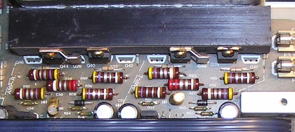

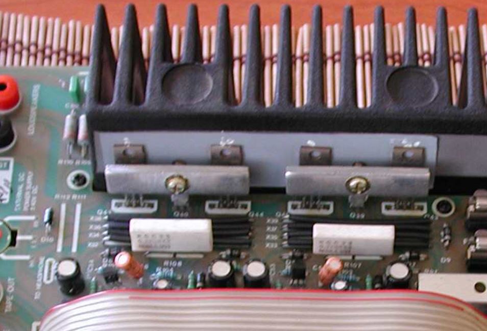

there was just thin thermal tape , that clearly has no integrity. farnell in preston didn't have thin thermal adhesive tape on a roll so i got 'akasa thermal double sided adhesive tape' as an 80x80mm sheet ''micro-fibreglass reinforced" "ideal for heatsinksThe middle leg and also the metal tab of the transistor is the collector. That should be isolated from the heatsink via a mica or silicon washer and also a plastic bush through the centre hole.
So which transistor and which leg reads dead short to the heatsink ?
got a handful of mje3055t's and new drivers for the other channel (out of stock the other day) so that's good. and will check for shorts before throwing the lever this timethere was just thin thermal tape , that clearly has no integrity. farnell in preston didn't have thin thermal adhesive tape on a roll so i got 'akasa thermal double sided adhesive tape' as an 80x80mm sheet ''micro-fibreglass reinforced" "ideal for heatsinks
clamp with an aluminium thingy that connects/glues to a ? thermistor between the outputs.Just looking for pictures. Are your like this (first picture) and held with a clamp rather than each transistor screwed individually to the heatsink ?
I've removed the old tape and fitted fresh . reassembling now with fresh drivers , outputs and fuses and fingers xd !I prefer that method tbh.
Don't overtighten the clamp, tight but not that tight the transistors start cutting into the material behind.
Also, when you loosen the clamp and move the transistors forward, the short (if caused by this material) should disappear.
The 'thermistor' that was glued to the clamp (which will be Q39 ? the one the bias preset connects to) is used for thermal feedback and it is important it is in thermal contact with the metal. It needs to be a reliable fixing method that will stay put and not crack off.
Worry about the finer points of that when it is all basically working.
