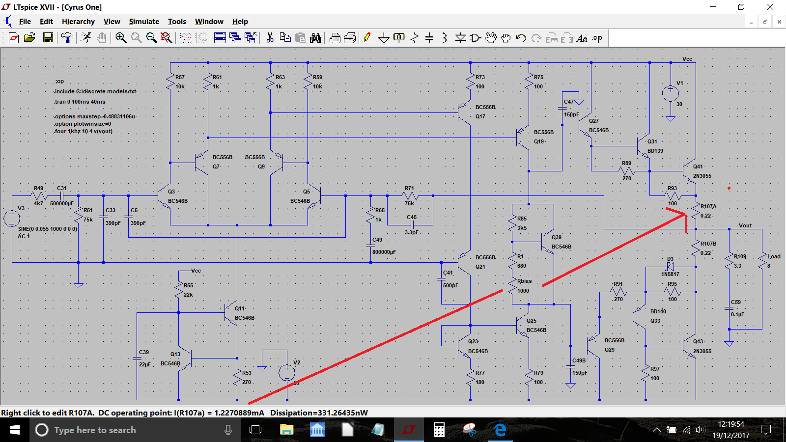

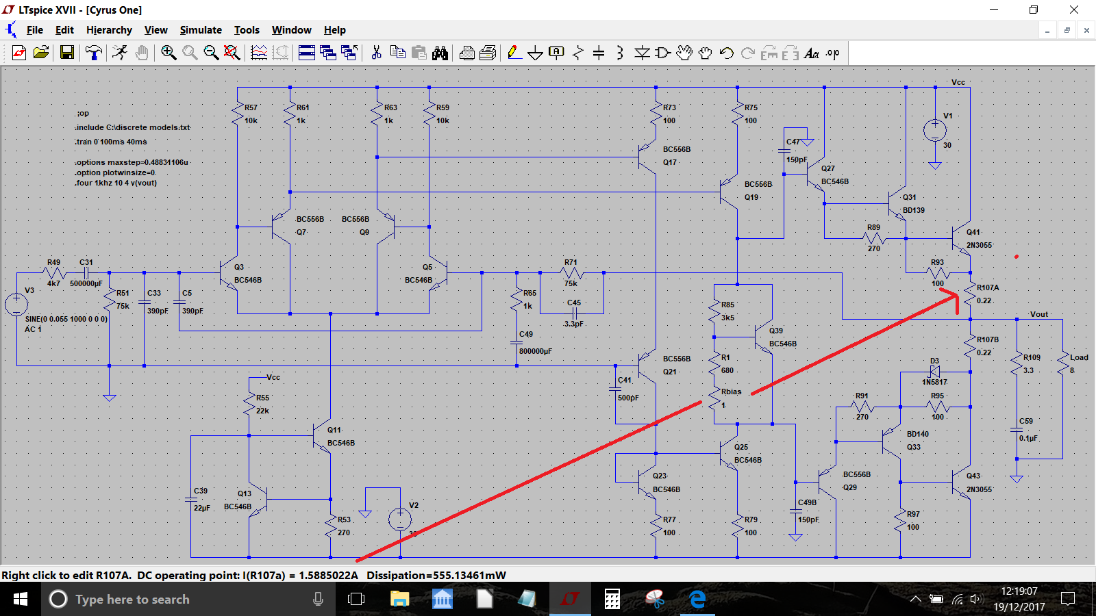

Try a search on Maplin for Potentiometer 2k5. They list two. You can search store stock for either.
5k could make the setting very critical with a tiny movement causing a large change in current. If you do fit a 5k then just set it to 5k initially. That would give a zero bias state.
A 1k would work but it would need one of the series resistors changing to say 680 ohm and leaving it in place. That would give a 680 to 1680 adjustable resistor which should be in the right range. Its more trial and error though. The preset would be set to 1k initially which (hopefully) would be at a point that would give zero bias.
Administrator
Joined 2007
This shows the two scenarios with the pot (a 1k) at minimum and maximum resistance.

This is what I would do:
1/ Remove the drivers, the outputs and the two 0.22 ohm resistors.
2/ The 100 ohm and 270 ohm fusibles wrapped around the drivers should now be checkable reliably in circuit, however the 100 ohm with a diode across it may give misleading results. If it does then just reverse the meter probes (to reverse the polarity of the meters own test voltage) and recheck. The remaining fusibles can be checked as well. Only if you can not get the correct reading having tried with the probes both each way should you remove one end of the resistor to check.
3/ While in this state do a quick check in circuit of the two 'pre drivers' that connect directly to the MJE243/244's. Just make sure they don't read low resistance or short between C and E. Red meter lead to C for the upper NPN and black lead to C for the lower PNP. Using the 'diode' range on your meter should give an open circuit result.
3/ Refit the new drivers, BD139 for the upper NPN and BD140 for the lower PNP.
4/ Refit the new outputs and ensure the tab of each (Collector) is correctly isolated from the heatsink. Use fresh thermal grease.
5/ Remove the two series bias setting resistors leaving just the 3k5 present between C and B.
At this point the amp could be tested with a bulb limiter. The bulb should be out, or at least dim. All the rails should be fairly near to normal and the DC voltage present at the amplifier output should be close to zero volts.
If that was OK then the bias preset can be fitted.
If the amp is difficult to work on then the preset can be fitted first. You are using two leads, the middle and either one of the end pins. When you have decided which pins, check the resistance between your chosen pins on the meter and make sure it reads the full 2k (2k2) of the preset by turning the control in the appropriate direction as needed. It MUST be at this initial value when fitted in place of those two resistors.
