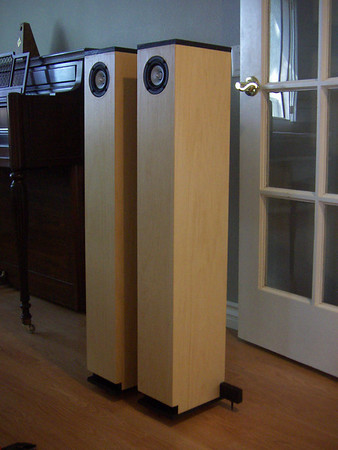

just gorgeous, nice cabinet, how does it sound?, did u put in filter?
It's such a huge improvement over my old speakers that I've been playing music almost non-stop since I got them functional. I haven't installed the notch filter yet - waiting for yet another PartsExpress order to arrive tomorrow. In the interim I'm using the convolver plugin when I'm sourcing from Foobar 2000, but I find it flattens them out a bit too much for my room. Once my notch parts arrive I'll wire it up and see how it sounds.
The only "downside" to this is that I'm beginning to suspect that my old Onkyo TX904 receiver is the weak link now - maybe a gainclone or 41 Hz AMP10 is in my future...
The side panels are 1/2" beyond the box side. I designed them that way because my wife was insisting that I add grills with speaker cloth and I figured I could pressure fit them into place after the fact.
Of course, once I brought the finished speakers up from the basement she decided that they looked fine as is! The sides are glued on so removal for trimming isn't going to happen anytime soon.
I am certainly a complete novice at this, I freely admit. I'd appreciate any information that will help me learn. I had figured that, since the cones are primarily providing the high frequencies which are more narrowly dispersed in comparison to the lower frequencies from the port, having 162 degrees instead of 180 might not make all that much difference.

bobtrancho said:The side panels are 1/2" beyond the box side. I designed them that way because my wife was insisting that I add grills with speaker cloth and I figured I could pressure fit them into place after the fact.

I think a router and a flush trim bit would probably allow you to trim the sides in place. Obviously a little refinishing would be required
I'll probably take ped's advice and use my flush trim bit to clean off the lip to about 6" down from the top. I like the look of the lip but understand the implications on the sound.
It will be a bit of a Ppain as these are birch ply and I'll have to reapply the edge banding without messing up the finished front and sides, but its possible to do if I'm careful. Since I'll be taking them down to add the notch filter I might as well do it all at once.

I'd appreciate your expert opinion before I take a router to these speakers. You you think the 1/2" projection makes a real difference in the sound? What with listening to them raw, then finished, 30 - 40 hours of break-in, and now with Cyburg's notch filter installed, I think they keep sounding better and better, though I'm still fiddling with placement.

The cabinets look really great!
The protruding edges will probably only result in a little uneven response curve at higher frequencies. It should be similar to what most speakers with a front cover frame will have.
IMO, not a reason for serious concerns.
If however it should keep you awake at night, I might run a measurement to compare - but I will defer this for a rainy day

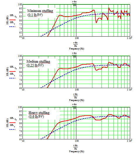

My own experience indicate that too much stuffing kills the sound, but not to little, as this will increase ripple.
Below is a simulation of the effects of stuffing density, in the closed end of the pipe, until behind the driver.
About 25-30 grams (1 oz) per speaker may seem to be about right.
SveinB.
SveinB.
