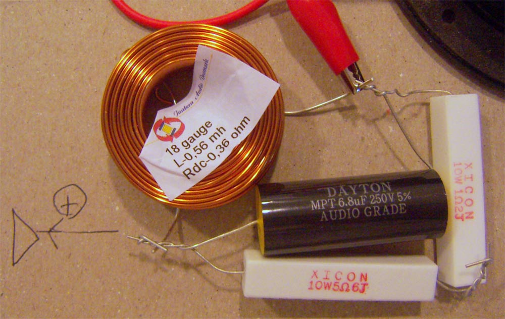

notch filter
getting ready to install the notch filter.
Does the inductor need to be connected in certain way? or like condensor and resistor doesn't matter, all 3 needs to be soldered in parallel I am told.
anyone spot a mistake? (had to connect 2 resistors for right value)
thanks,
gychang

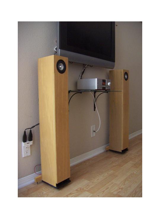

Cyburgs said:
I hope that this could be of interest for you.
Nice greetings, Berndt
Thanks Berndt, I am listening to it right now, nothing short of amazing for the speaker of this size, love the styling. After few minutes the sound stabilizes, can vouch for the excellence in sound and looks. Installed the recommended notch filter. My friends are requesting their "speaker"... May have to build 2 more...
gychang

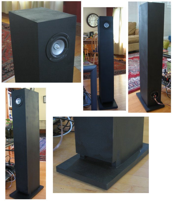

Treatment for the TB 871
Well, I thought I'd let you guys know that I've been painting up my needles. And looking at them now, I can confidently say that I'm no cabinetmaker. But if you aren't looking too carefully, they don't call attention to my ineptitude. :) I painted the mdf boxes with 16 oz of wood hardener, then a quick sand and spray painted them with black "fine textured" spraypaint. After the first layer of paint, I decided the endgrain of the MDF required a spot of thinned plaster to come out smooth. That didn't work perfectly, but close enough.

Since I just finished painting up my needles I thought I'd share pics of them, for any interested. :D
You can see that when the light hits them just so irregularities in the finish and texture of the (textured) paint show. Mostly they look fine, however. The textured paint helps hide my oopses. In retrospect I think more coats of the spray paint would have evened out the texture more. I applied 3 coats. It was easier to to see the imperfections after I got them out of my home made spray booth and back into the living room... :xeye:
The wife appreciates that they aren't just bare MDF any more tho. :angel:
