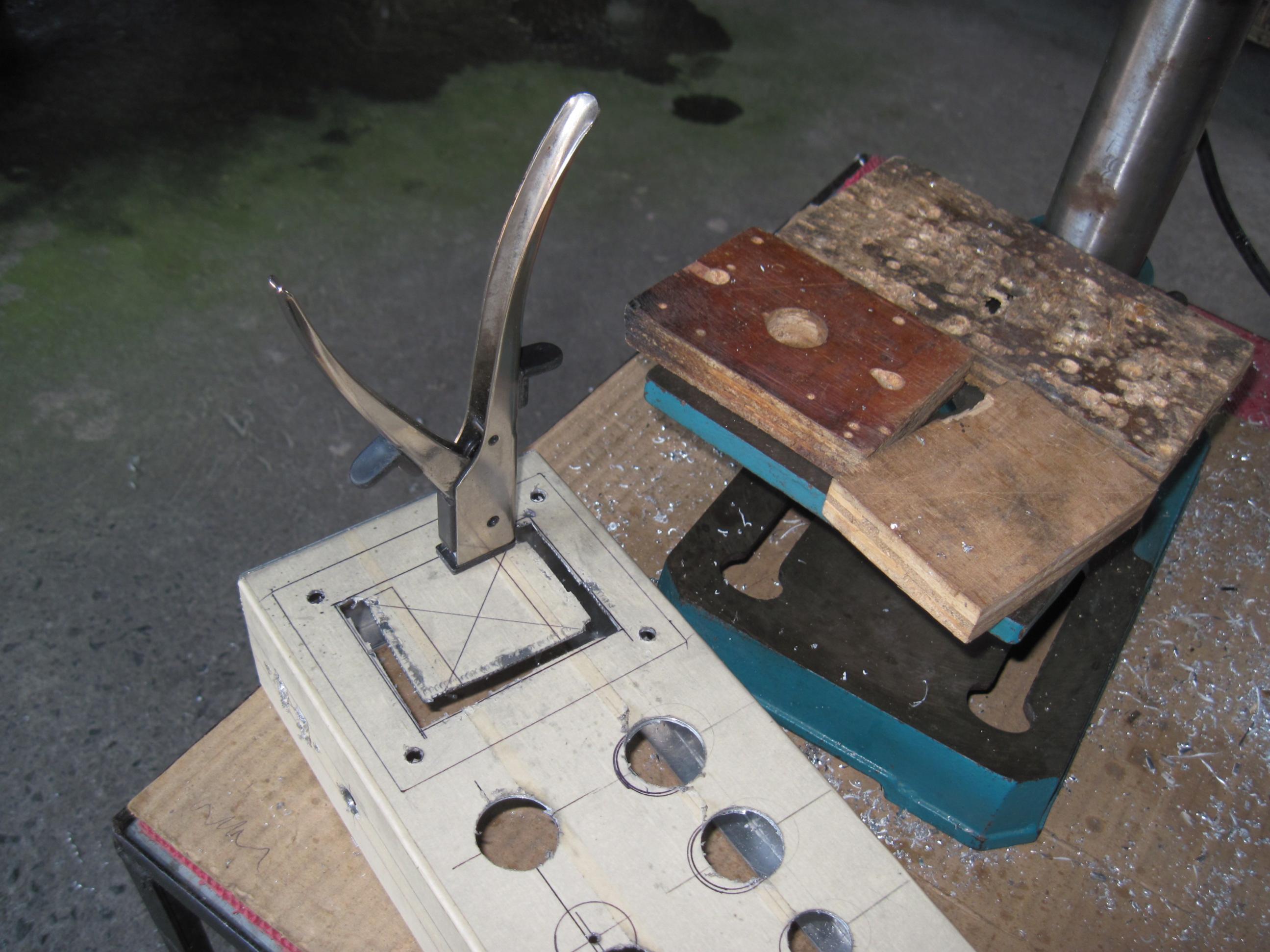

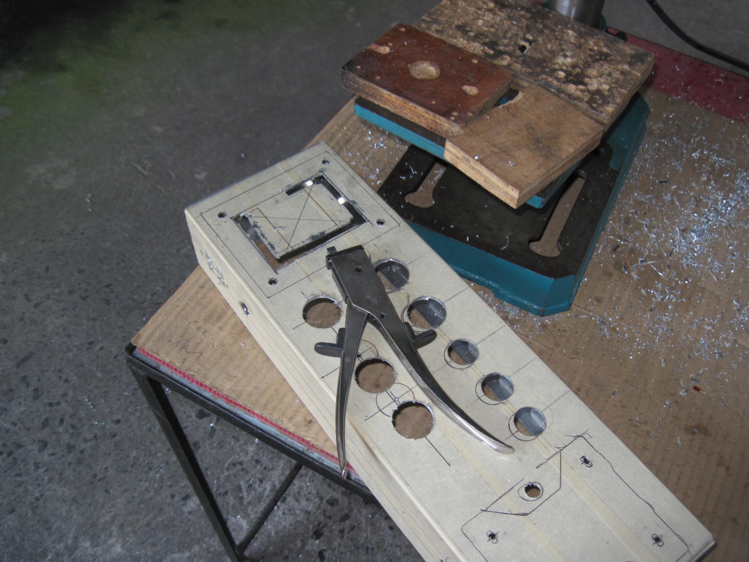

One of my favourite tools for sheet is the Wiss supershear (similar shown here). they're similar to snips or aviation shears but effectively have three blades so cut out a thin strip of material without distorting the sheet at all ...a bit like a hand powered nibbler (in fact I have an Hitchi CN16, but invariably pick up the Wiss for most jobs). They go through 1.2mm (18swg) steel with ease, and should do 1.5mm, or thicker if your cutting aluminium. They're also handy for irregular shapes ...notching corners for trays etc.

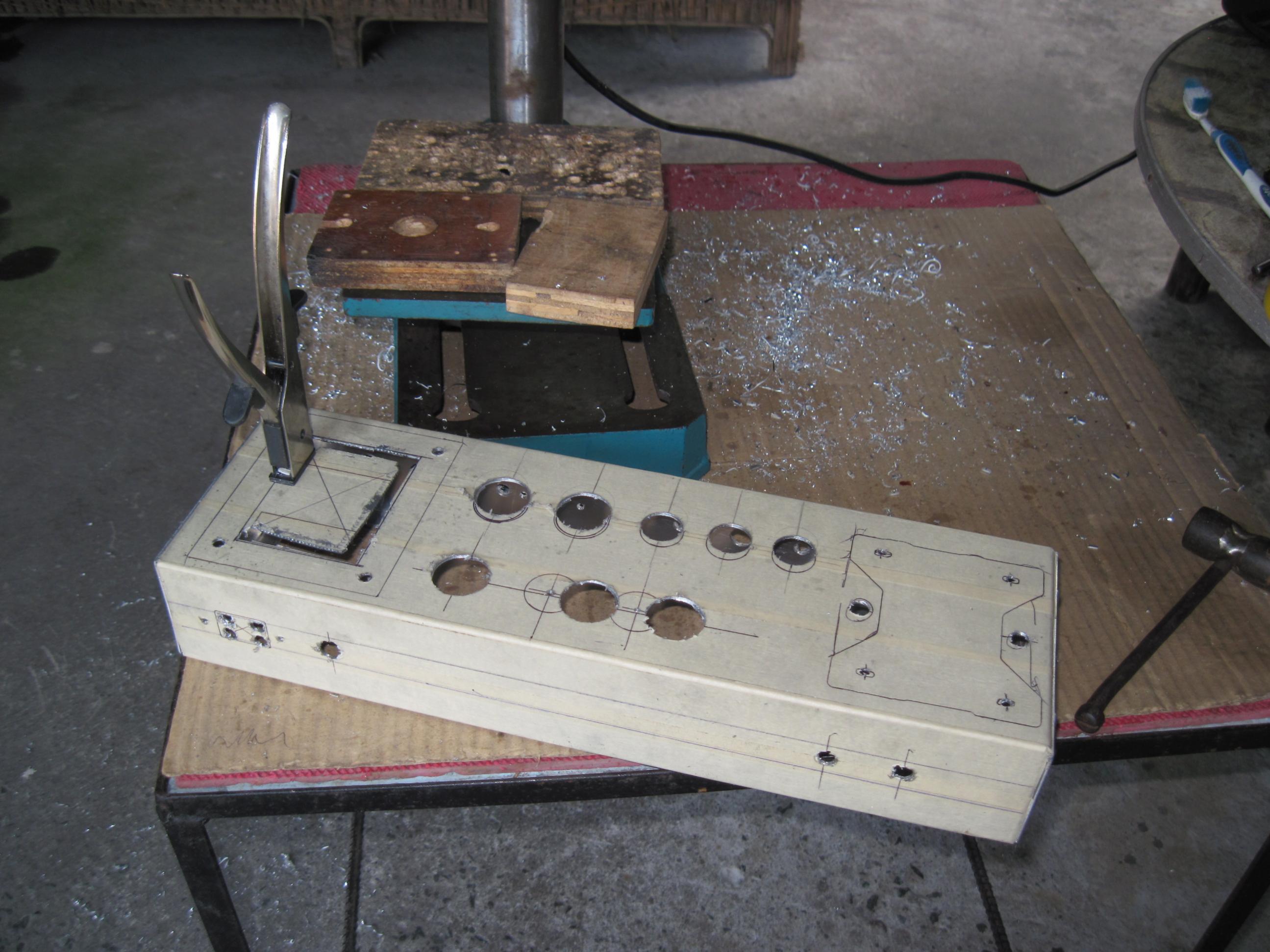

Ok, so the guillotine exercise did not unveil anything new to me. It still warp the steel plate far too much for my liking. Even when only trimming the edge.
Ended up using the battery powered jigsaw. Freehand and very slow. Forget about laser guide as I had to angle the saw some 2-4 degree on the line to make it go somewhat strait.
Then I used the angle grinder with a grind disc to take the cut closer to the line before finishing with a hand file.
6 minute job with the right tool (hydraulic guillotine) to most of the Sunday to finish.
