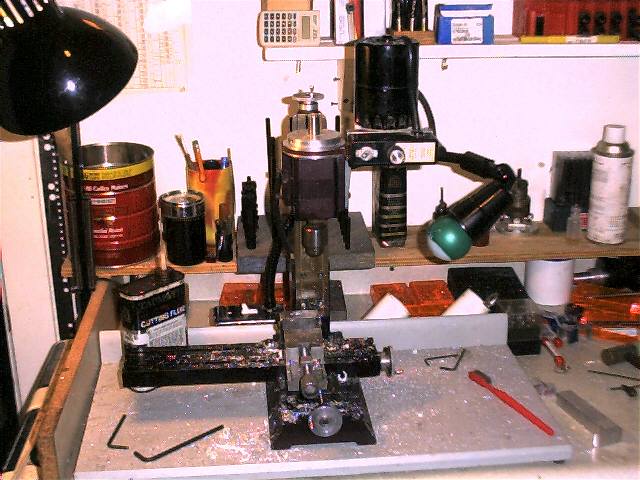

This is my Sherline mill. It is a very highly regarded piece with only one flaw. Workpiece size. The heat sink (above), that is now my first GC, barely fit.
Hence the need for the custom one.
Point of pic? Look at the fixtures I have built. They would serve well even on a drill press, and would cost you very little to duplicate.

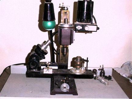

On the left is the head from a camera tripod. The versatility of this piece has to be seen to be believed.
The chuck on the right is simply an old Jacobs (look for 'em, good stuff) from an old heavy (and very dead) hand drill.
Make yourself the chuck fixture... you won't regret it.

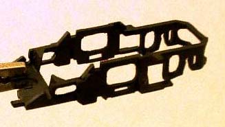

Pic is of HO scale (size of Matchbox cars) slotcar frame lightened as much as possible, in the Sherline.
