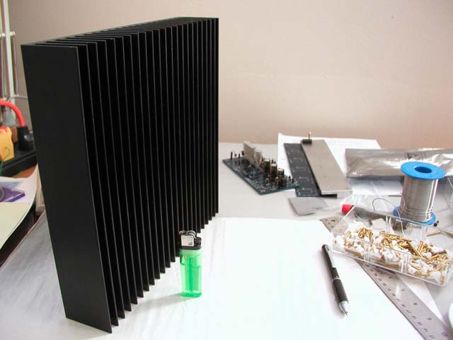

I wouldn't even have the heat sinks on show unless they were pointing downwards; as per the case in this example.
I can't stand having to, every few days, wipe dust off expensive electrical things to keep them looking neat.
Heat sink fins are the ideal place for dust / muck / hair / bits of pizza / biscuit crumbs and crisps to gunk up, especially if you have kids I imagine.

My version of pointing downwards was like the ones attached in the picture, so any muck hitting them would just run down the fins and onto whatever the amp was sitting on, rather than into the base of the fins.
